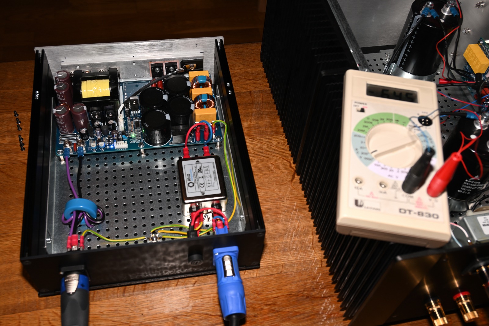

GND in amp case which is + on the 22 mF filter cap in the LC filter is connected to chassis via the usual 10 ohm NTC.
The power cable from PSU chassis will have the yellow/green wire which is also connected to the PSU chassis.
Will see where I can find some shielded power cable. Then connect yellow/green wire to shield at amp end........then I need to mark which connector should go to amp. Connectors are 4 pole Neutrik SpeakOn.
Ok, I could let the 4th terminal in SpeakOn connector be the shield and then connect it in amp case.
To get access to the 4th terminal in chassis mount SpeakOn connector (which is the bottom one terminal) needs a bit of disconnects of wires 🙂 ......but it is doable of course.....in stead of making the connection in cable connector (shield to yellow/green).

Yes, amp case is connected to safety gnd via the DC power cable where safety gnd is one of the wires. This wire is connected via AC mains yellow/green in PSU case.

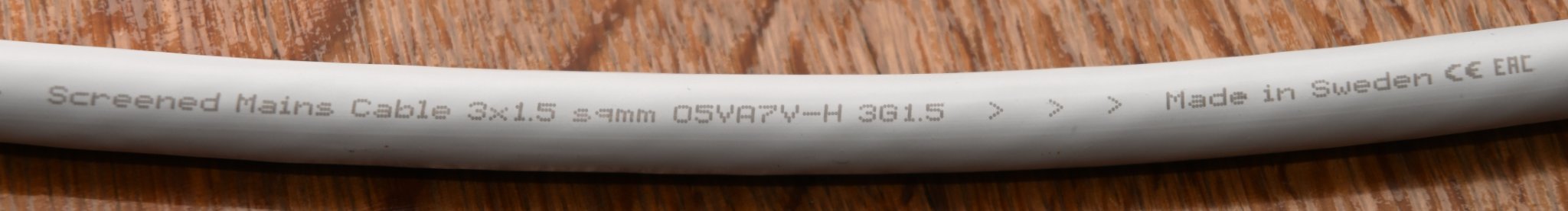

I ordered 2 x 1m of this cable: SUPRA LoRad MKII 3x1.5 mm² to be used as DC power cable.

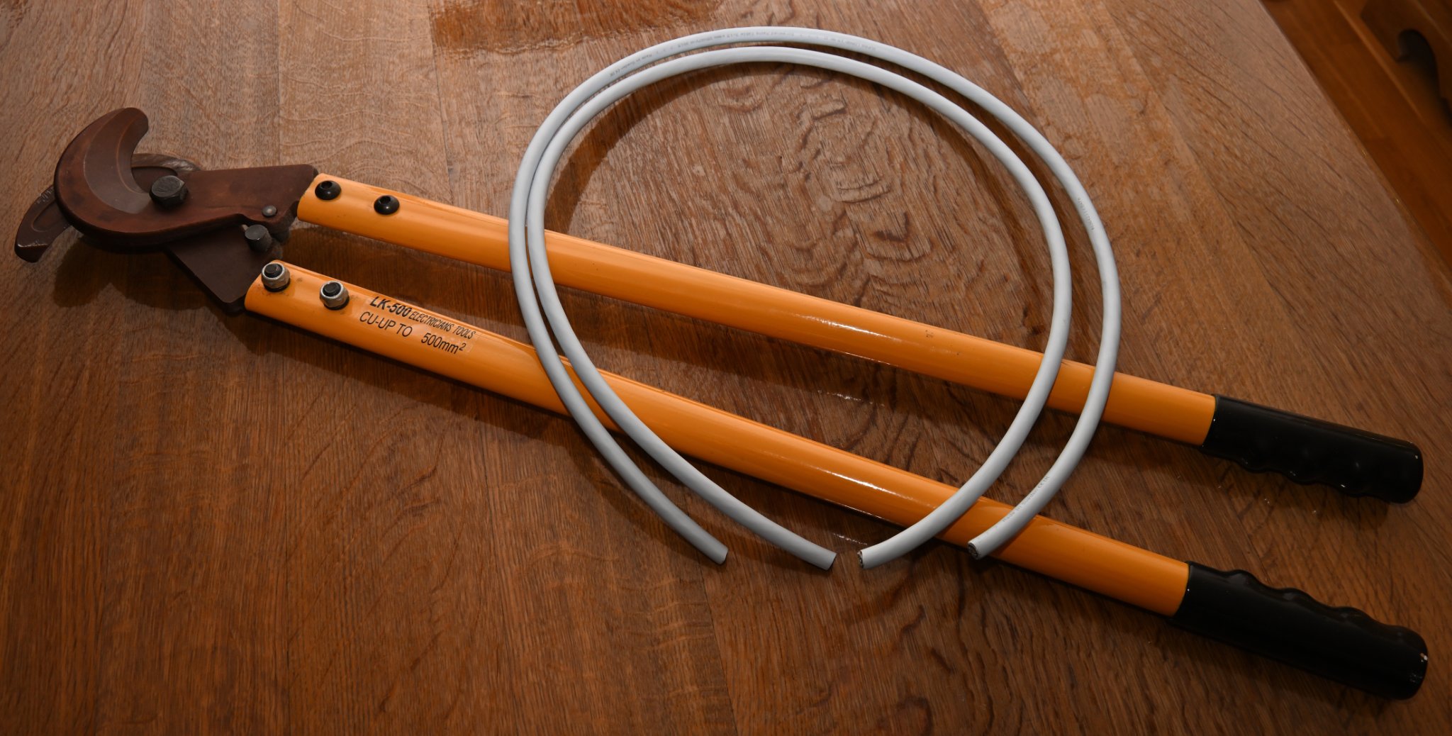

2m screened cable arrived which I cut into two pieces (I need two DC-cables). It was so fun to cut. Difficult not to continue to cut into smaller pieces. It was "like butter" with my cable cutter. Plan to mount Neutrik connectors during the weekend......
I wonder if the arrows printed on cable indicates a "direction"? ......crazy world if that is true......

Some final adjustments with external SMPS PSU and LC filter in amp case.

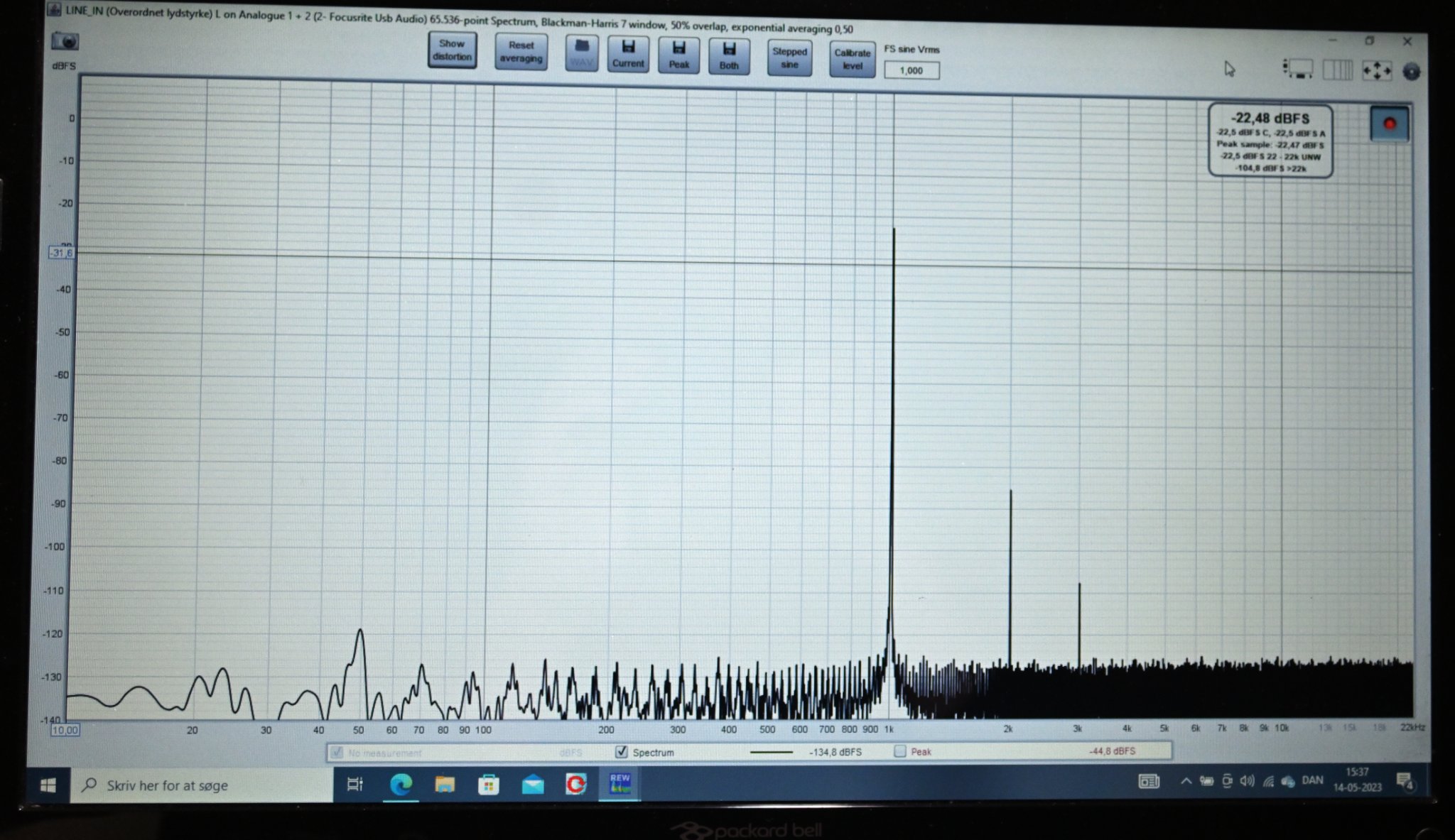

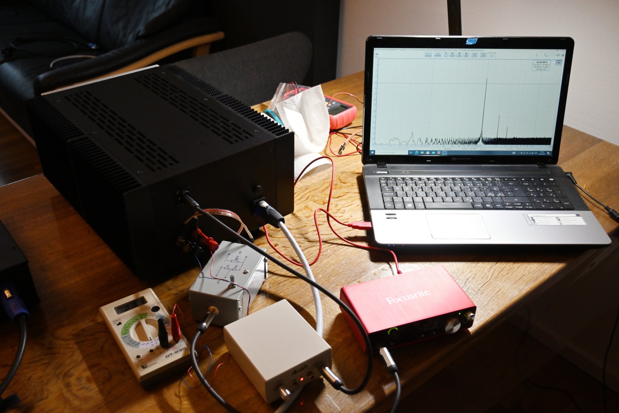

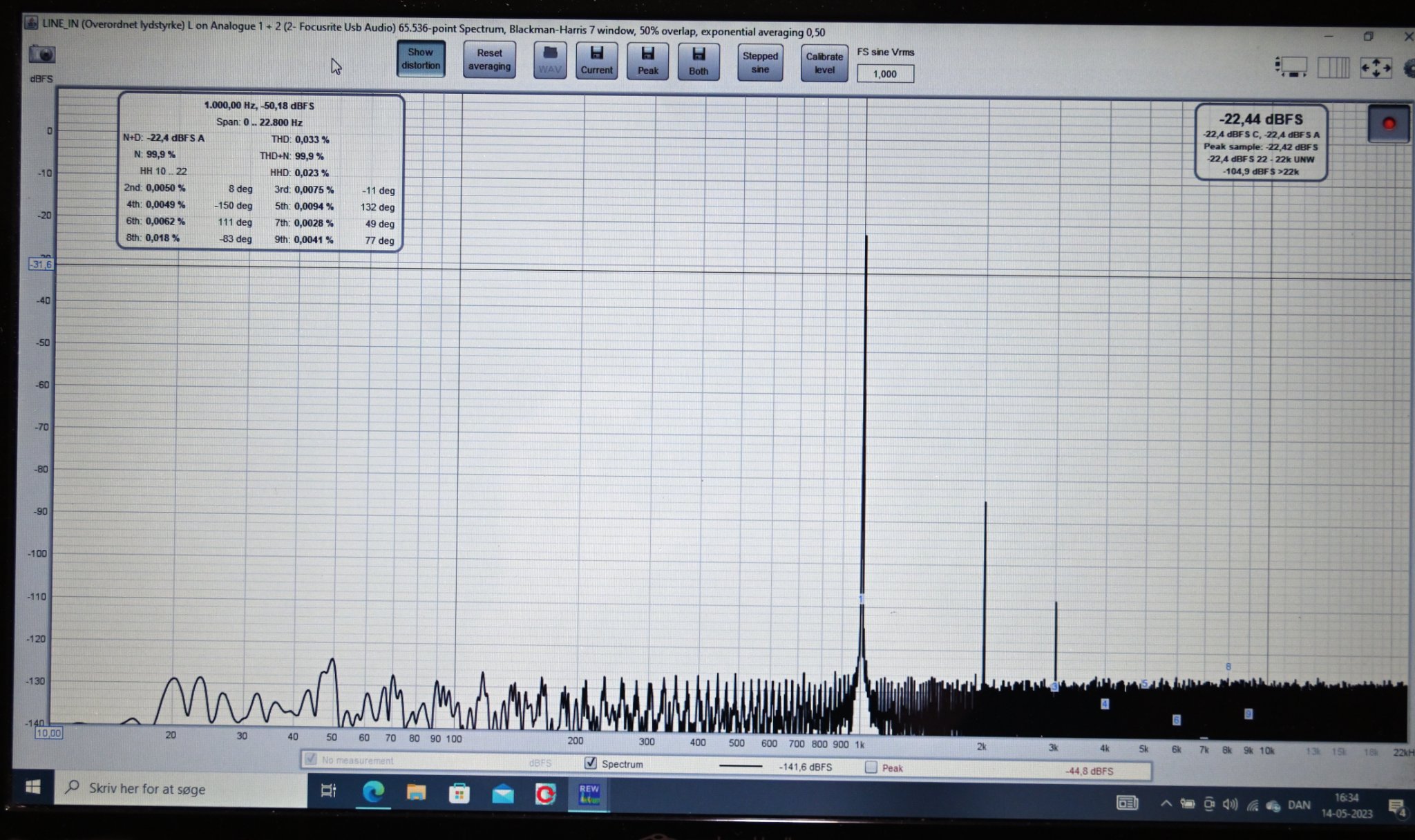

After closed cover I made a quick REW measurement on one channel to check how it looks.
My measurement setup is not that good for power amp measurement especially not when amp has no voltage gain. So it was just to check that I had no bigger problem. I use a small Atika 1000 Hz generator. With this I could get 2.31 V RMS over 6R8 resistor. It is about 0.8 W out.

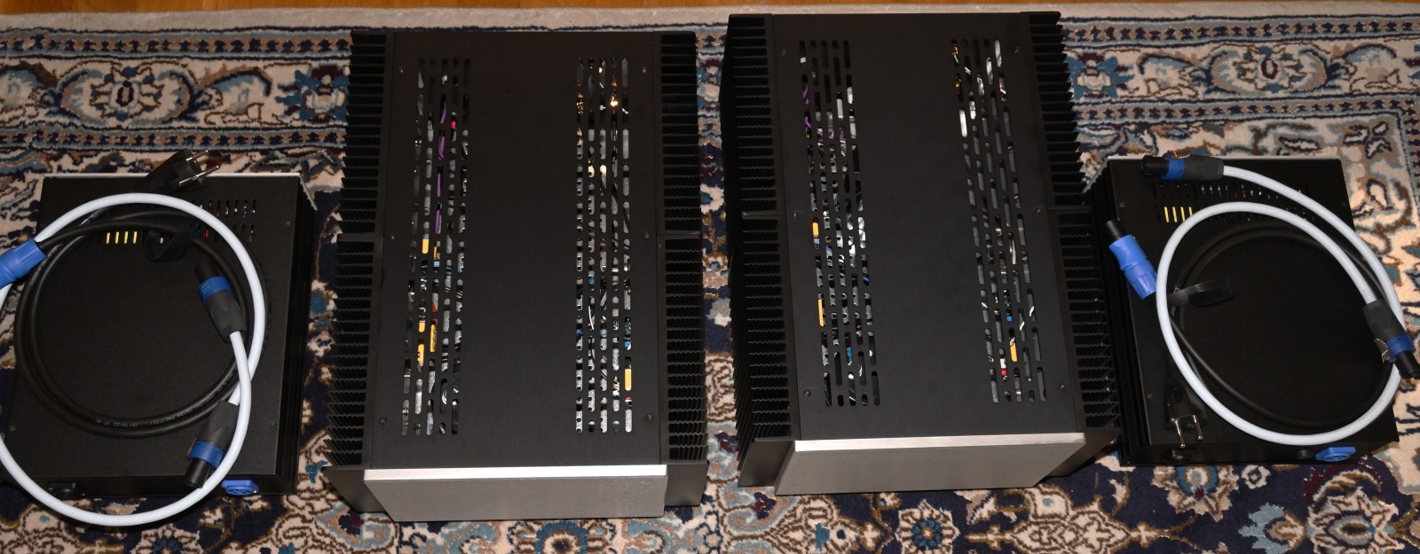

If other channel shows same behavior I will start thinking how to reorganize my system (two mono blocks + two PSU boxes) with all the connecting wires etc.
As far as I can see I can expect a silent setup.

Other channel looks about similar........
Something goes wrong with noise measurement when an external generator is used (I opened the distortion measurement window for this channel).

Yes, I don't know why it shows 100% noise figures in the box. I switched from internal to external generator (to have larger signal). Maybe REW still "think" the internal generator is running and measures on that (in the window). Normally when no signal the noise is like 100%.
I am quite sure the graph is correct. The speakers are totally "dead" regarding noise / hum.

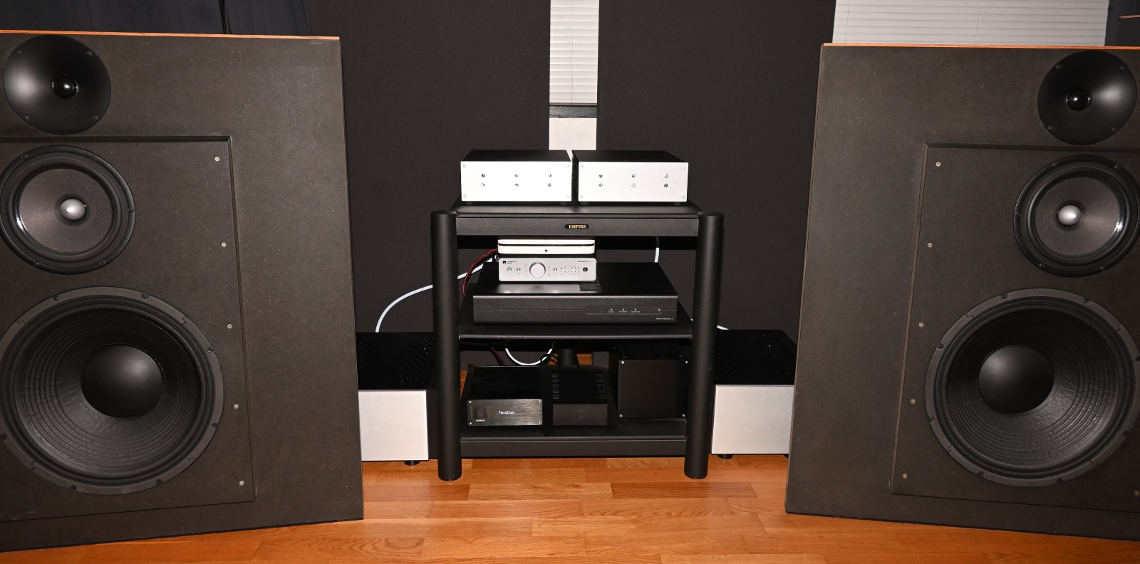

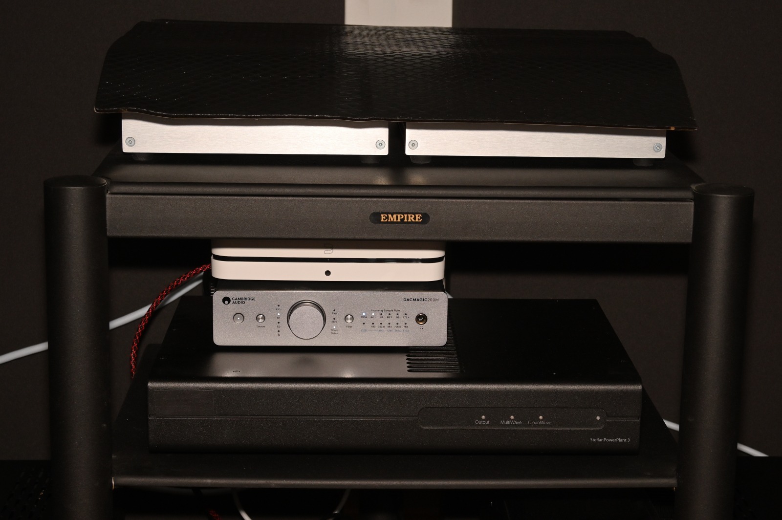

On 2nd image I put a bitumen sheet over the two SMPS cases to check if this could solve the faint mechanical buzz from the SMPS transformers and also to check how hot its get when ventilation holes on top is covered. It seems like a fine solution. So next project will be to dampen the chassis with bitumen inside.
Later the SMPS cases will go on middel shelf (on top of the PS-Audio regenerator) and streamer + DAC + "future" Iron Pre will go on the top.

It gets quite hot in the living room with the extra 400W of heat. Maybe Lazy Bush as Winter-amp and VFET as Summer-amp 🙂
VFET kit amp is running cool compared to these "Lazy" mono blocks! .....I can keep my fingers 2 sec where it is hottest after 2-3 hours of burning. I think this is ok. +5 C during the summer will probably be OK also. I will do a measurement during a hot summer day.
