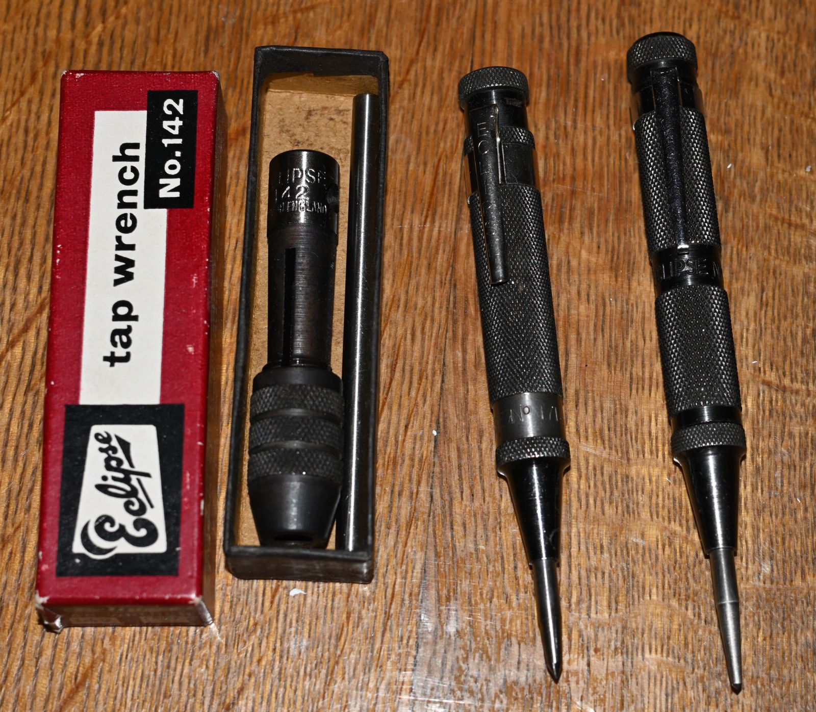

I can see you are from GB. From my father I have some vintage Eclipse tools. E.g. like these:
Eclipse from Sheffield.
Think everything will succeed with Eclipse!
This type of tap wrench often gives a bit more control (e.g to get the 1st tap (taper) to "bite").
I think the tool brand Eclipse still exists.
The tools above could be 50 years old.

Yes, those small tap wrenches allow for good 'feel'. The automatic centre punches are nice. Re the flat bottom drill, the hole is mostly made so it's just clearing out the point angle from the drill to get half or one more pitch of thread in the hole. Your father and you clearly know good engineering. We just grind it carefully by hand on a pedestal grinder. It will self center in the existing hole.These flat bottom drills are more like a router bit?

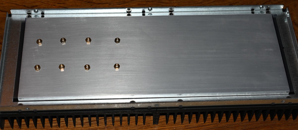

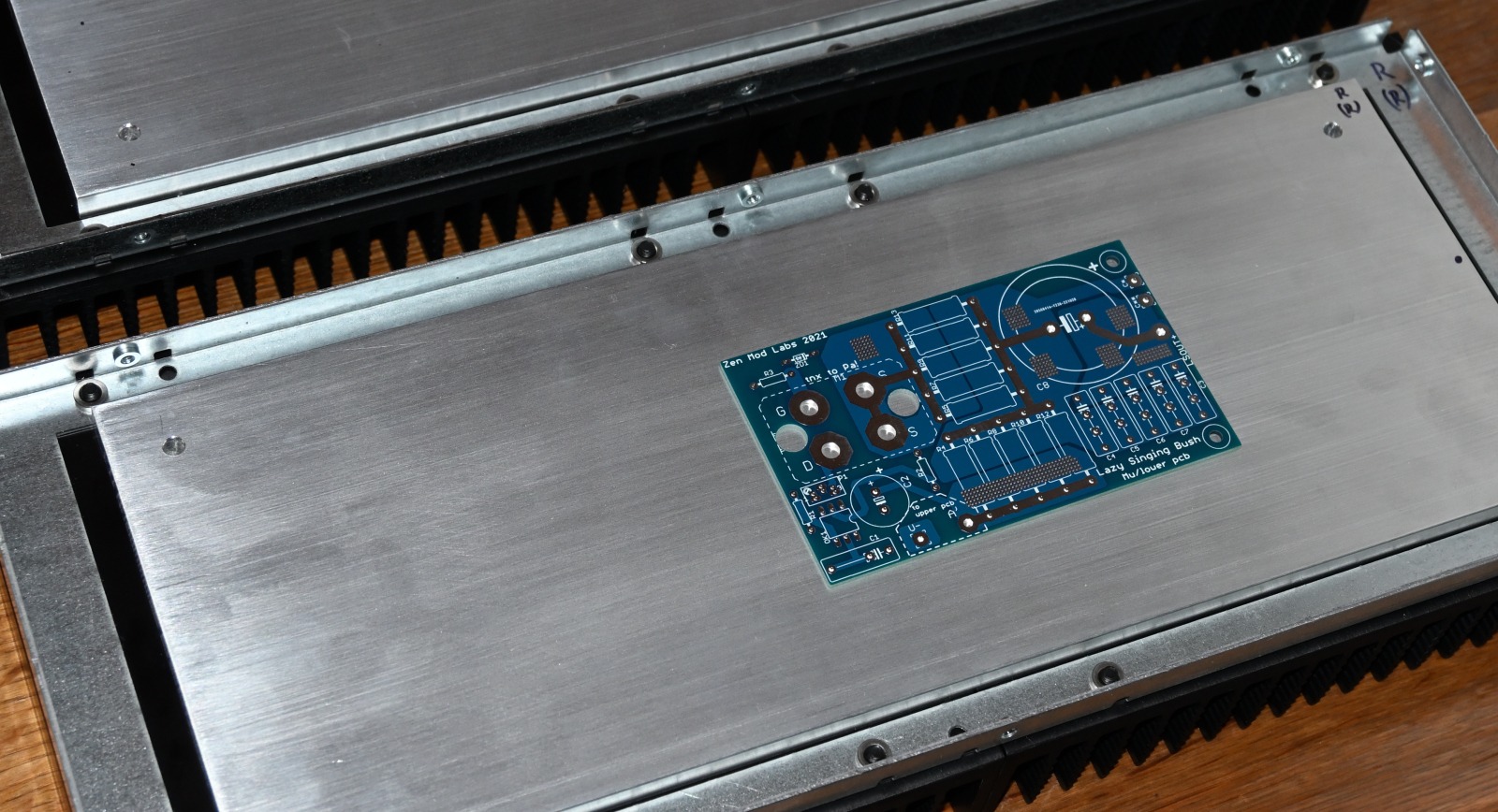

I have worked on my alu panels, and they are now fine and even. I have also cut a transparent acetat foil to mark the holes on so it can be used as a template to transfer markings for the holes on heatsinks and panels.

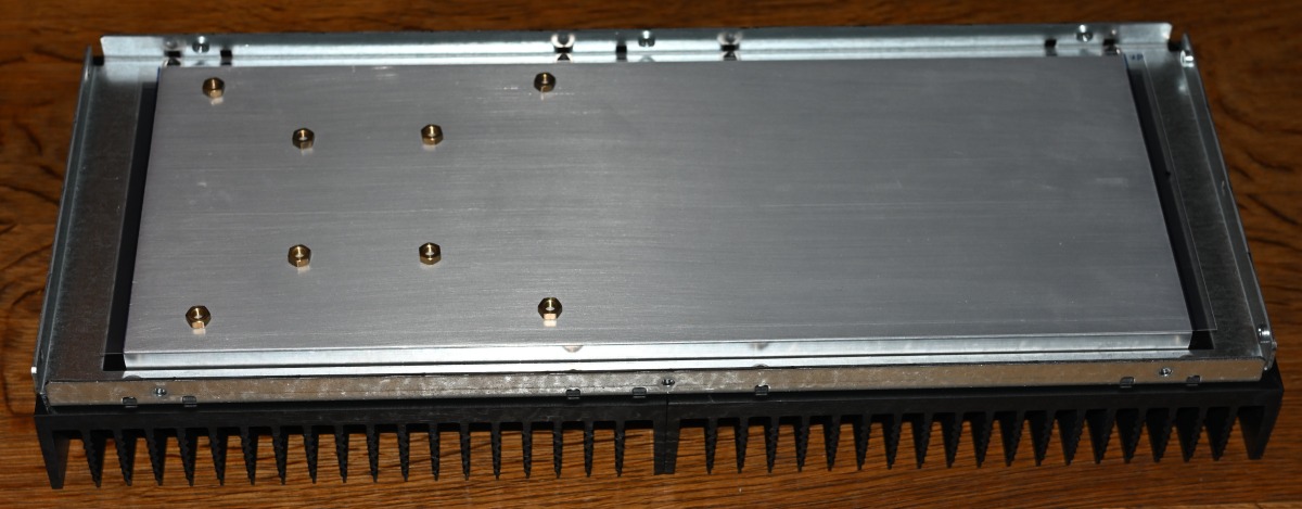

I have placed some nuts by eye to show where holes could be placed to secure the panels to the heatsinks.
I prefer the outer placement of the holes so it will not interfere with PCB and components. It will also look better. But the inner placement will probably be more technical correct to ensure best contact between panels and heatsinks. I will use heat paste so it should be ok with outer placement.

MEPER, Make sure the screws that you use to secure the Mosfet and SIT to the heatsink go through the aluminum panel into the heatsink. That will apply pressure and provide good contact for thermal transfer to the heatsink. As for other screws, placement for function (thermal transfer) should be prioritized over placement for looks. 🙂
And as Zen Mod has advised many times before and I concur, locate the screws between fins so that you can drill and tap through and use longer screws, to minimize the chances of broken taps and stripped threads in the soft aluminum.

The screw placement below would be about the best placement to secure the panels ("1/3 split")? (just placed "by eye")
Then I think it is best to wait for the PCBs so I can ensure that the screws will not interfere with PCB screws ect.
Do we know the aluminium quality of the heatsinks?
Could it be:
Aluminium like this has a hardness close to normal steel and used by e.g., Shimano for their Dura Ace series. E.g., chains wheels are aluminium.
I will consider again making panel holes all the way through.,,,,,,,

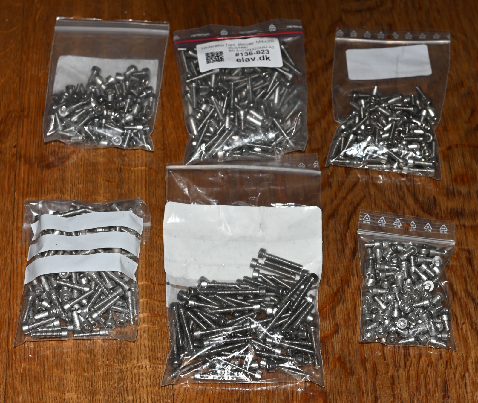

A very minor update.
M4 hex-screws in various lengths which should cover all need for the amp arrived (also for the panel holes all the way through the heatsinks).
So that decision has been taken. I have made a couple of templates for marking holes.

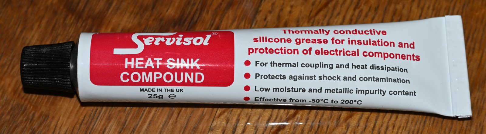

Heatsink compound has also "landed".
Nice custom SMPS PSUs is on the way also.
So far so good.........hope they produce good compound in the UK......

I plan to drill holes in the "far" corners of the panels and corresponding M4 threads in heatsinks. This just to hold the panels in place which makes a lot of "things" easier. Marking the holes at panels after drilling "through holes" in heatsinks, final assembly after applying compound etc.

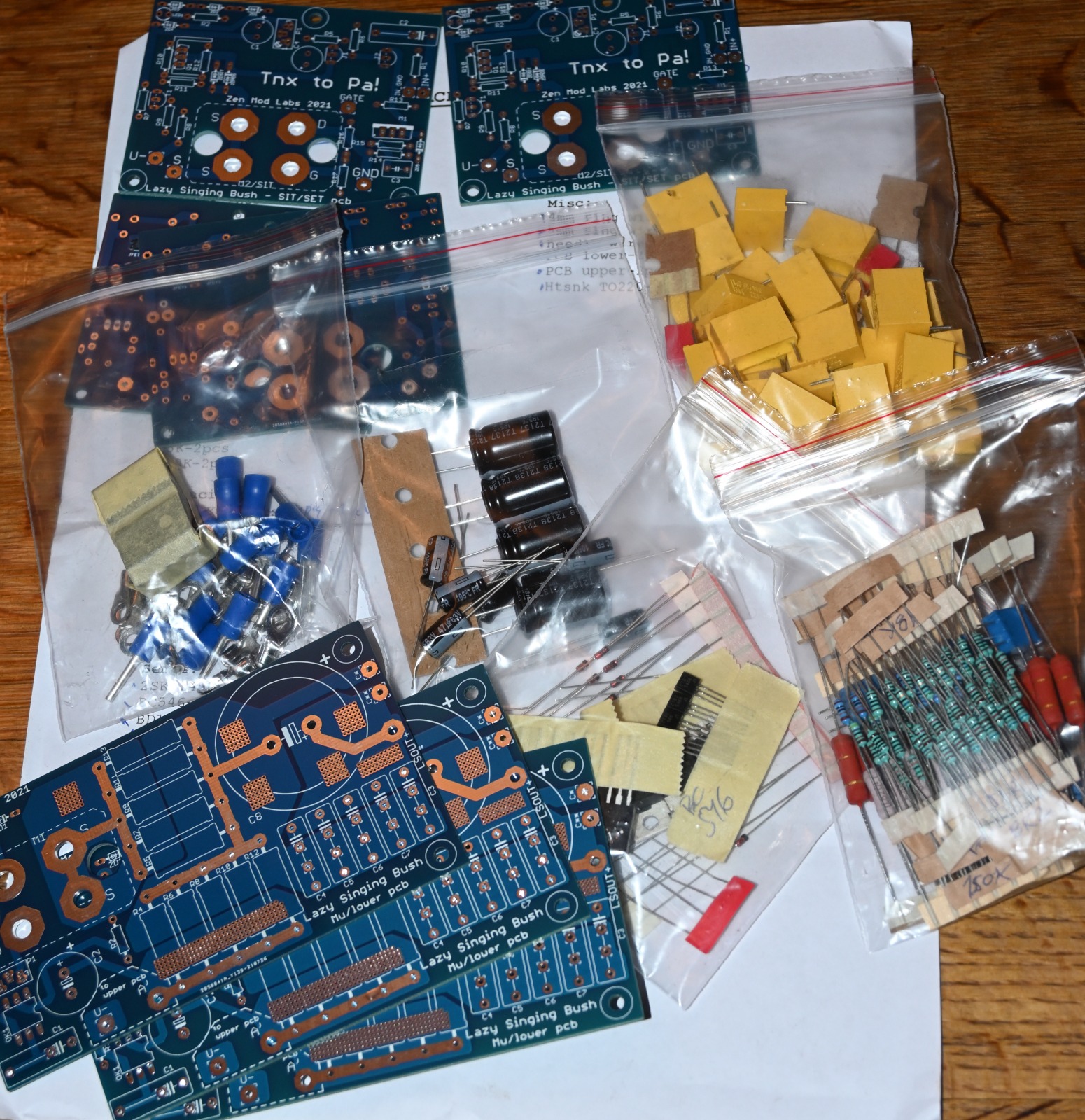

Now the PCBs arrived from "ZM-Labs" with pre-mounted SMD's and most of the components to be installed.
In meantime I did a little mechanical work by drilling mounting holes in each corner of the heat spreader panels. Corresponding M4 threads has been made in the heatsinks. This is only for holding the panels into place which does making the "through holes" easier and also the final assembly. When the panels gets heat paste etc. it will be much easier to do final assembly according to my "prediction". The panels have a quite tight fit into the frames (top and bottom) so they must sit quite precise.
Will drill the "through holes" with panels mounted to get the holes to "line up" as exact as possible.

Next step will be to mark the holes between the fins of the heatsinks. Six holes in each heatsink.
My plan is to mark the holes on "fin-side" and then drill all the way though heatsink and panel. This way I can better ensure holes are exact center between fins. I have drill-bits long enough so fins will not "interfere" with machine. Maybe I just make a "pilot hole" like 2.5mm or so from fin-side and then make the final 4.5mm hole from panel-side.
