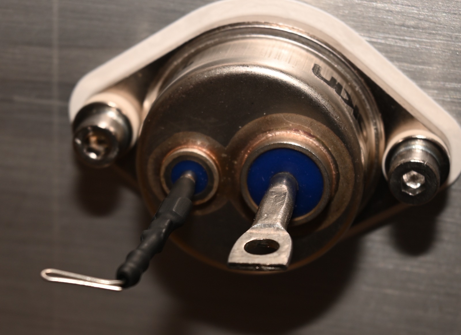

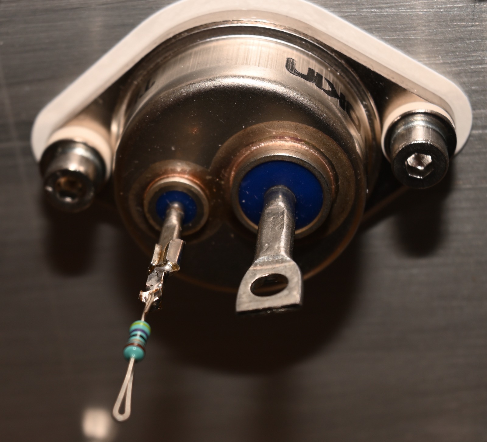

I see........I soldered in R16 on PCB. That was an error I assume. I guess I can let it "SIT" (it will not harm anything?) and then just use another resistor directly on SIT gate?
The gate PIN on SIT has a kind of solder connector attached. I just solder resistor to that? ........heatshrinked.....do you mean using flex isolator that shrinks with heat?
leave that resistor on pcb, no harm
yes, gate stopper directly soldered to G pin of SIT (however factory made it, live with it)
then use "flex isolator that shrinks 50% with heat", fully containing G pin, resistor and then some of wire
that way you're increasing mechanical durability of said concoction
The SIT-gate resistor operation ended up something like this. Think it will be ok.......it feels mechanical stable. Then with a thin flexible wire it should work.

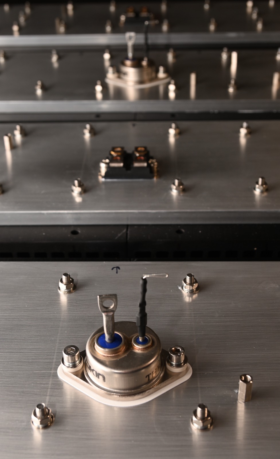

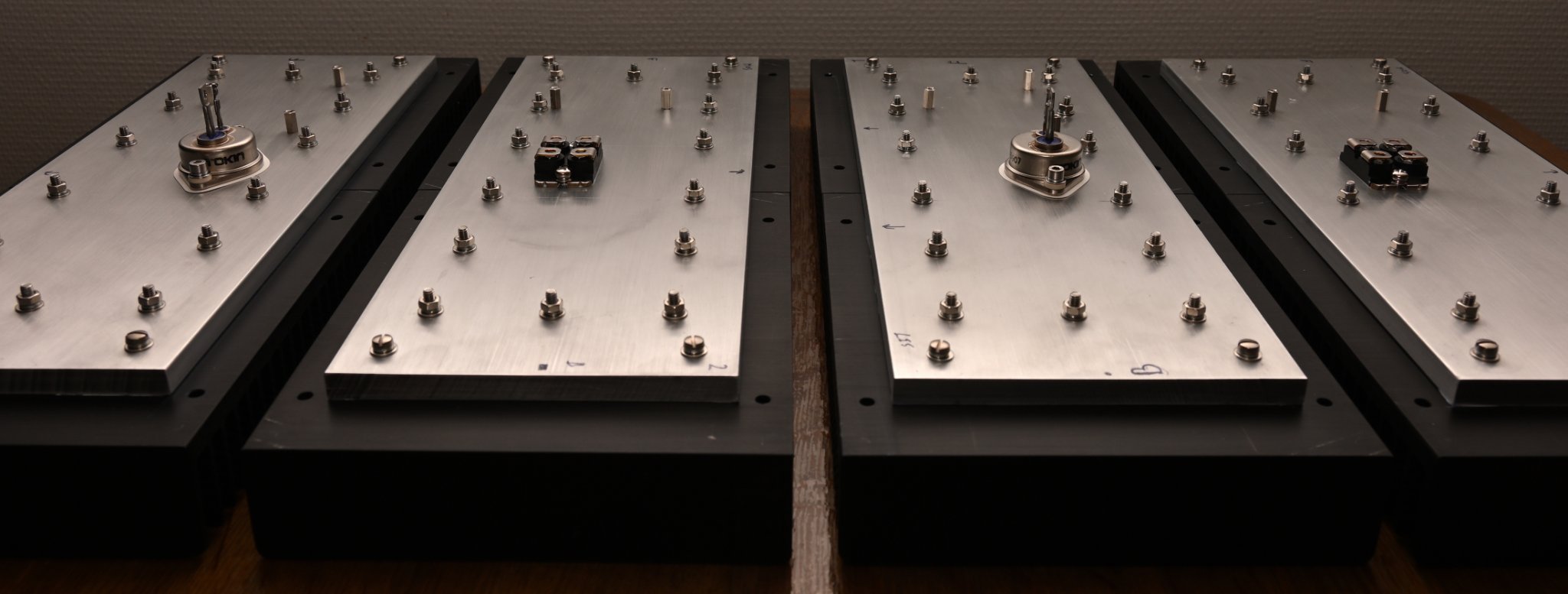

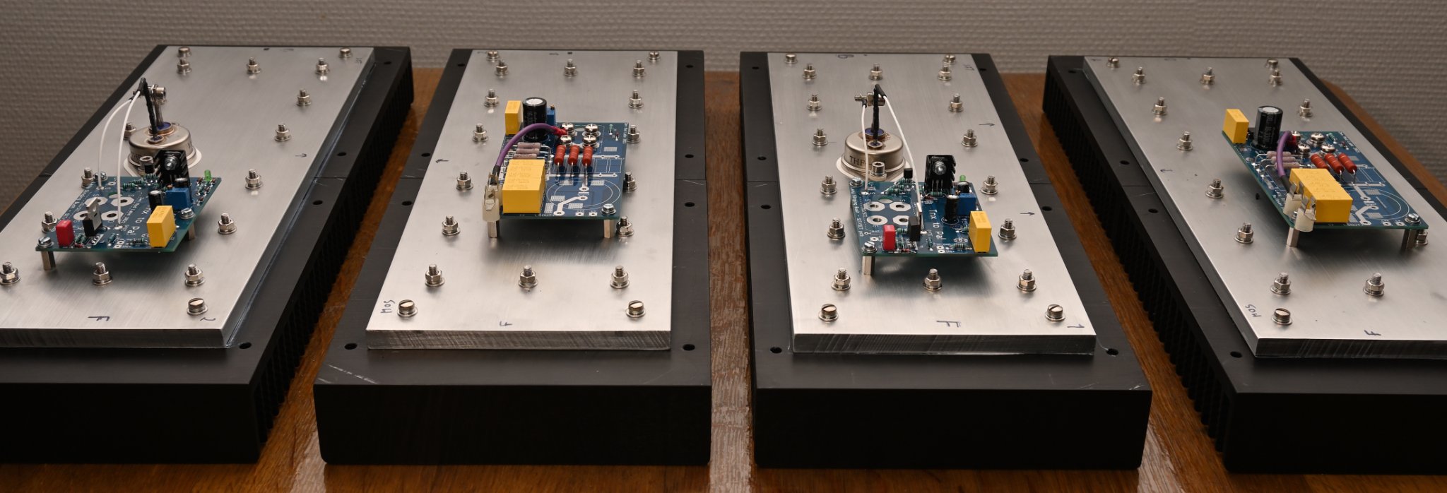

A little further progress. Think I soon can mount the heatsink panels to the chassis.
I need to work a bit more on SIT source and drain. Source needs a long thick wire to go to the other PCB at the other side. Drains needs three wires as far as I can see. A thin to GND at SIT PCB and then two thick wires. One for PSU GND and another for Speaker return. Good to prepare as much as possible before panels are mounted as space inside chassis is a bit limited.

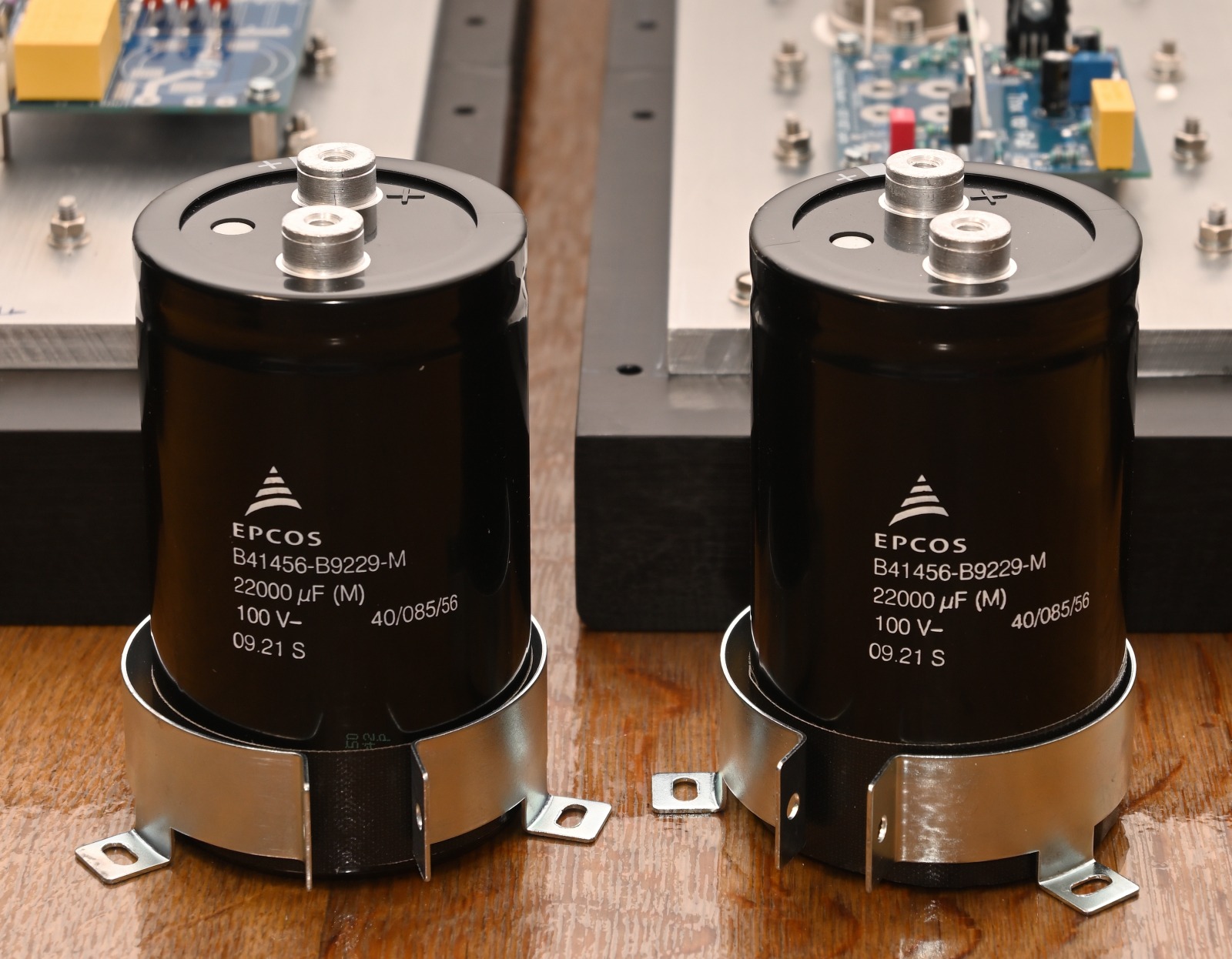

Reason I did not mount any large output caps at PCB is that I have found two caps that needs chassis mount as close to PCB as possible to I can use short wires. Those larger screw mount types have much better data than the smaller PCB mount types (as far as I could see). The EPCOS has e.g. 5 mohm ESR and 17A ripple current capability. They go quite high in frequency. 30 kHz is no problem according to data sheet. The 5 small 1 uF MKC will take over from about 10 kHz or so and probably be the most dominant from there and up.
The EPCOS should give quite low cutoff. Probably below 10 Hz in 2 ohm 🙂
The I can communicate with whales 🙂
Regarding "thick wire"......I consider for this project that 1.5 mm2 is thick wire. Next step up is 20 mm2 which is not very practical (I may have some 2.5mm2 in the cellar).
