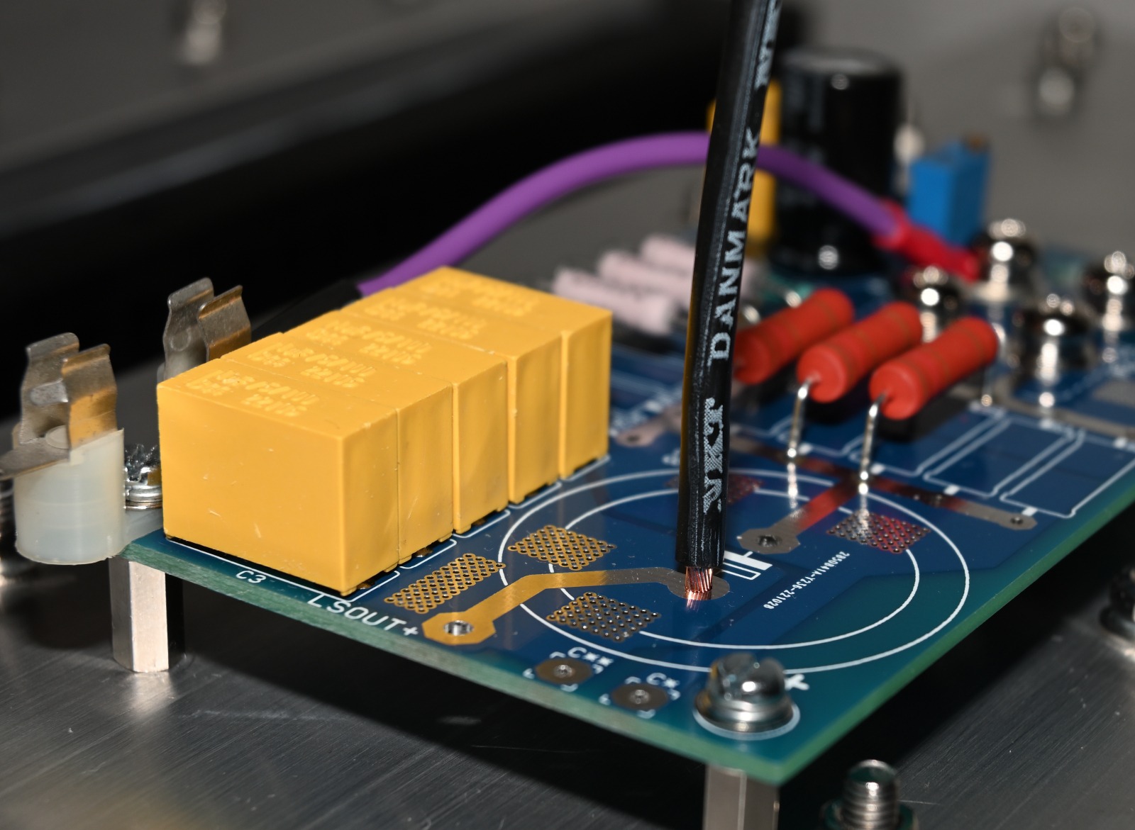

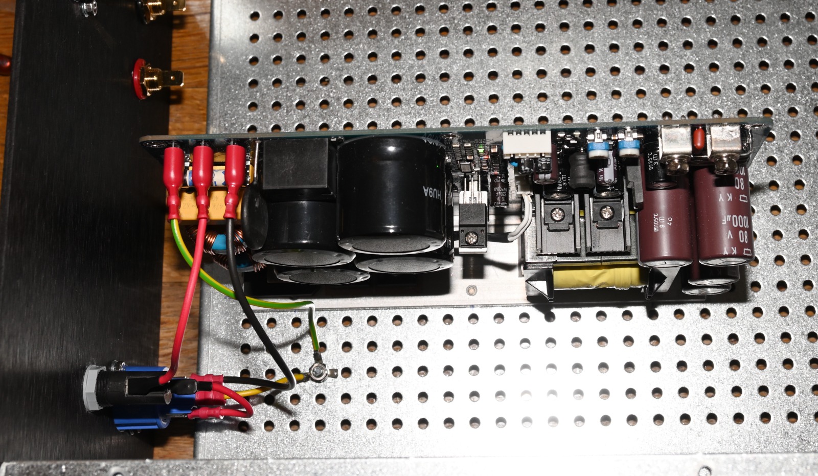

From cellar approx. 3m left of vintage 2.5mm2 cable. It fits into the large holes on PCB and just into the output cap holes.

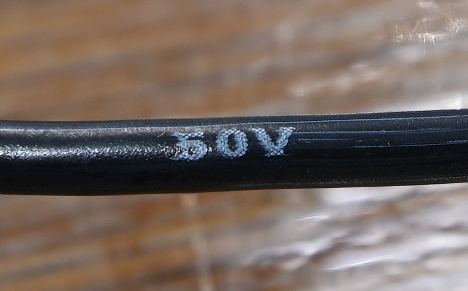

Cable is 50V rated which in principle is not enough for a 65V application. I guess in practice not a problem but it will be easy to just get other cable with correct ratings.
Ok, then I will use what I have.

Regarding the 50V branding the closets I could come to regarding data sheet from NKT is this:
https://nkt.widen.net/content/ipkqtvtaav/pdf/PVTAU_MonteringsledningAPP_LV_DS_DA.pdf?u=gj0n1y
It seems the 50V branding is AC. So < 75V DC .......then I am safe and can get good nights sleep again. Maybe even better after a bottle of 16.5 Vol(t) Amarone.......don't know if the 16.5 is AC or DC......

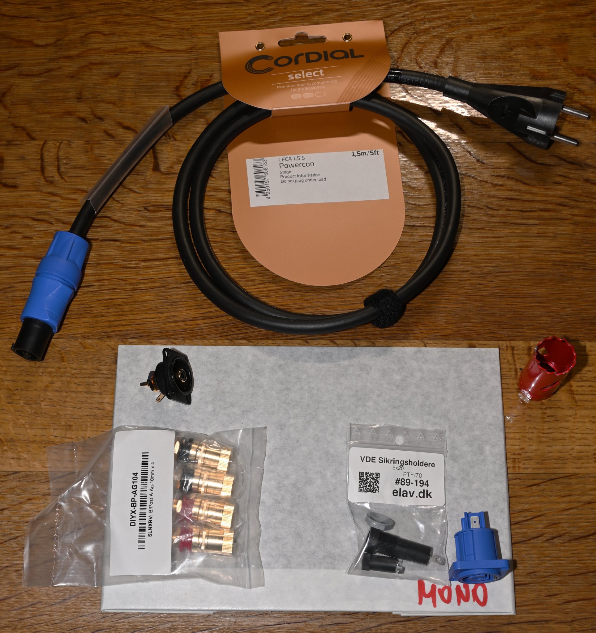

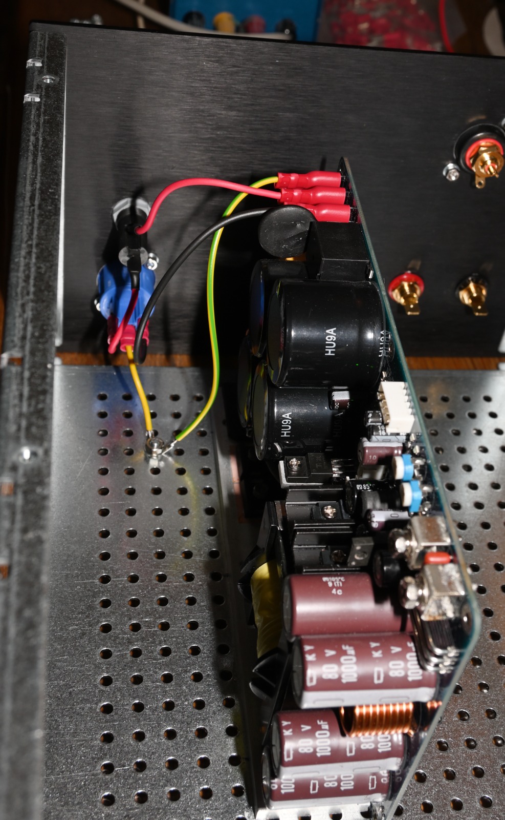

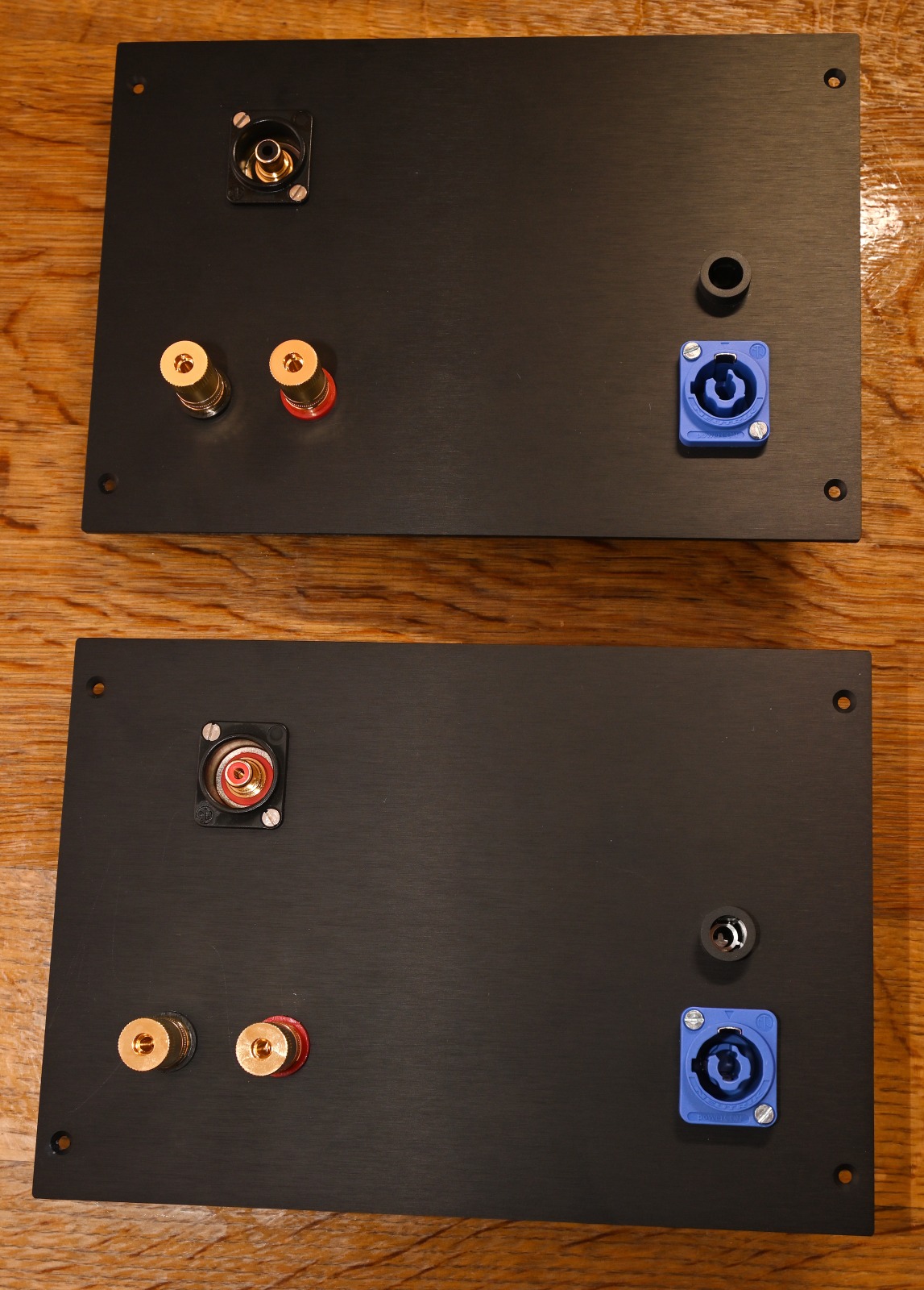

One of the next steps is to work on the back panels. RCA, Speaker terminals, power connector etc. have to be mounted.
Earlier there was a discussion on how to make a square hole for an IEC connector. I decided to got Neutrik PowerCon for an easier to make round hole. Same hole size as for the RCA connector which is also Neutrik. I have done that before using a 24mm hole-saw. It goes like butter through the aluminium. I don't need a power on/off switch for the amps as I have one central place to power it all on/off. For VFET amp I also bypassed the mains power switch on back panel. Often these switches feels a bit "flimsy". Not very high contact pressure?

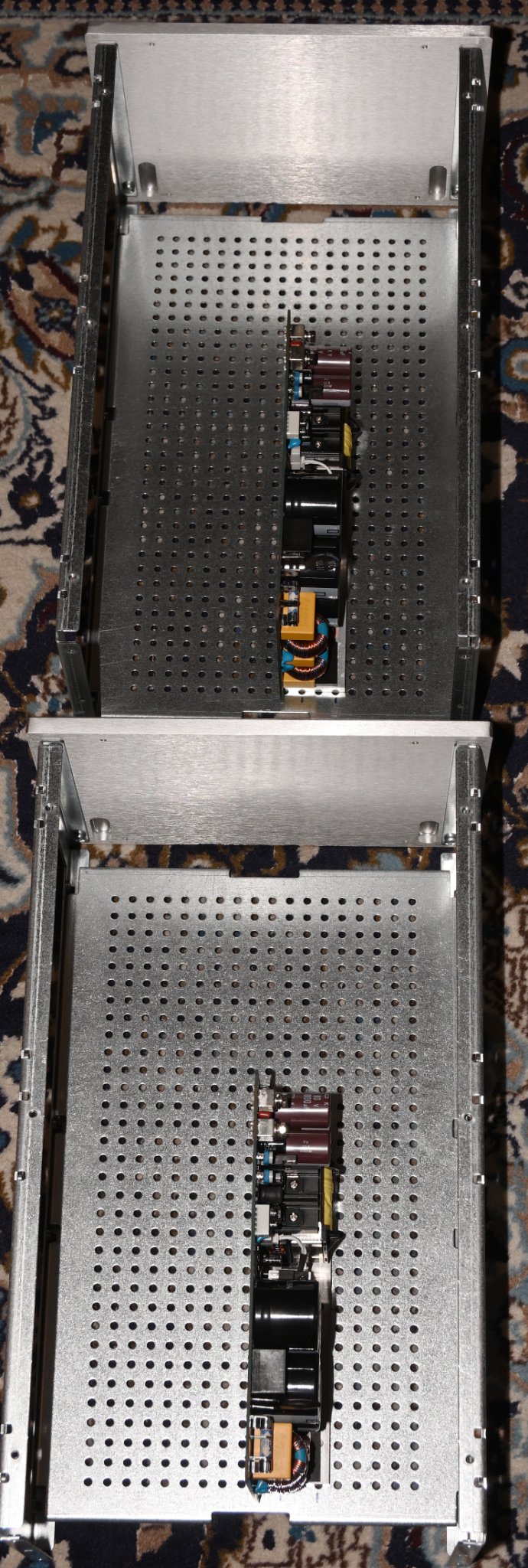

SMPS's have been installed in both chassis. Soon they will start look like amplifiers.
I like the PowerCon mains cables.......1.5mm2 wires! lifetime warranty! 16A rated!

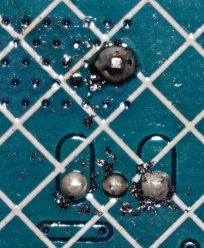

The project will be delayed a bit as I tested the two SMPS's today after I finished the back panels.
One SMPS works as expected while the other starts up with a big bang. I see a flash light from the "soft start" relay immediately after mains power on.
Apart from that it works. 65V at output. I loaded it with 16 ohm for a short time. I need to contact the company (Connex) as I got it directly from them. I guess they may have a theory what goes wrong. The relay should kick in a short time after power on and short the NTC. Also I had a 2A T mains fuse which burned. I guess this should not happen is soft start was working. A shame as I have some days off work so I had time to finish the project......but that is how it is.
After all I am quite close.....I could finish one amp but I want to be sure I can get a spare SMPS or maybe I can be guided to fix it. At least I think a new relay is necessary as it may have some burned contacts.

Probably if I removed the softstart relay it would work. Then the NTC resistor would be in the line all the time. I think only purpose for relay is to short the NTC after a few seconds.
What I am not sure about is if I still had a few seconds before 65V showed up on DMM like on "good" unit. If not this would be a final conclusion that soft stat does not wok. I guess Connex should have good experience with the behavior. Would be strange if I was the first to experience this. Maybe they will guide me to do "something". The "turn-around" time from here to China and back is quite long.......

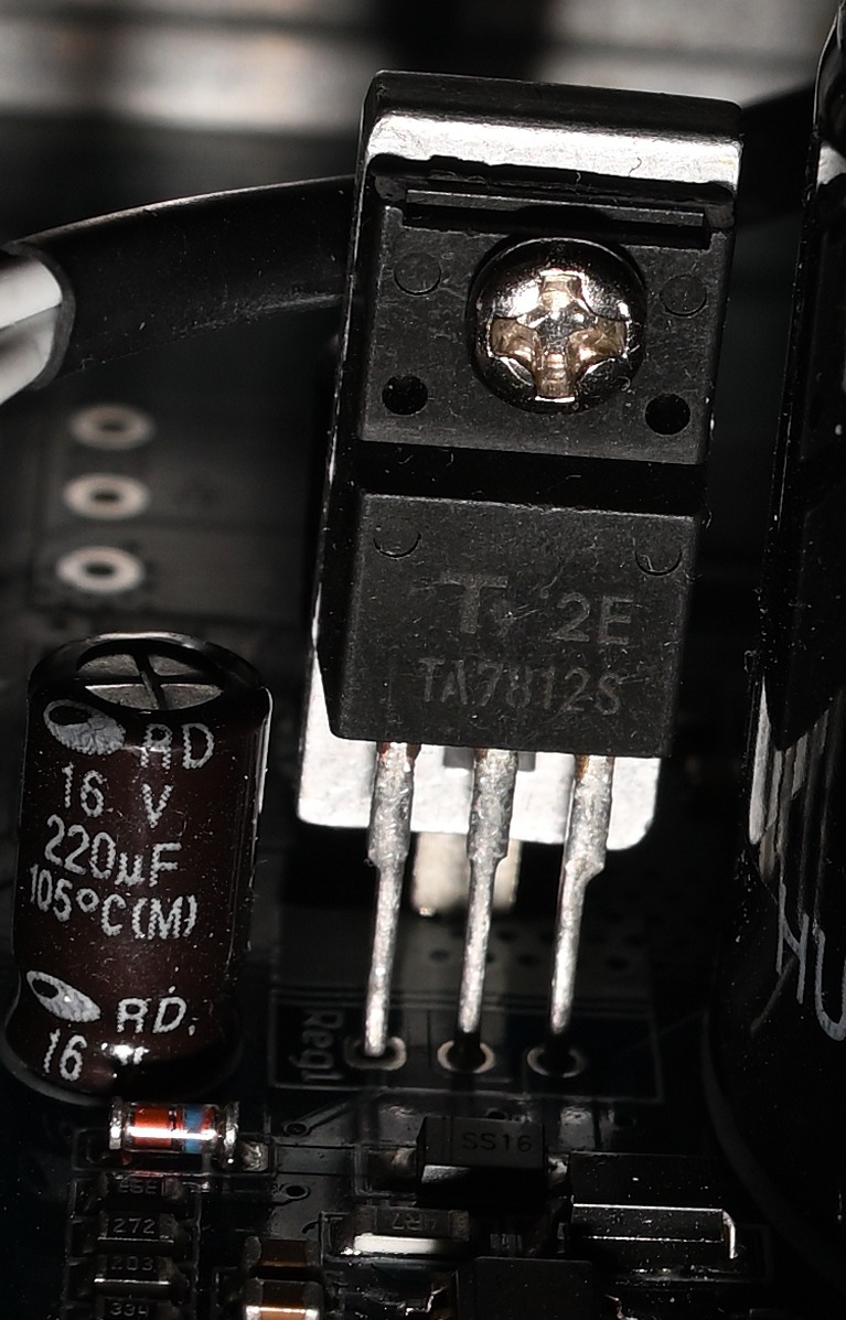

It is 2 x SMPS2000RS modules with 65V output. They where modified with a smaller transformer as I don't need 30A output. Then it can run more efficient and with lower noise.
I compared by looking at fotos components between the two PSU's to see if I could find any differences. Was looking for something that could cause the delay circuit not to function correct by trigger immediately. I have no idea how it is designed. Often a transistor is involved in such a circuit that controls the current through the coil of the relay. I can see a small power transistor (think it is) where there are some dirt between the solder pads. I wonder if this could cause the circuit to trigger immediately.......but it is a wild guess that this transistor is involved in the delay circuit. I should probably clean it anyway........
It is clean on the good board.
