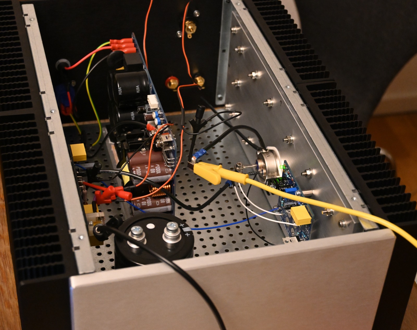

I have one channel up and running and applying -60V and have adjusted DC midpoint to -30V.
But it is not possible to adjust bias higher than 2.15 A or so.......then pot is turned all the way. It reacts very slowly pr. turn. I have checked that it is a 10k pot.
Is there a resistor that needs to change value to go higher in bias? ......it will be a little "fiddly" with all mounted to make changes on board......depending on where it is. Heatsinks are not getting that hot yet........about 62W pr. side with lab supply.
I think it should be possible to desolder a resistor from top and put another one in........

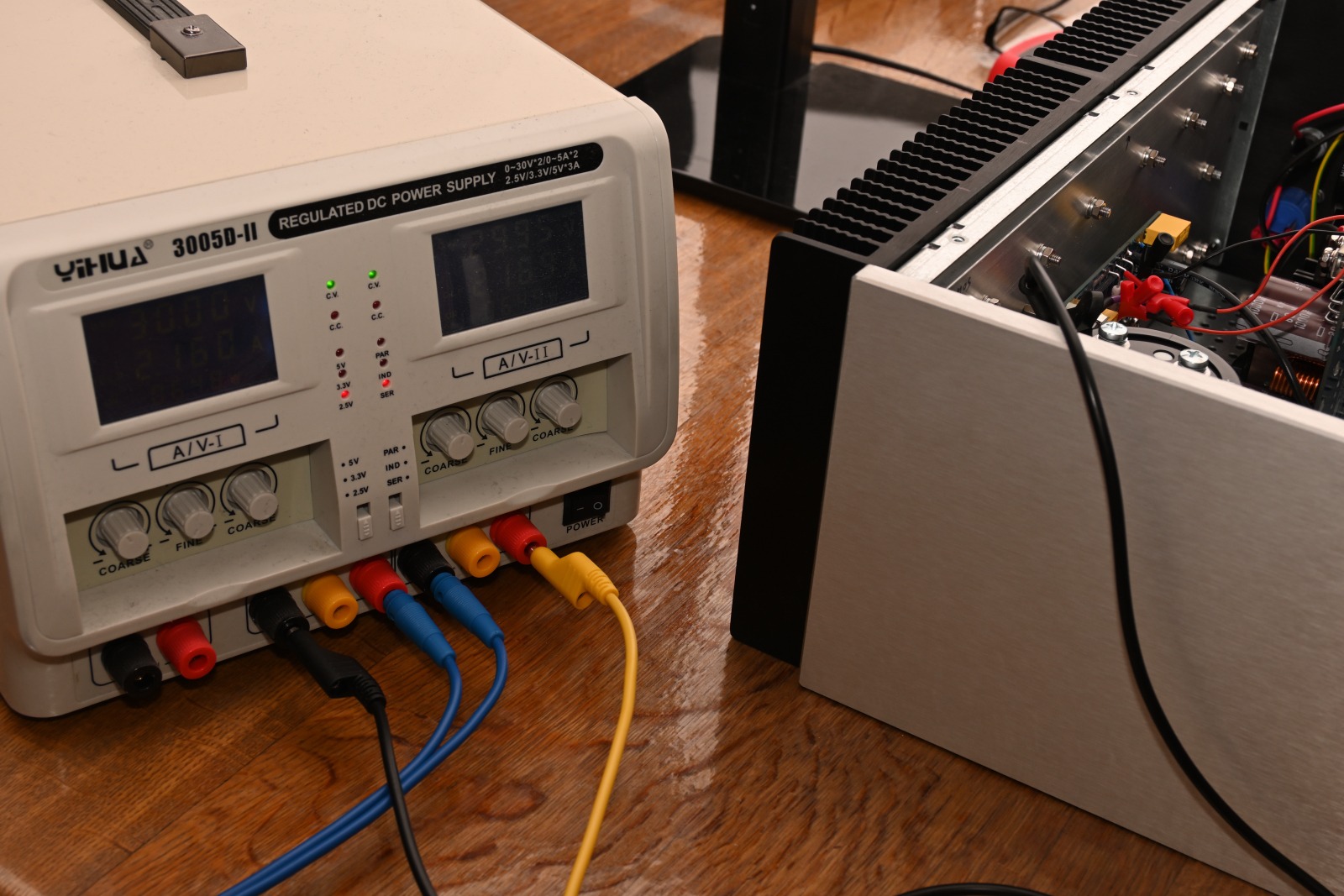

A couple of images from the initial DC-test with lab supply one mono block. The SMPS in the chassis is not connected.
It seems to run stable with 2.15A bias. It does not get more hot at heatsink then it is easy to hold hand the hottest place.
About 65W pr side.

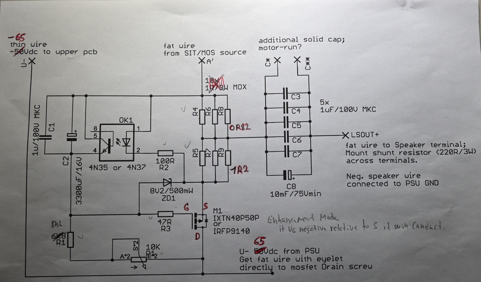

Schematic for the Mu-part is attached. The other part is just standard with components for SIT.
For Mu-part R1 is 8k2 and 0R82 and 1R2 are used as source resistors. M1 is not 40P50P but 170P10P.
I guess 4N35 transistor should conduct less to have Gate of M1 more negative to get higher bias?
So either....or both R1, R2 should have a higher value?

After 1 hour I measured heatsinks with heat gun. The hottest side (SIT) had 49C in center and 43C at the outer part of heatsink.
Now heatsinks have bad air circulation because no feet has been installed so sinks are just standing on table. But probably about 3A bias with 65 VDC (SMPS) is about the limit for safe operation with this chassis. I can see my wish for 4A is a "no-go" 🙂 ......but 3A is fine.....maybe 3.2A 😎
Lab supply can give 5A.......but only 60 VDC......but good for an initial test.
Yes, so far so good.
I think the "bias problem" is because there are so many configurations so it is easy to mix something up 🙂
With the component used I think circuit behaves as expected.......but we will see......I will get more information 🙂
So far my guess is that the "secret" are in the values for source resistors.......how high bias you can get.
There has been some "confusion" about which source resistors to use......5 x 1R, 3 x 0R82 etc.......but to get the ratio of 0R2 and 0R3 I just need to insert one more of each resistor so I have 4 x 0R82 and 4 x 1R2......and then try again with pot set back to center. This will be tomorrow.

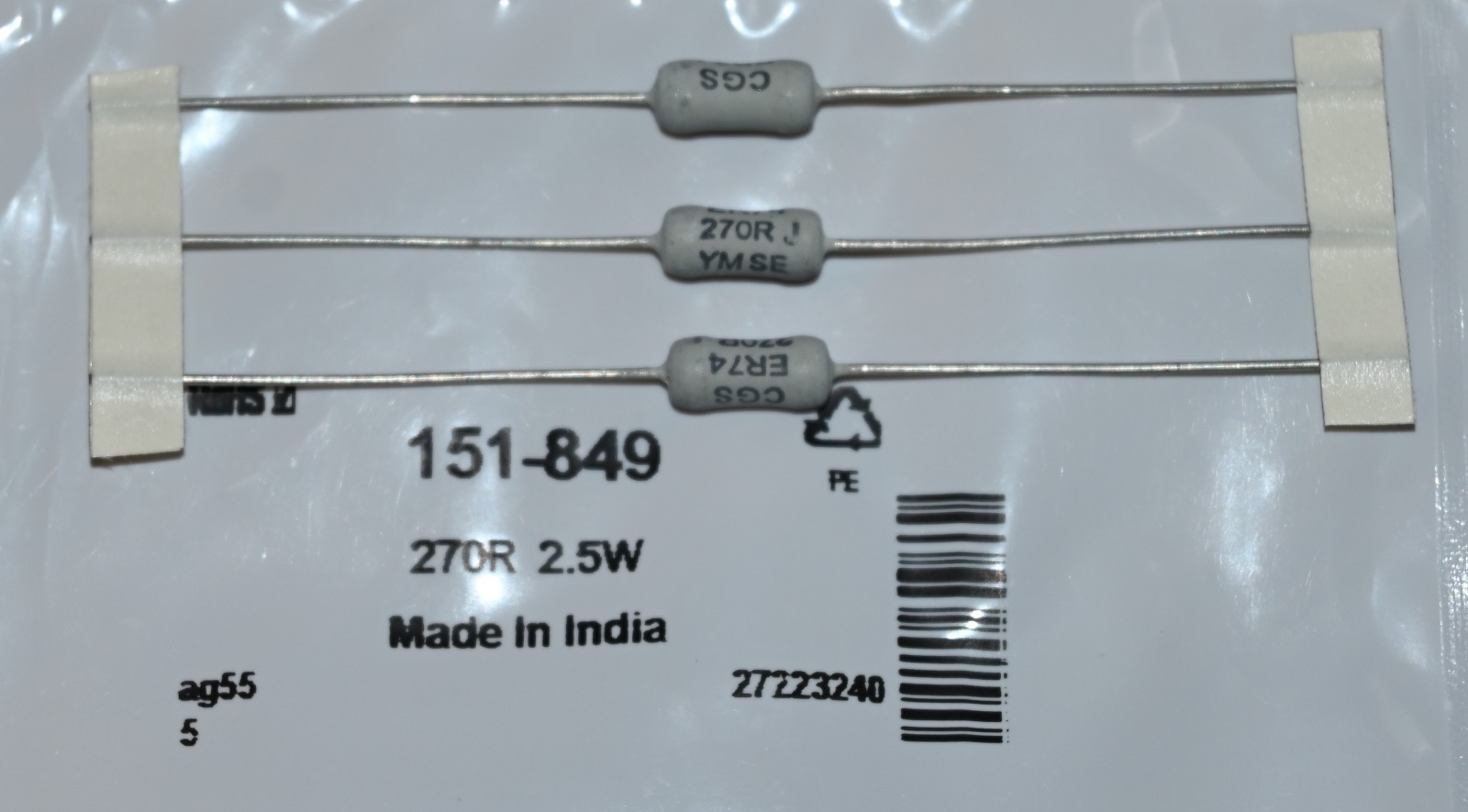

There is mentioned 220R 3W shunt resistor at speaker terminals.
Is that for bleeding the output cap?
When connected to my speakers the woofer is DC-coupled but could be used in a bi-amp configuration.
So I should probably mount them?
I found 270R, 2.5W. I guess these can be used......
clarify
when speaking of Lazy, no speaker is DC connected to it ........ output cap is always in the game
I don't care for your xover, if you're speaking about that (woofer)
said resistor is intended to be connected across amp speaker terminals ....... and yes, that's output cap bleeder :clown:
Yes yes, I meant woofer + xover is maybe 6 ohm DC resistance when connected.
I will mount the bleeder resistor then cap will bleed at all circumstances.
I wonder about bias when I put in the extra source resistors in. Then I have 0.5 ohm in total.
The max. voltage I could get across the 0.67 ohm (as is) was about 1.44 V. With 0.5 ohm this will give 2.8 A.
But maybe "other things" will cause that bias goes higher......e.g. less current through diode of 4N35 because voltage will be less across it caused by the extra source resistors........it is probably so.
