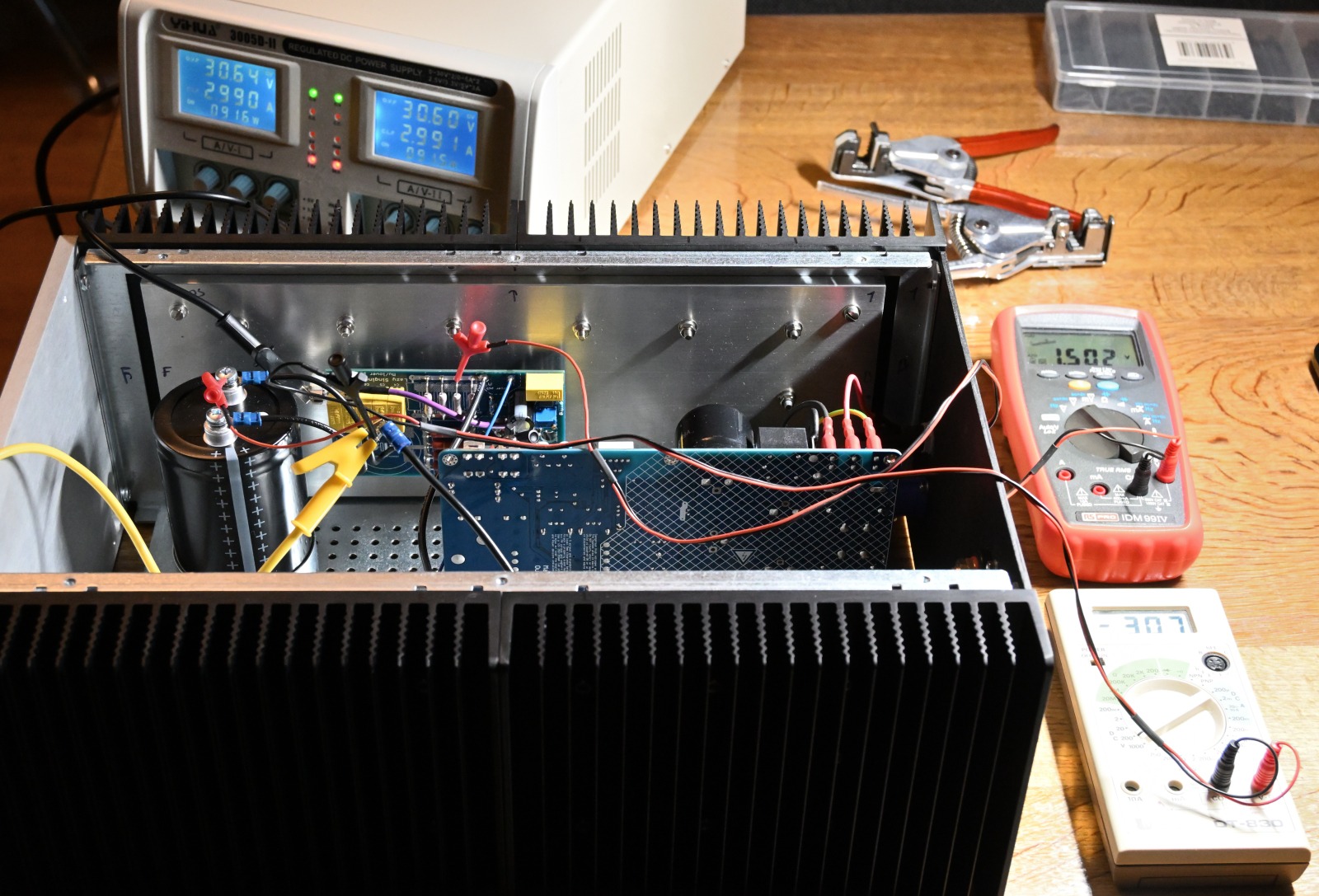

2nd mono block is up and running with 3A bias from lab supply.
Next step is to switch to SMPS. Power it up and adjust bias and DC-offset again. Then connect RCA wires and speaker binding posts......bleeder resistor etc.

I now switched to the SMPS and turned on the amp where SMPS had some troubles during startup. This time it did not start at all at the first try. I traced the problem down to the large 15A Bussmann fuse onboard (Connex also pointed out that this could be the problem with the big bangs I experienced). When I measured at the fuse holders there were no connection. Then I took it out and when I pressed really hard with probes I could get connection. There was some sticky stuff on. I cleaned it and also I used a bit of 3M green scotch brite pad to be sure everything was removed. With brite pad the contact ends on fuse went from brite to a matte finish. I also cleaned the holders as good I could and tried again. Then it started up normal with 65.1 V. I adjusted the DC-offset to 32.5 VDC and also raised the bias a bit. It seems when pot is maxed out I get 3.05A which is close to 100W pr. side. About 199W in total. I think that is fine. Don't think I will raise the R2 again. But if I had a 150R that would be a better value probably. Heatsinks will probably now pass 55C......where it is hottest.
Hope it can sound good with 3.05A bias........

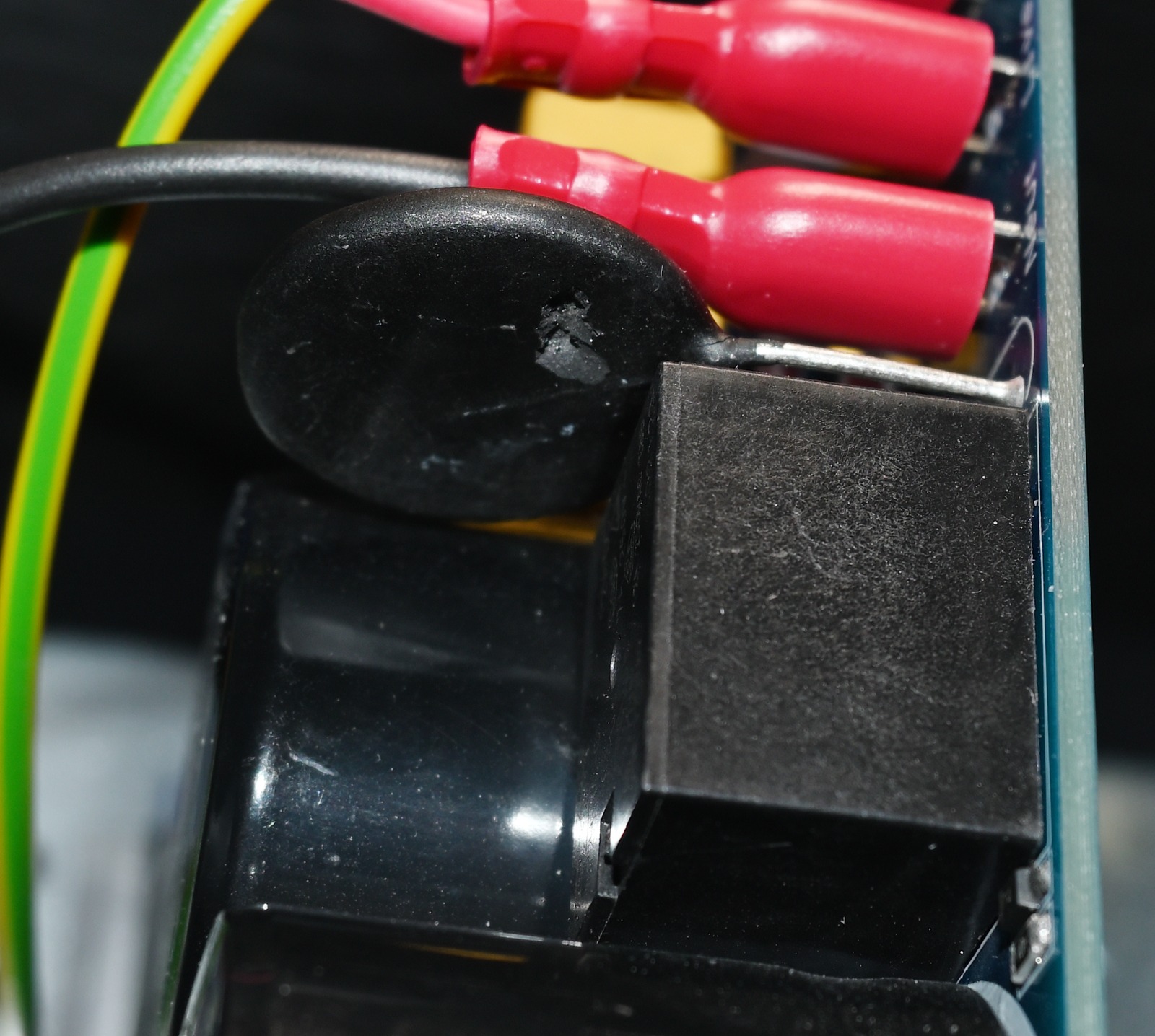

I think I just found out what causes the "funny" flash light and "bang" I experienced from one of the SMPSs during Startup.
It clearly came from the NTC just beside the relay. On image the "burn mark" on NTC can be seen (grey mark). So I think I need to change it. I have something similar. First I thought that it came from the relay because they are so close together. It was also an issue Connex described that such an error could occur. First time I see that.
