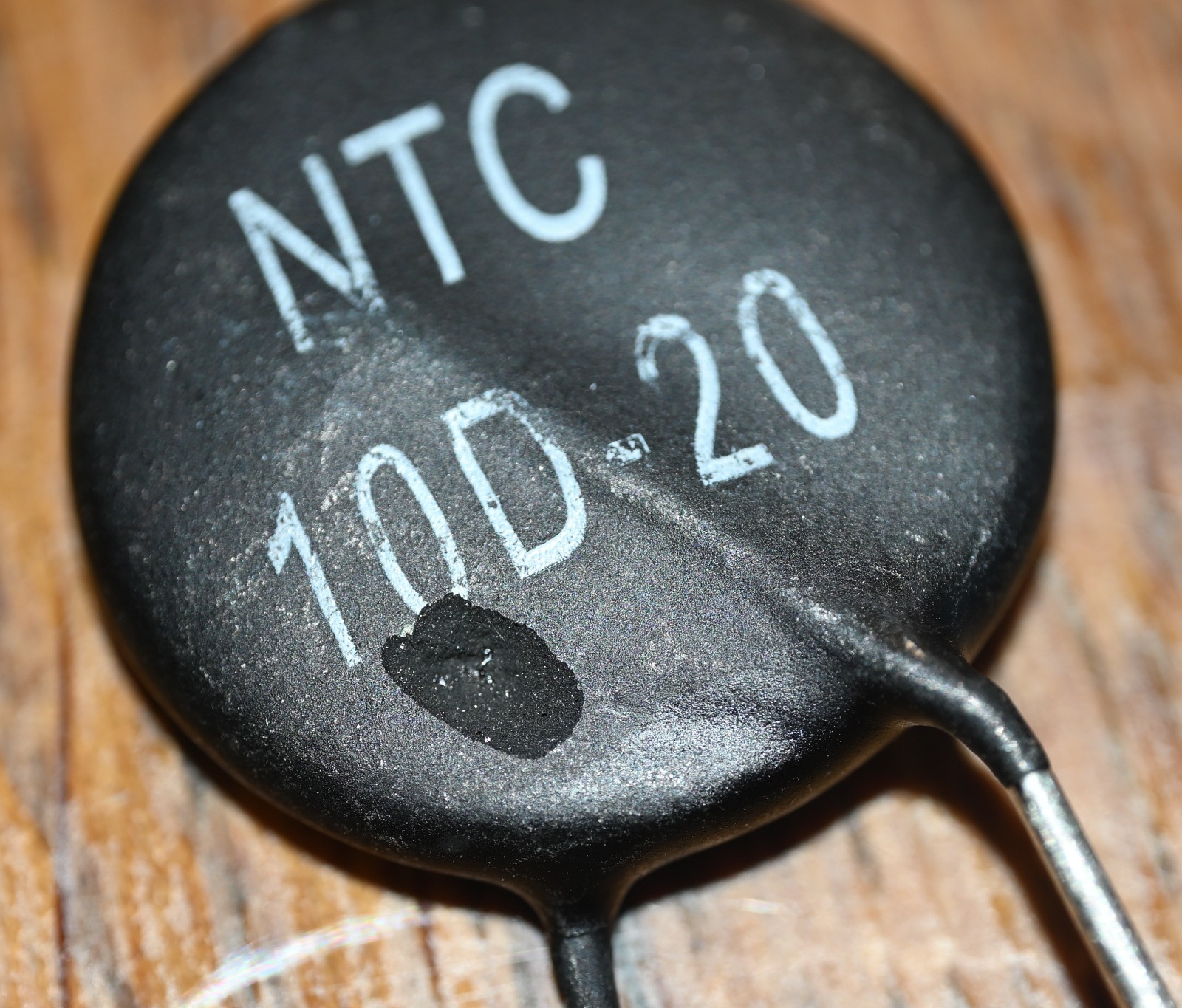

10D20 only says that it is 10 ohm and 20mm in diameter. There is no brand name on it.
It seems that's how you compare NTC 🙂 ......ohm and diameter 🙂

Here is the final proof that NTC was/is bad........

10D-20 is pretty generic drek, meaning no special characteristics
pretty much any 10R 20mm Dia is equally good

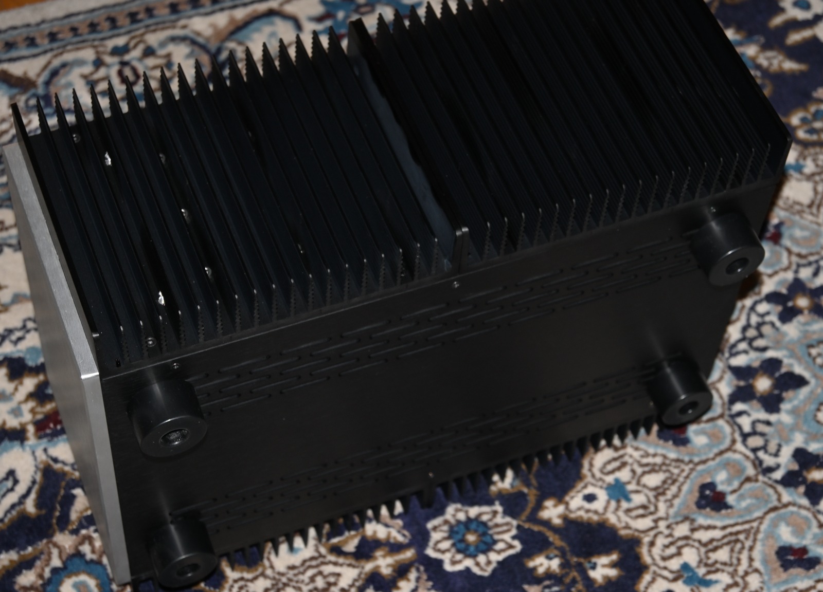

Another task I did this evening was putting bottom cover on and screwed on some rubber feet. It will give better ventilation that the plastic 10mm feet applied with chassis kit. I think feet applied does not live up to the quality of the chassis.......but easy to put on other feet. 4mm screws fits in the ventilation cut outs. I could mount the rubber feet without any drilling......just screw them on.

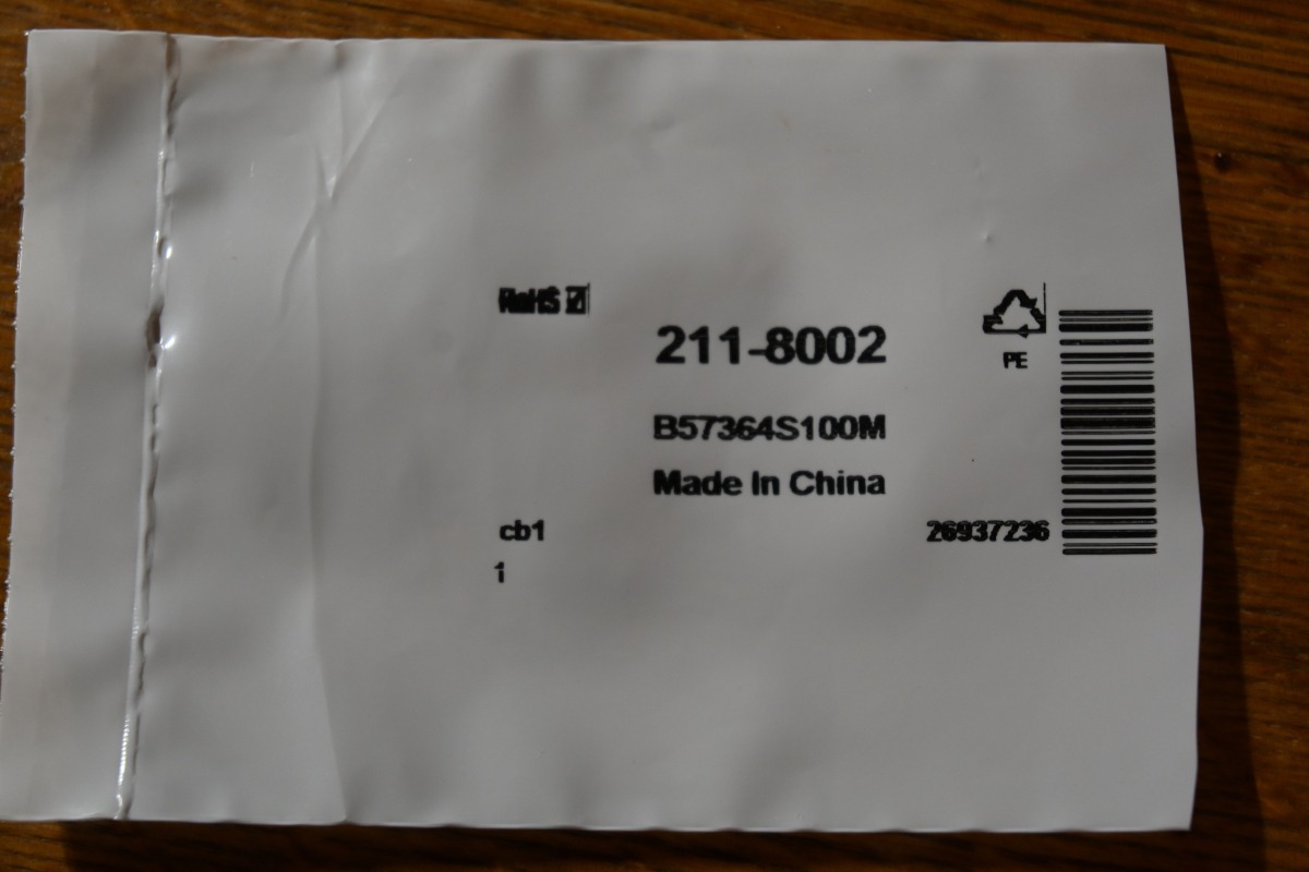

The NTC I put in is a branded one......from RS Components. So at least one branded component now. The fuse Bussmann is also branded.......and works without sticky stuff on them. When I searched for the relay I found that Mouser had them.......but I agree that some components are unbranded like the 12V reg.

I just looked at the branded NTC I put in. It is also from China. But as a branded one the quality control might be better. It could be produced at the same factory?
