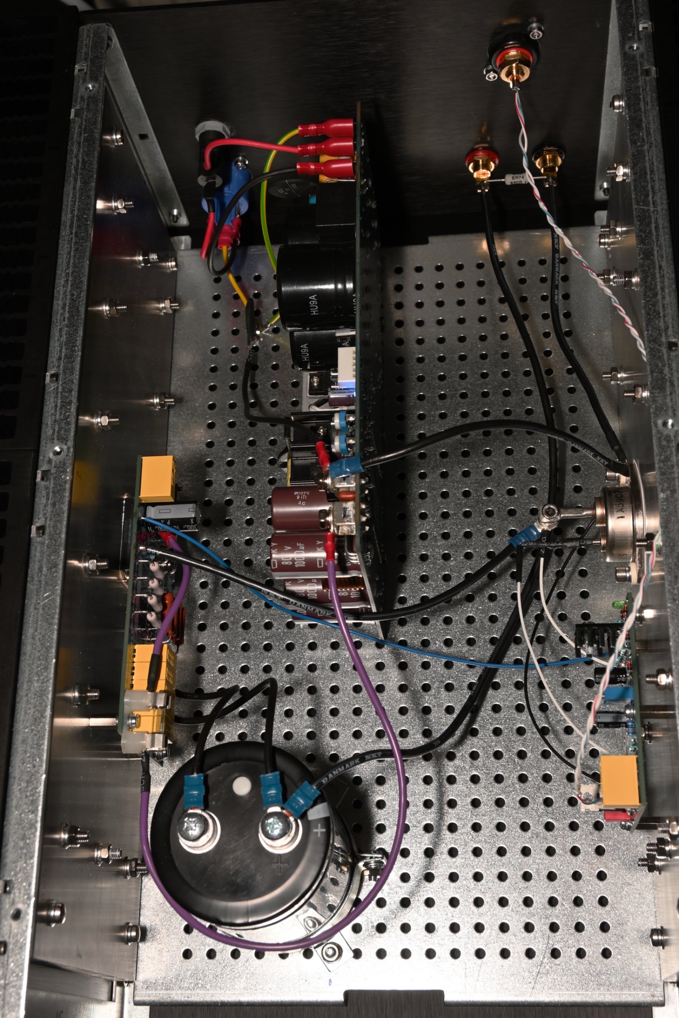

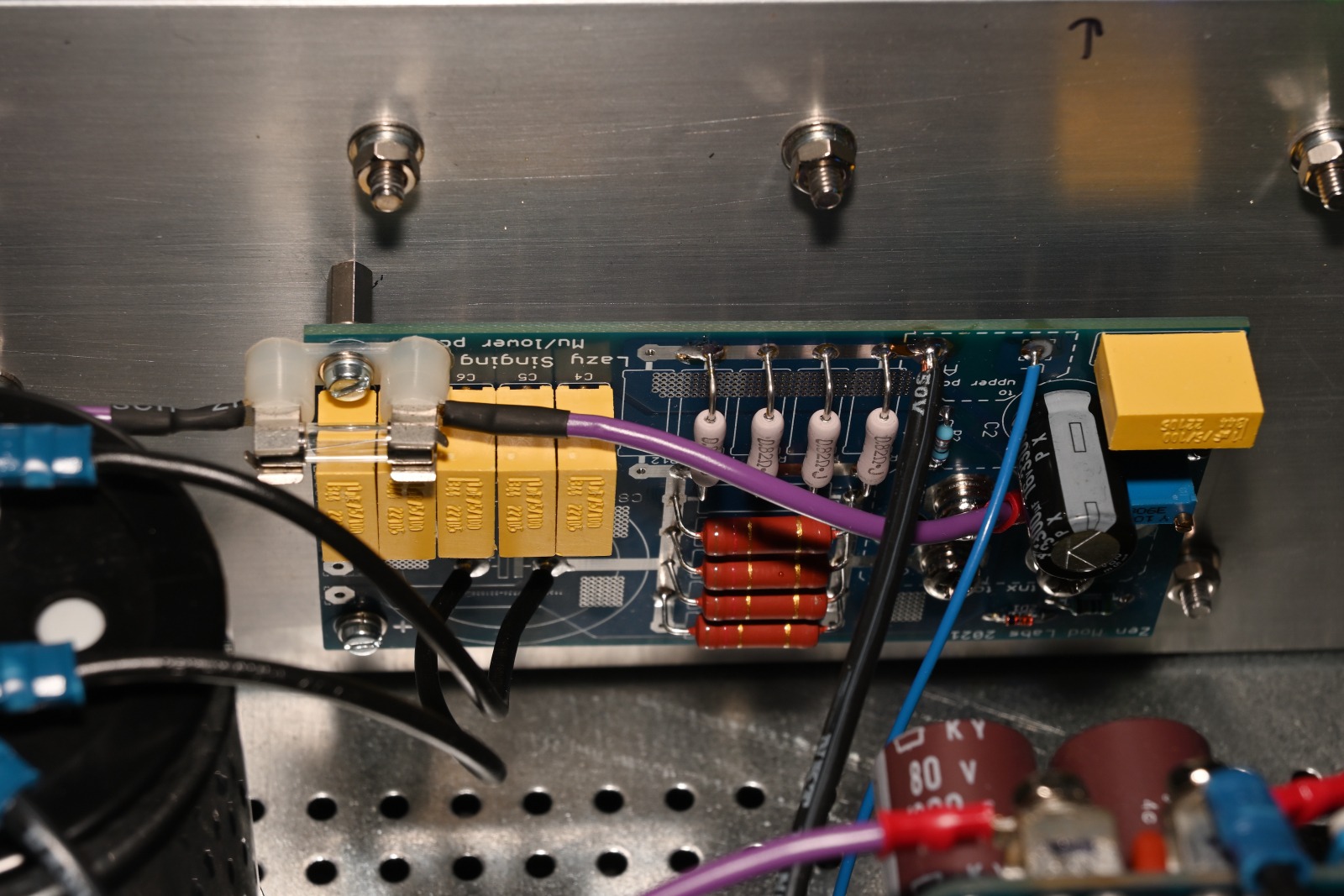

Looking at pictures my own comment would be that boards could be arranged different to have much shorter signal wire to RCA connector. It is the most obvious weakness as I see it. But if I cut the wire and grounded at PCB it would not cure the noise.
What I concentrated on in the build was to have short distance between boards and also that the SMPS was out of the way from boards. So it ended as is.
The SMPS filters are mostly to reduce high freq? .....so will probably not help in my situation?
What I would like to try was to remove signal Gnd from chassis/earth just the test shortly if it made a difference?
If it did then I would now where the problem was?

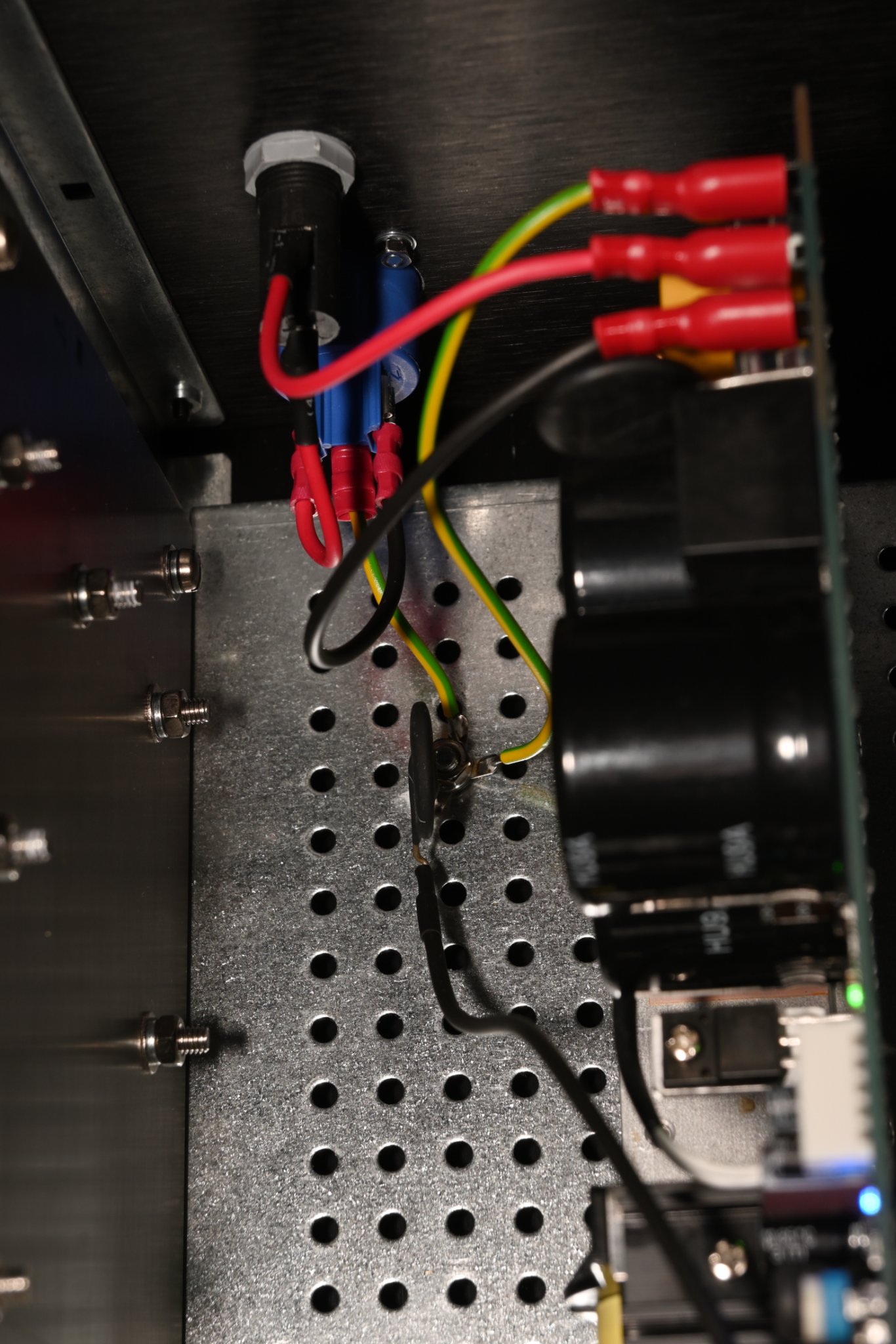

The SMPS is mounted via its heatsink at the bottom via six M4 screws. The heatsink is internal connected to earth. As you can see I also have a chassis screw just beside the SMPS. In principle are there two earth connections. One via the screw and one via the SMPS heatsink just beside each other.
For at short experiment it is ok to remove GND to chassis?
Safety wise I have no Earth in mains so......but there is a HPFI relay which will protect.
What I would try first is to remove NTC connection from positive rail (very short experiment). It is an easy test when amp is cooled down a bit.

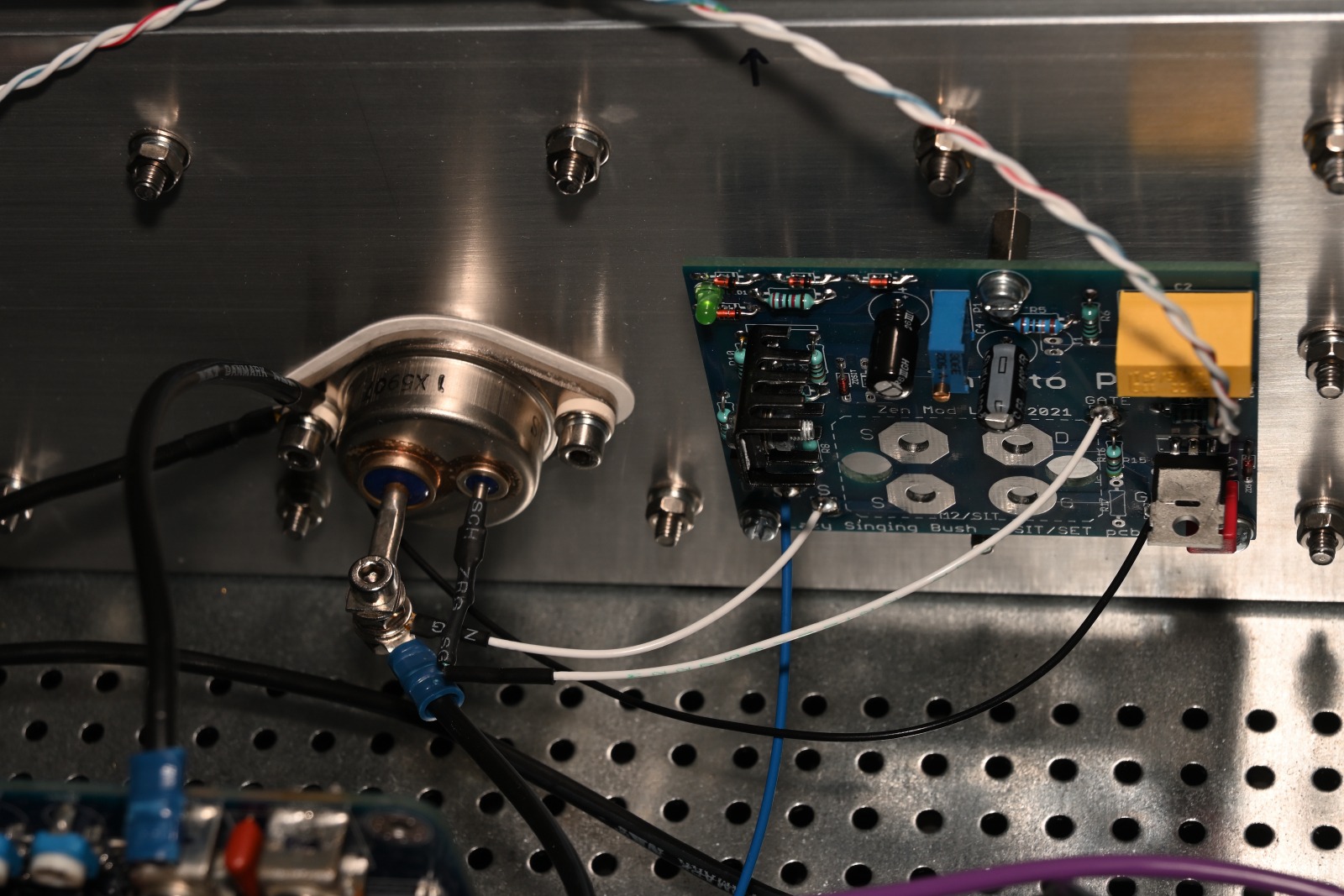

SIT Drain need in all cases connection to PSU V+ (GND). Do you mean a wire direct from SIT Drain to NTC/Earth (instead of from PSU)?

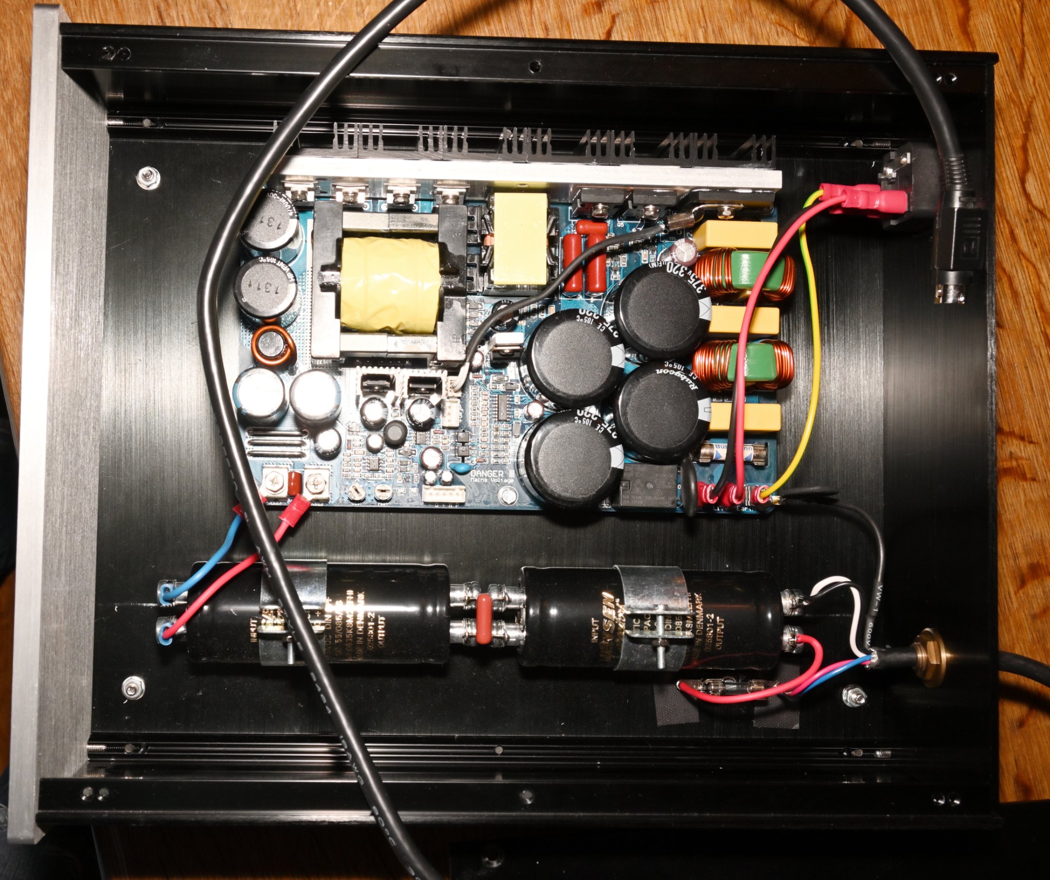

I looked into PSU box for VFET amp. In this I have not Earth screw. The four screws in the corners of SMPS have chassis contact and contact to yellow/green wire from mains. Then I have NTC to one of these corner screws which goes to screen of DC power wire which connects to VFET amp (the 4 pole connector).
I could try something similar......to remove the chassis screw I use for mains earth and then use a corner of SMPS board. Then only heatsink of SMPS will have chassis contact?
The two 4 pole caps in serial in VFET PSU reduced ripple with a couple of mV......from 11 to 9 or so. They just act as sophisticated wires.

I will reconnect the chassis earth connection. I will do it so PSU only have chassis connection via heatsink and not via chassis screw and heatsink. Then I am sure there will be no ground loop there at least.
I tried to disconnect amp from PSU and used a test speaker load (2 x 8 ohm resistors) to draw 4A. Then I see 148 mV ripple.
Maybe it was an error to get a smaller transformer for my purpose. VFET PSU has the standard one so it is a 2kW module. Then the logic says that if you only use 120W then ripple is small compared to use full power. But Connex people tried to convince me about that is was an advantage regarding noise to reduce max. power using a smaller transformer.

I plan for using Drain also for the chassis via NTC and I select a chassis point very close to the SIT. I guess that is ok that the heatsink panel the SIT is sitting on is also the chassis point?
A re-measurement showed that PSU heatsink is not connected to earth. I have fooled myself regarding this earlier. Then Drain of SIT becomes a real star-point for the amp. I will probably go for the 159ZJ for a future upgrade and a decent cap. Maybe it was the same I used for M2X. It was also a Hammond 159 type but maybe less mH, less Ohm and more A.
Ok, I will order chokes and 22mF caps and rearrange chassis screw close to IEC and then continue when chokes/caps arrives.
