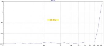

In all topology that use OITPC, I found at low level the harmonic level is almost monotonic, but at high level depend on topology. I think, OITPC only reduce high order distortion at low level.
Bimo, how compensation can be level selective? No, you observation is wrong, nothing to do with OITPC.

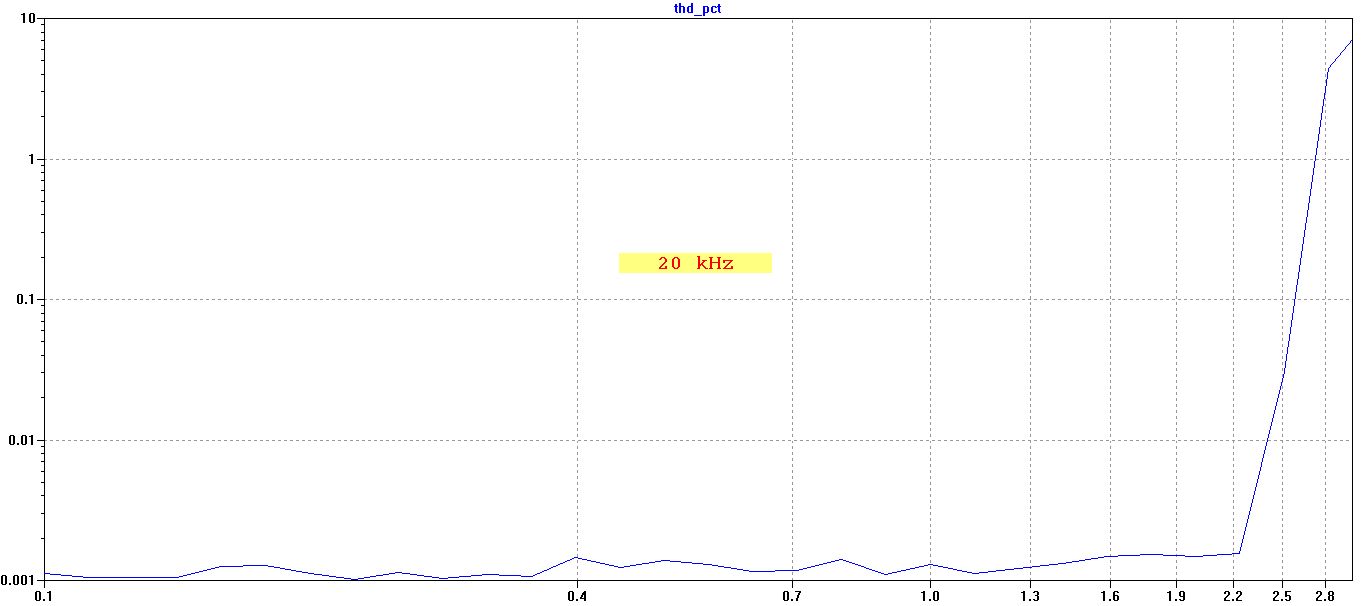

Attached the THD20k plot of the 200W CFA where OITPC was used, no much THD increase with input level.

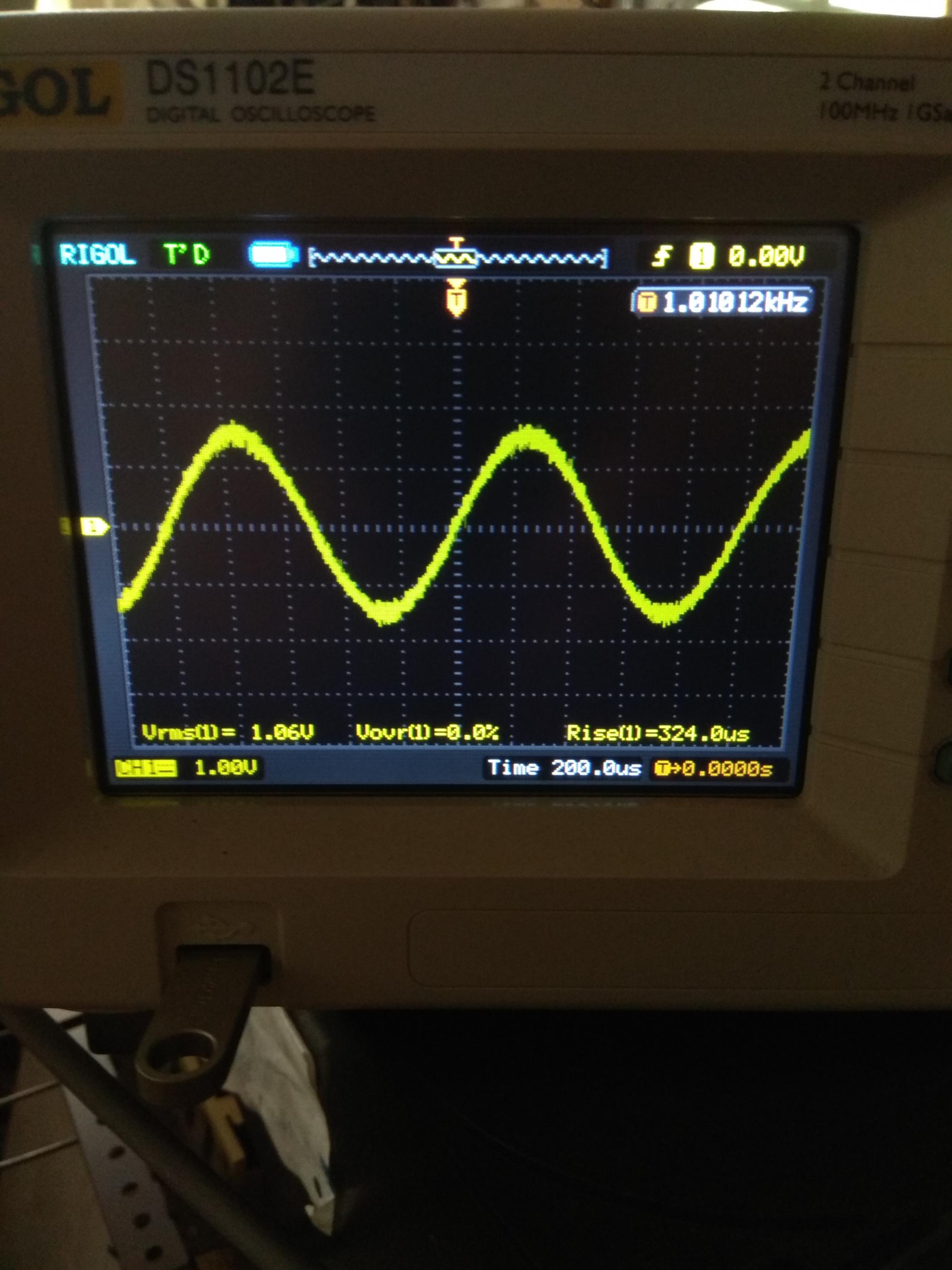

I have tried both, same problem
I am quite sure there is problem with oscillating cascode, look this link :More Notes On Cascode Amplifier Oscillation
You can tray to find what side of cascode oscillate by moving finger close to cascode transistor from the pcb back side and lookin on oscilloscope if frequency changes.
First try with 1nF XR7 ceramic caps between base and ground, and if still oscillate increase R11, R12 to 1k.
I built similar amp with one difference, instead resistors R5, R10 I used CCS and there was no oscillation. This one I wanted to simplify.🙁
The used laterals are very sensitive to oscillation if the gate wire is very long - this may be the reason here. Try to cut the gate wire and solder the gate stopper resistor as close to the mosfet as possible.

Thanks Toni,
I don't think that are laterals, gate resistors are quite close to the gates, and oscillation of 20MHz is not coming from them.
BR Damir

Then it is mostly to less GM/PM. Had a similar problem during my SA2016 development
Simulation models differ from the real devices.
Try to increase the miller cap until subtle oscillation stops.
