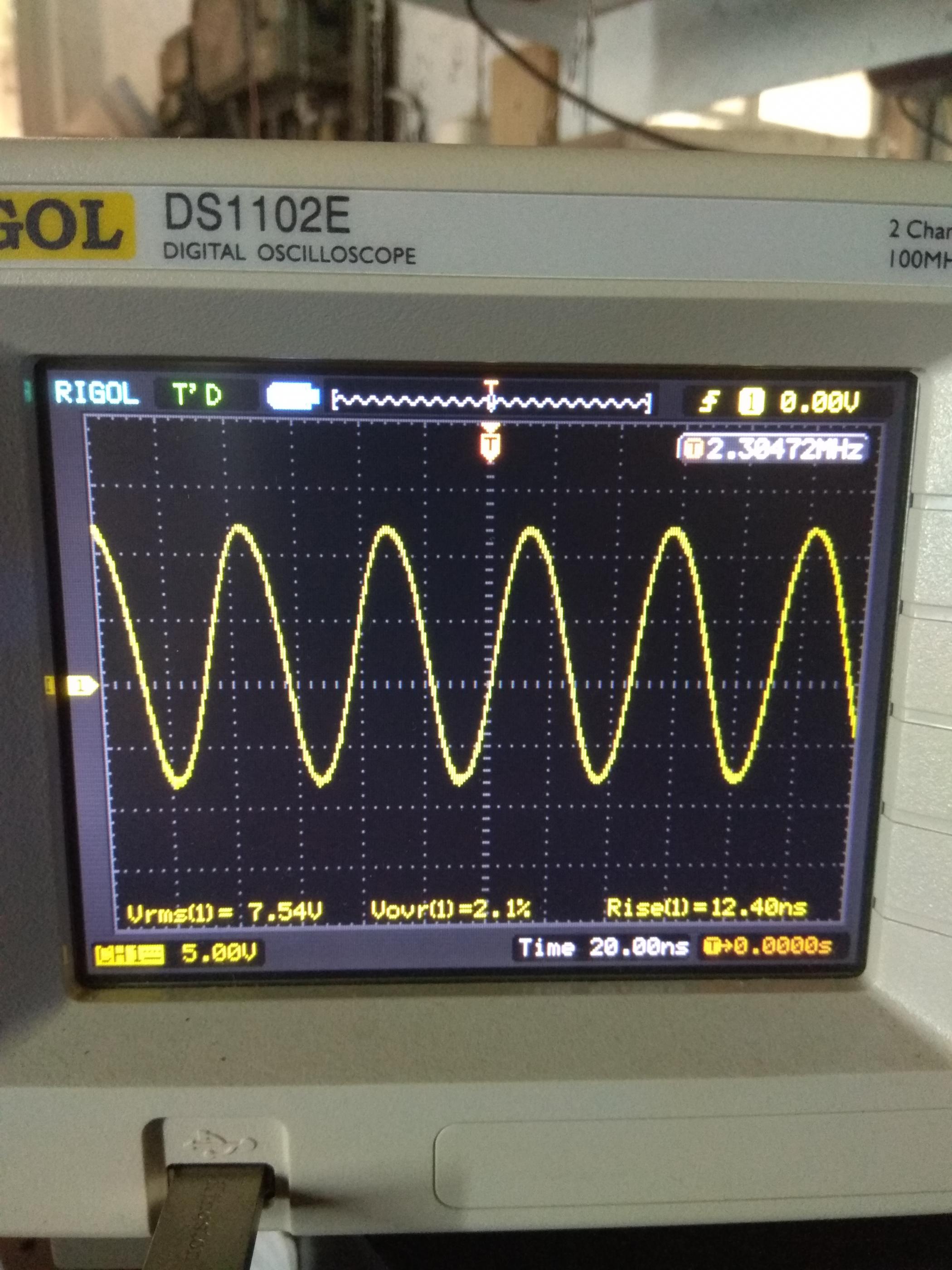

Ok. Here is the scope at the output, no load, no input signal.
Most of the time is 21.7Mhz.

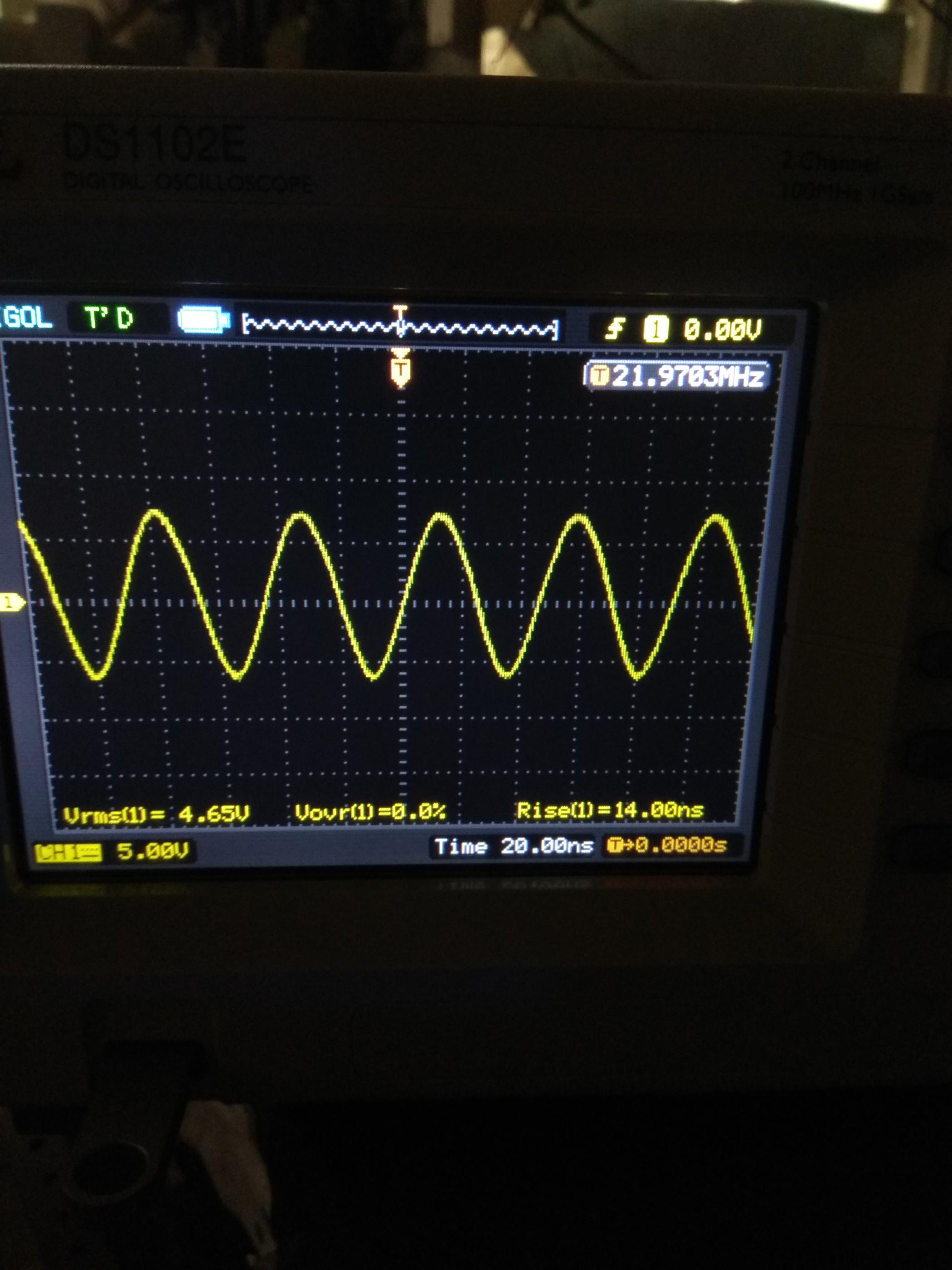

Are you sure that all compensation caps are NP0 type?
No, i'm sure for the 220pf smd and 47pf only.
Probably 22pf aren't.
Do you have 22pF mica type?
No, but changed with 22pf COG, same things.Do you have 22pF mica type?
No, but changed with 22pf GOG, same things.

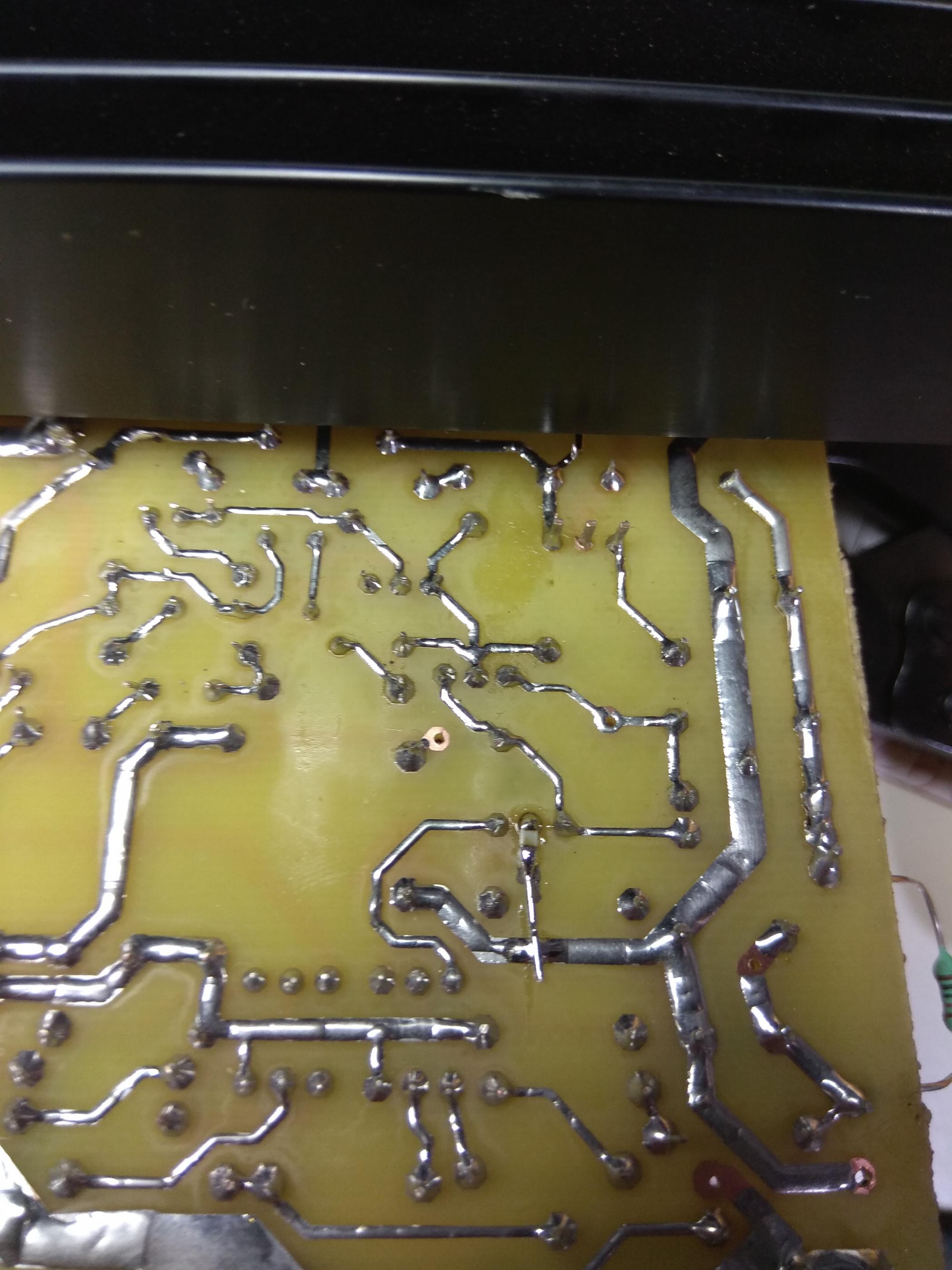

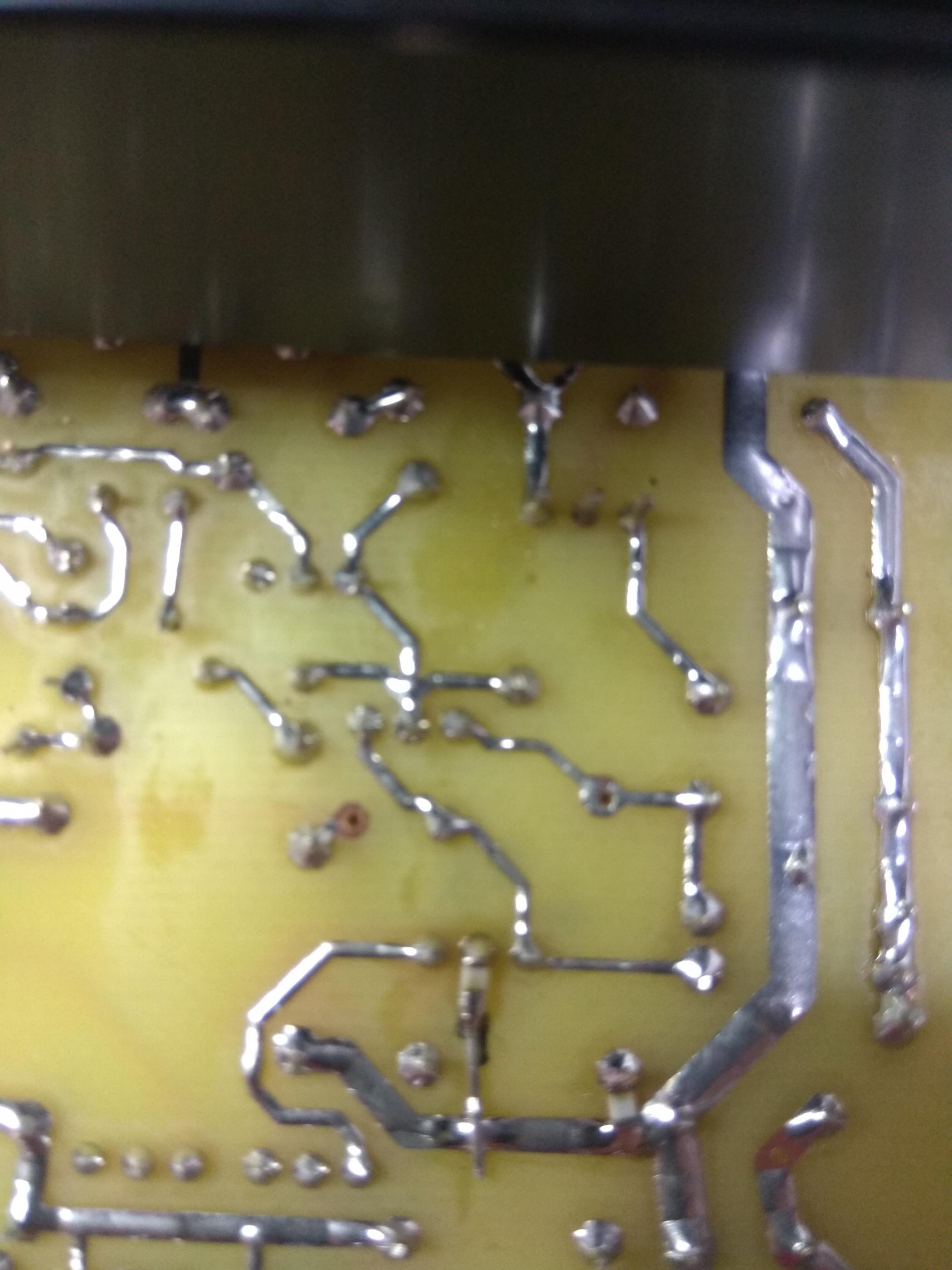

OK I think I know what's provoking this. Connect 100pF(not critical 220pF is ok too) NP0 between base and ground of Q5 and Q6. This is cascode and it can oscillate.

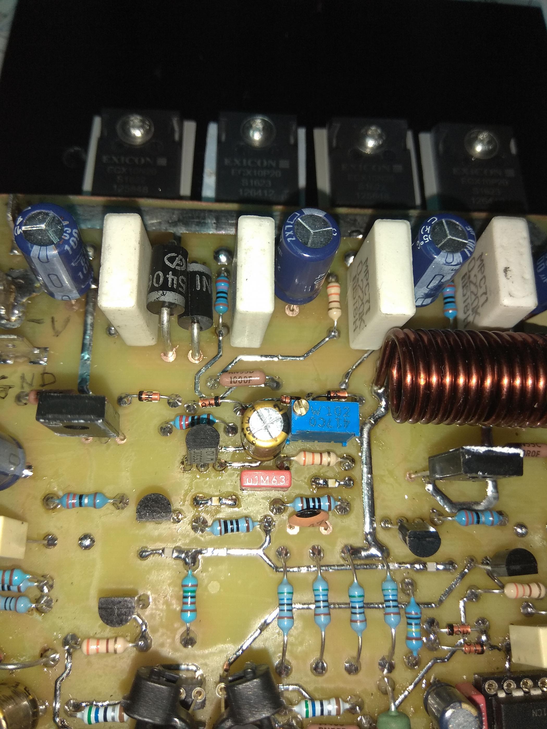

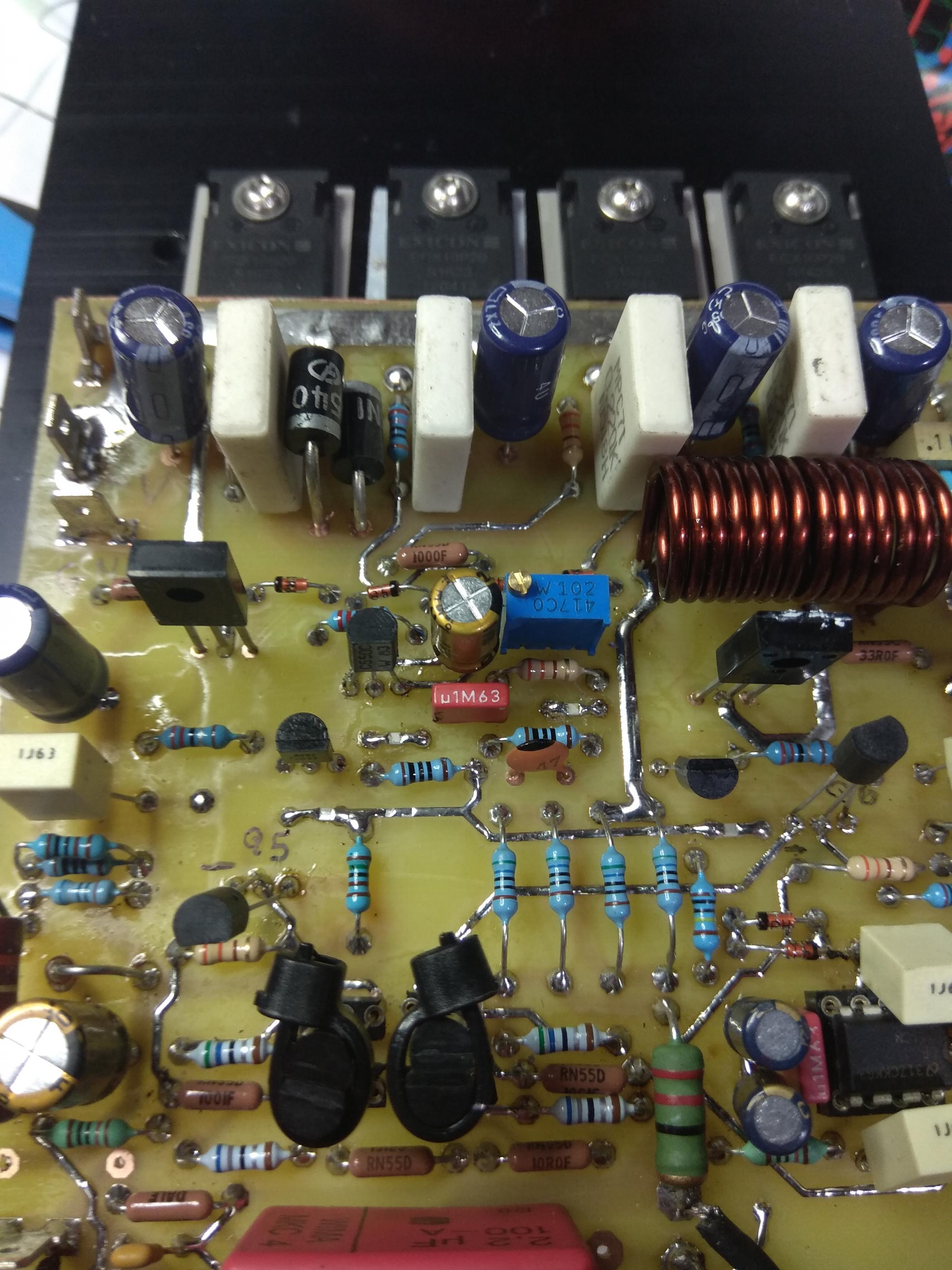

Capd adetted but the problem is still the same
Could you show the photo?
What cap value?
The photo were caps adetted?
220pf.
220pf.
Please Damir see post#130

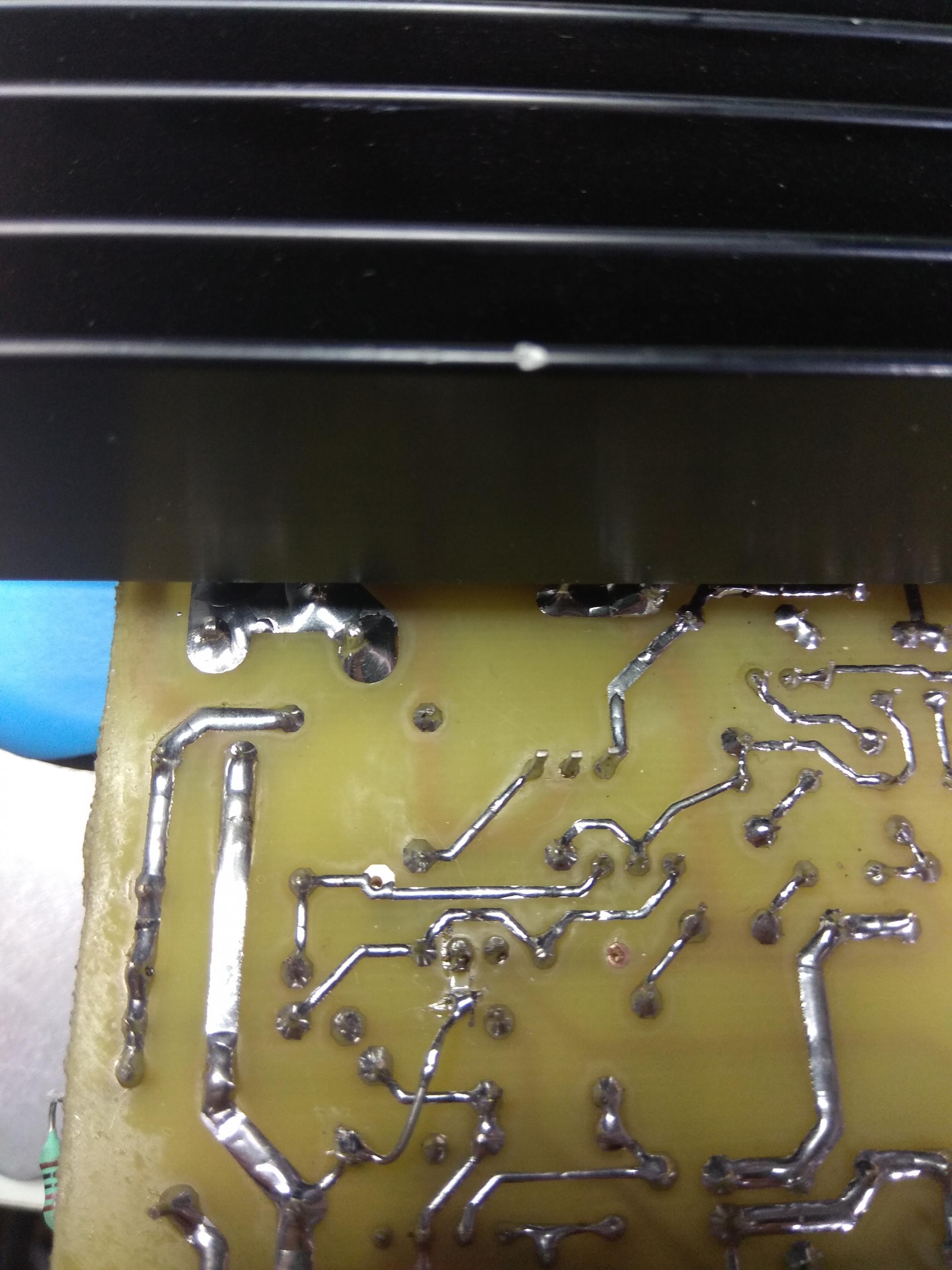

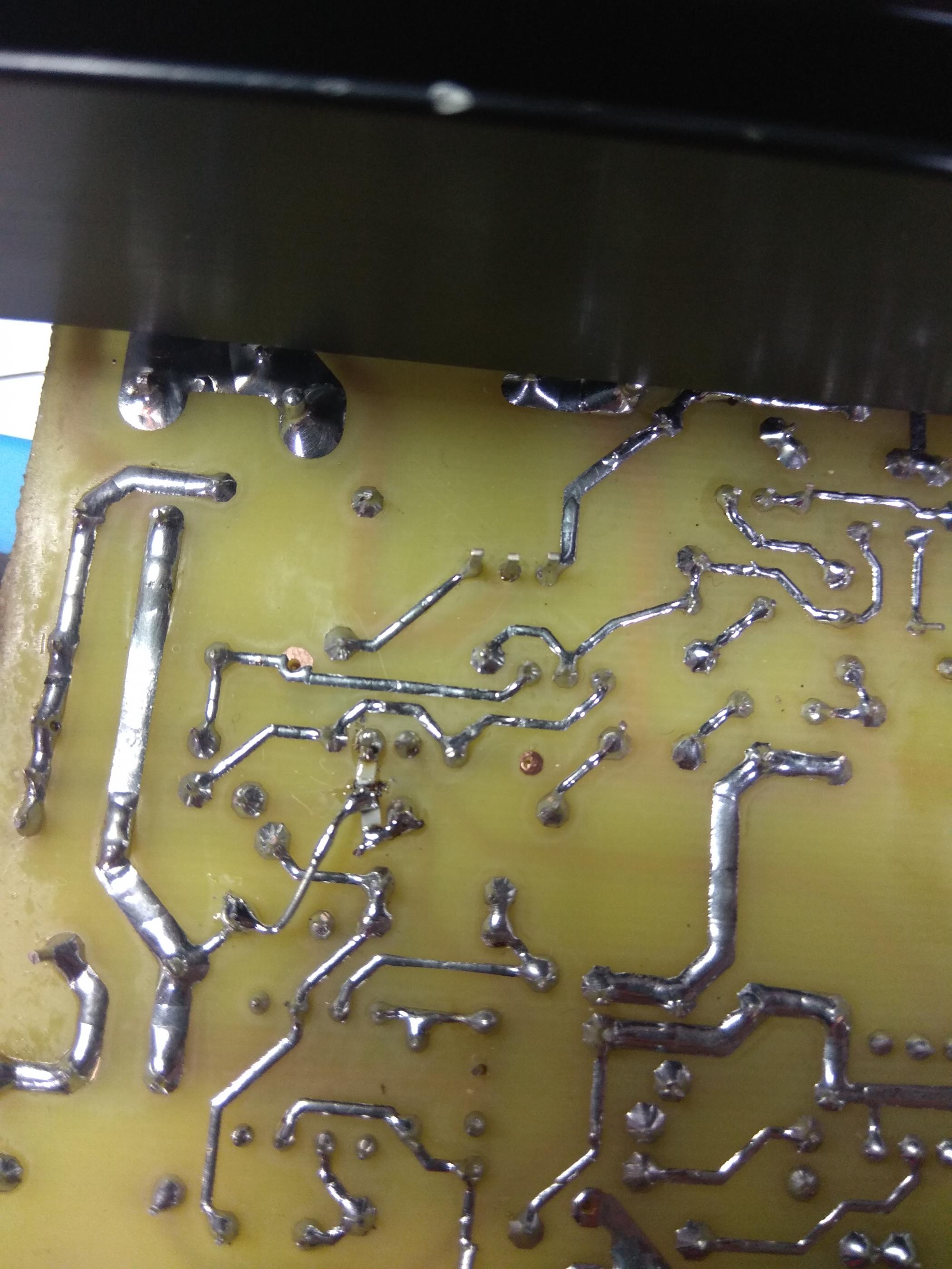

Two smd 220pf cog one at the base of Q5 and one at the base of Q6.
Yes I've seen it.
Could you add two more caps 220pF between other side of resistors R11, R12 and ground.
