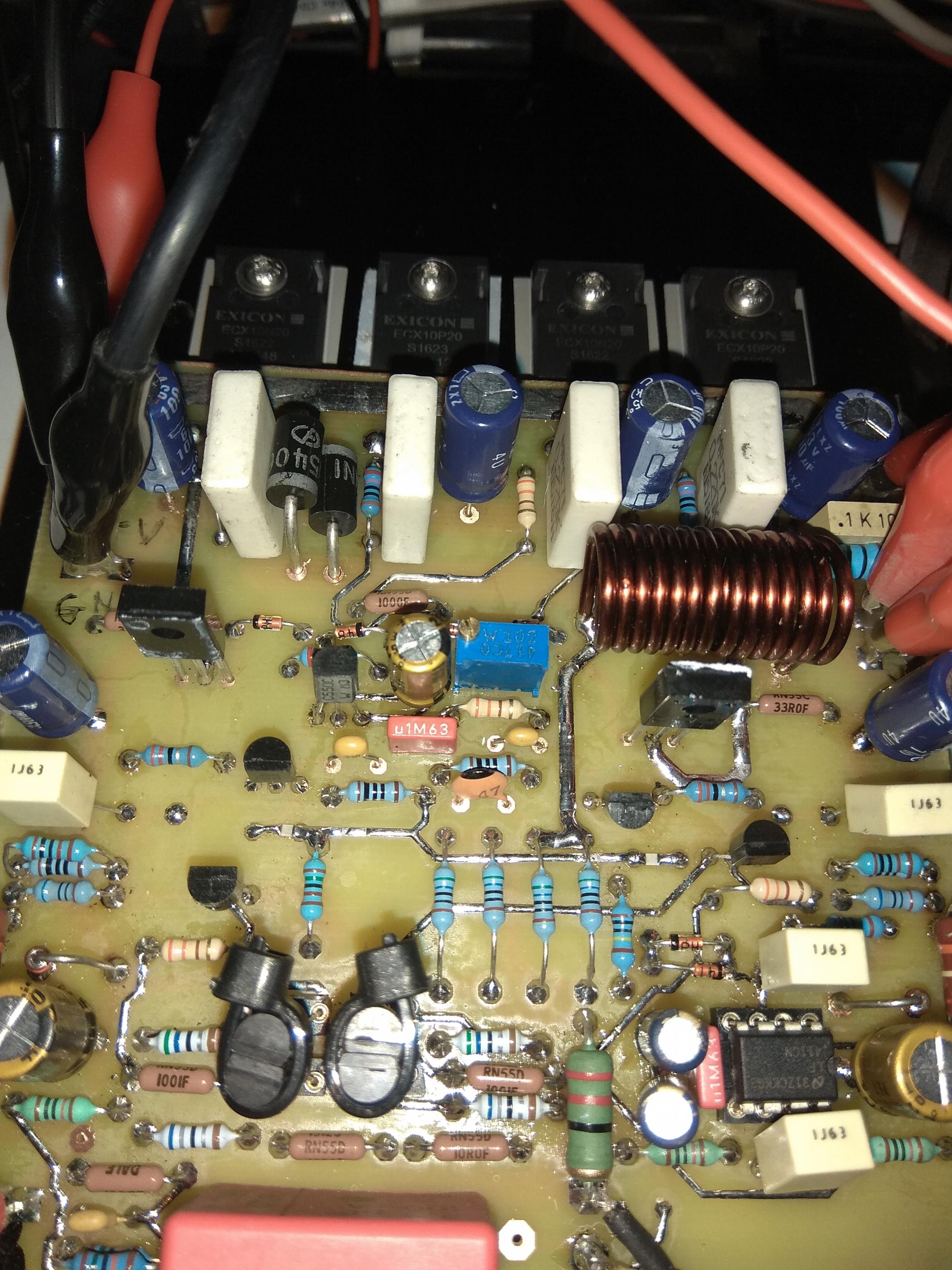

No smoke, playing but 1.5v dc at the output.
Pulling or placed offset i.c not much difference. 😕
Power supply +/-50v.
How about matching, have you done any matching?
Not at all!
I leave all the hard work to the servo!
All input transistors changed, using still unmatched but Fairchild this time.
Offset is now 700mV, servo pulled.
I think not bad..

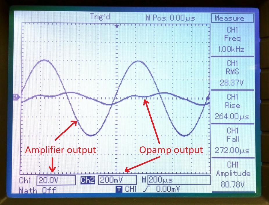

Yes, I used it in my Simpelstark amplifier with very good results.
See the schematic of one of my successful ODNF implementations attached.
I left the reference numbers as is, left from my complete schematic - never mind.
Please note:
- it is important to have C18 in place for phase correction at HF. Its value strongly depends on the Opamps type, used in the circuit. OPA2134 and 27pF are showing excellent results.
- In order to set the error detector correctly, you need to run 1KHz sine wave through the amp, connect the oscilloscope to TP2 point and rotate R26 trimmer until you see the lowest amplitude of the error signal at TP2.
Before you apply ODNF, you need to set the overall open loop gain of your amplifier to the value you like (I normally set it to 29db or so).
You can do it in two places:
1) slightly degenerating the IPS;
2) loading the VAS (R21 in my case).
I think not bad..
700mV is still quite a loot for servo.
What about +-15V, what zener resistor are you using?

I used 3k9//10k.700mV is still quite a loot for servo.
I measured - 14.9v and +15v.

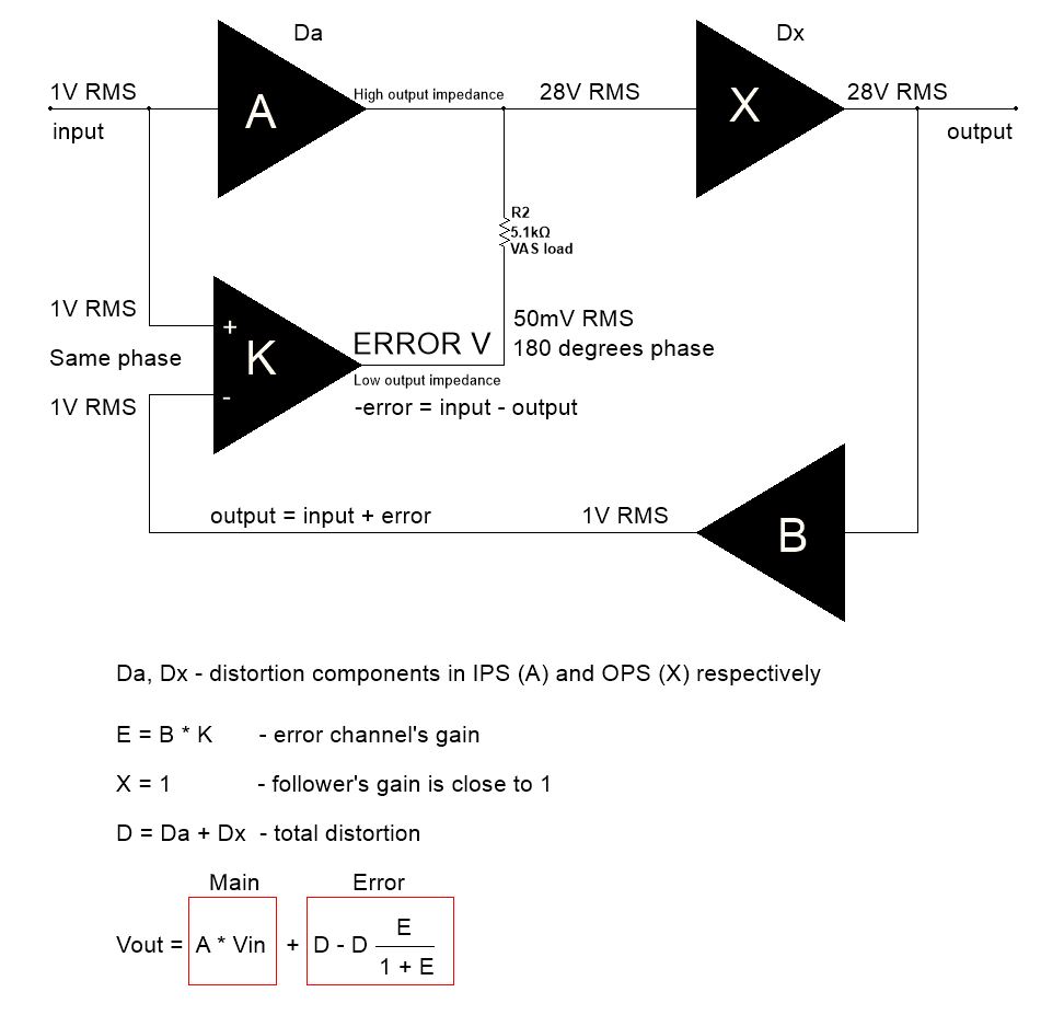

You can consider ODNF as global feedback, implemented in a special way.
It does not change the gain of your original amplifier (it adds 18db to original gain and then suppresses it back to the initial value), however, it decreases the output impedance, noise, and distortion, as the normal feedback would do, but preserving the "character" (harmonics profile, phase coherence) of the original amplifier.
It works especially well with the amplifiers having good open loop characteristics - high enough speed (bandwidth) and linearity - cleaning up the higher order components, resulting in highly natural, "live" sounding.
I used 3k9//10k.
It's 2k8 a bit tu much, and you have difference in voltage. What is DC output with DC servo in?

I'm using 3K9//10K.
Zener voltage is - 14.9v and 15v.
You answered twice the same, look my question before that post.

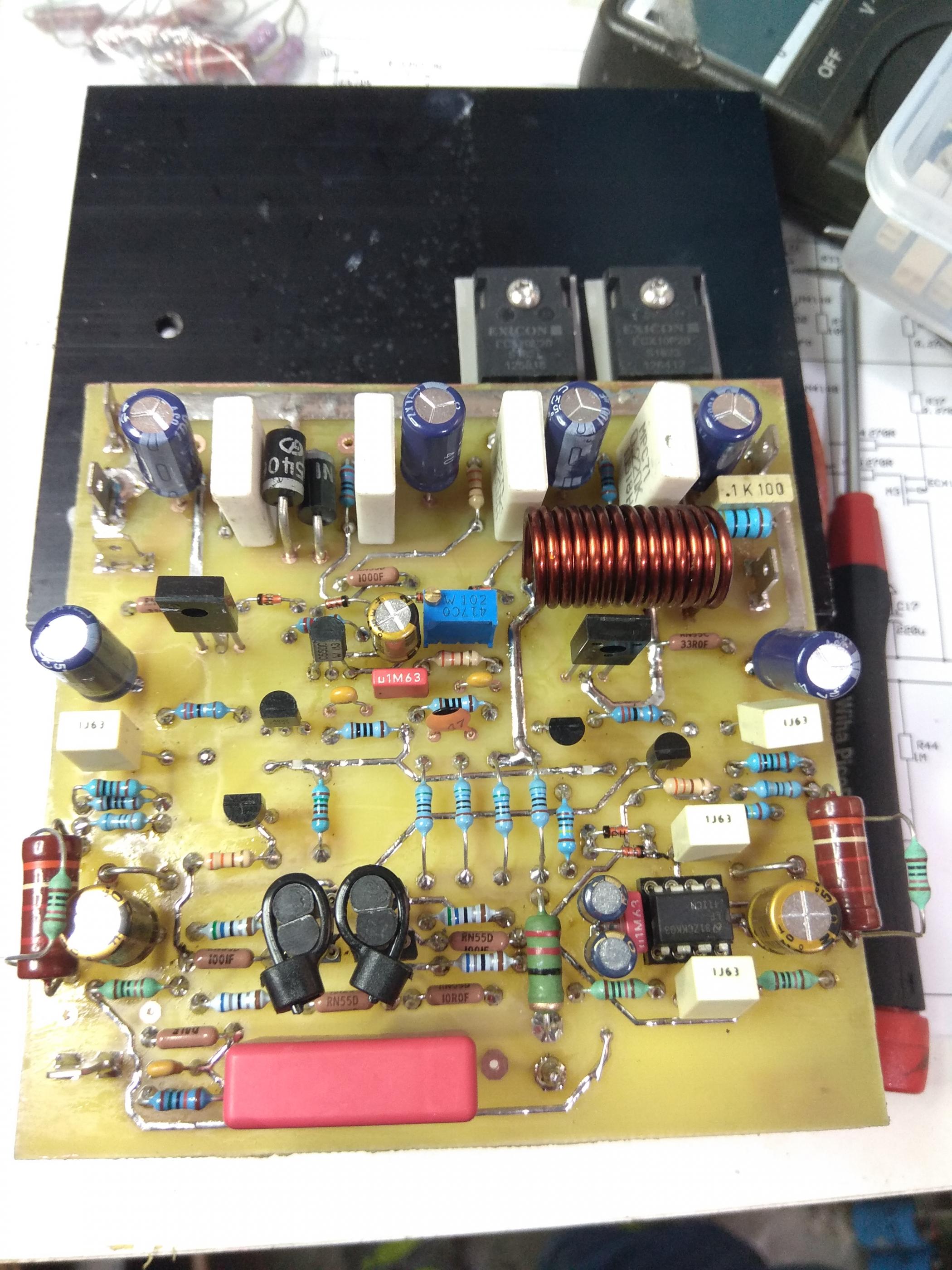

With servo in, offset is 7mV
Now all transistors are tight each other and offset using servo is 0mV.
Nice to hear that, any sound coming out?
Yes it play nicely up to now..... but now i see periodically instability.Nice to hear that, any sound coming out?
You can hear this through speaker and measured strange dc on output. It is like microphone feedback.
I think that is worst after the second pair of latfets installed or nothing to do?
Now come in my mind that testing with ARTA today morning sometimes signal jump
It could be that DC servo is straggling with to much of DC offset?
