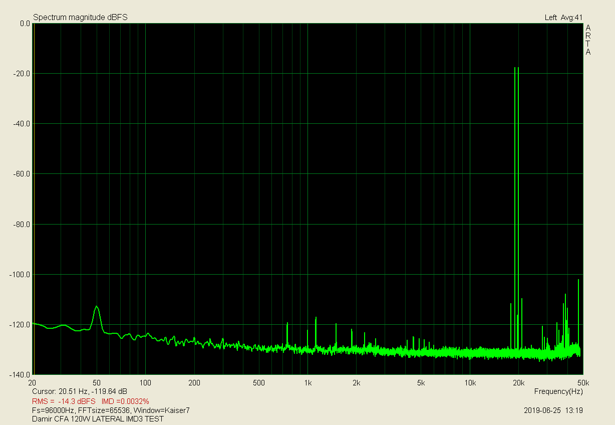

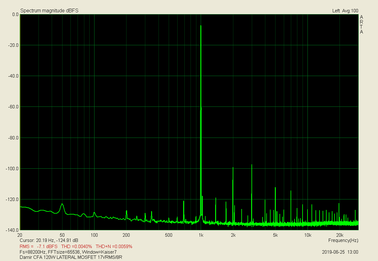

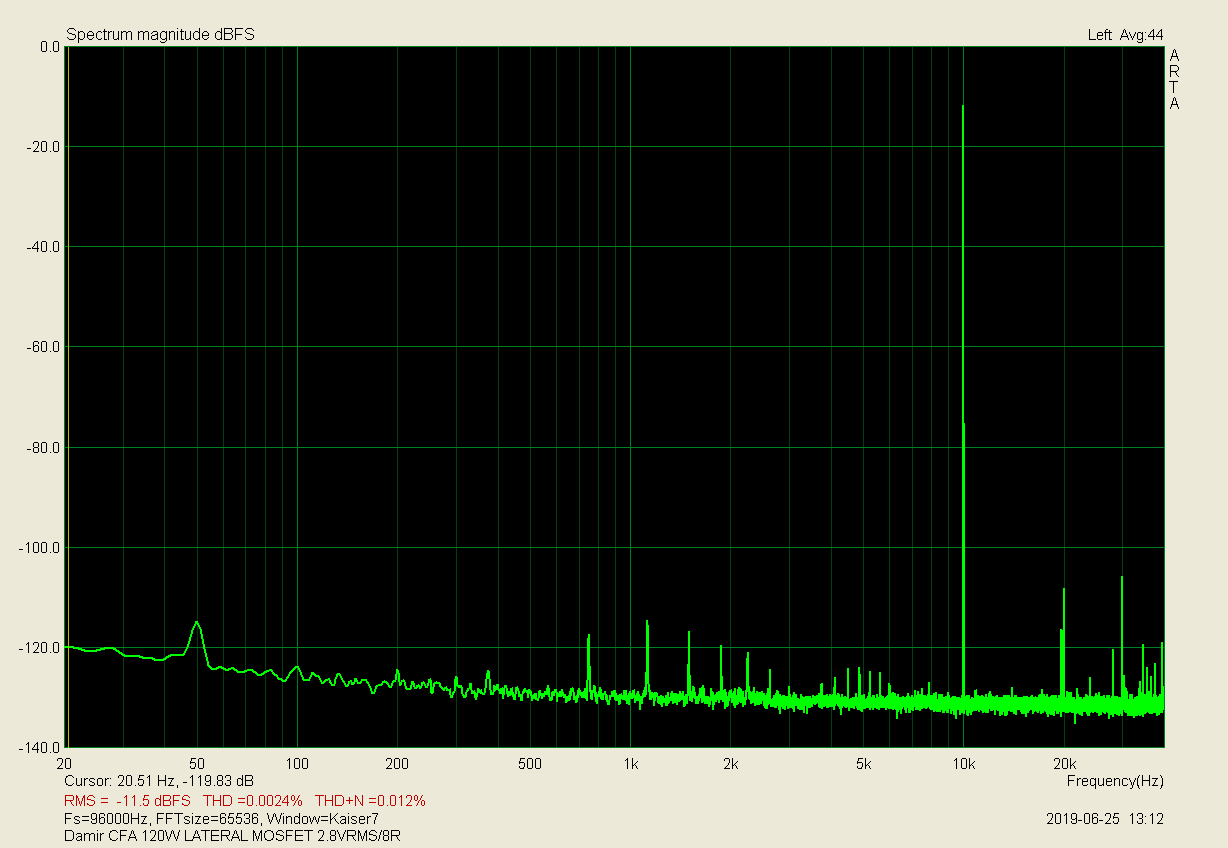

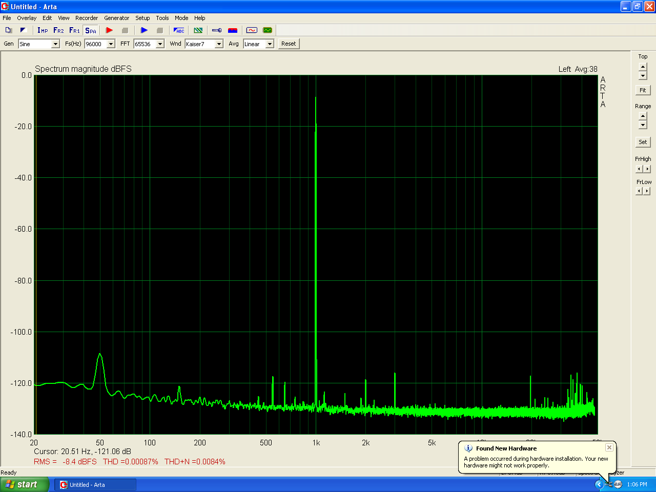

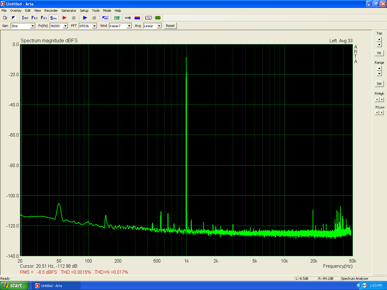

Let's see how this measured when not oscillate.
Distortion value is close enough to my sound card loop THD.
That looks good.
I think so too!

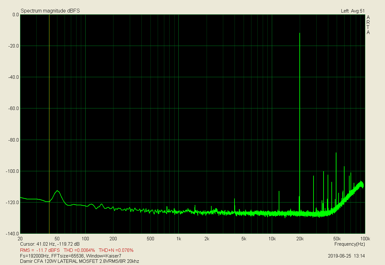

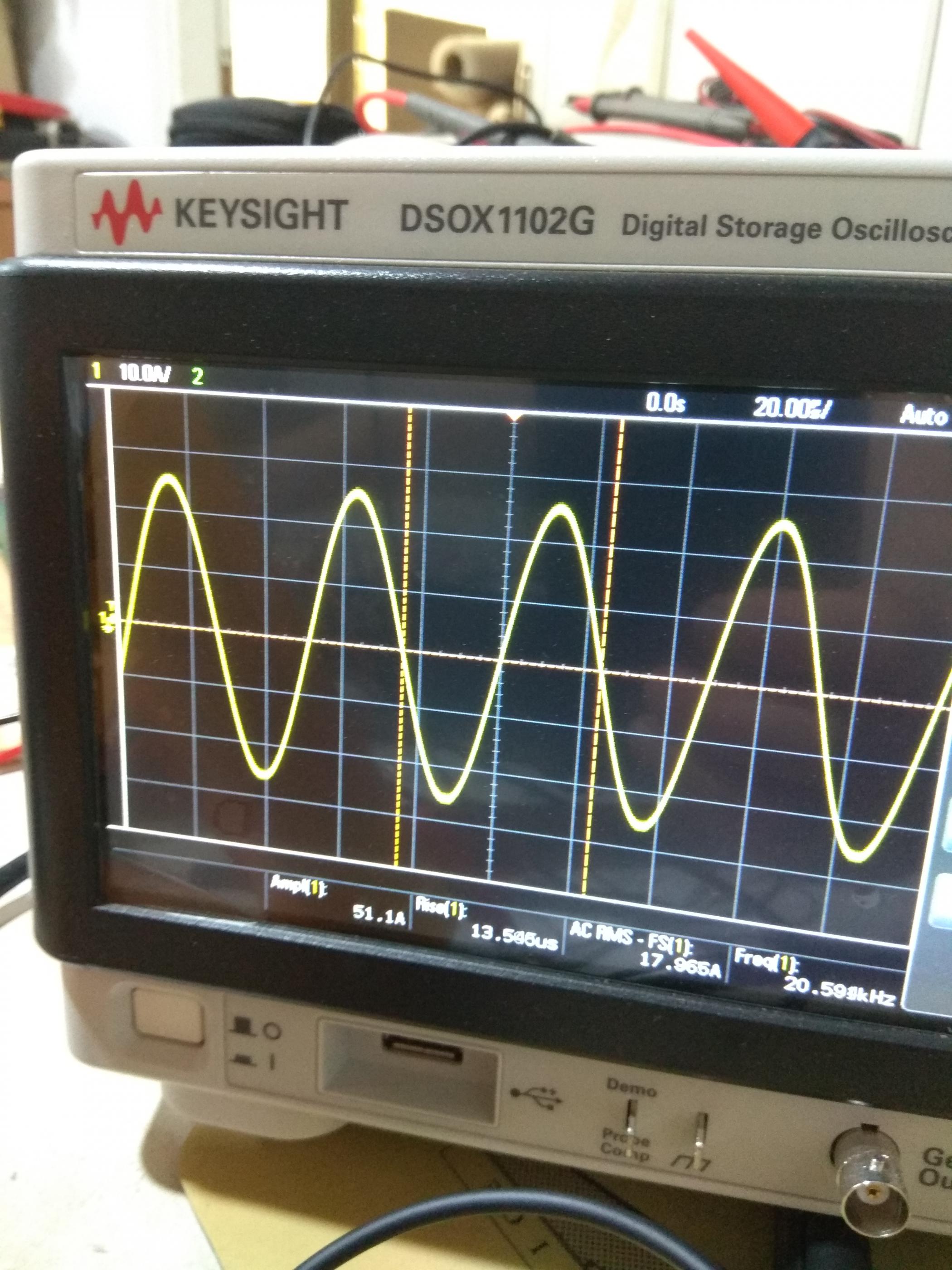

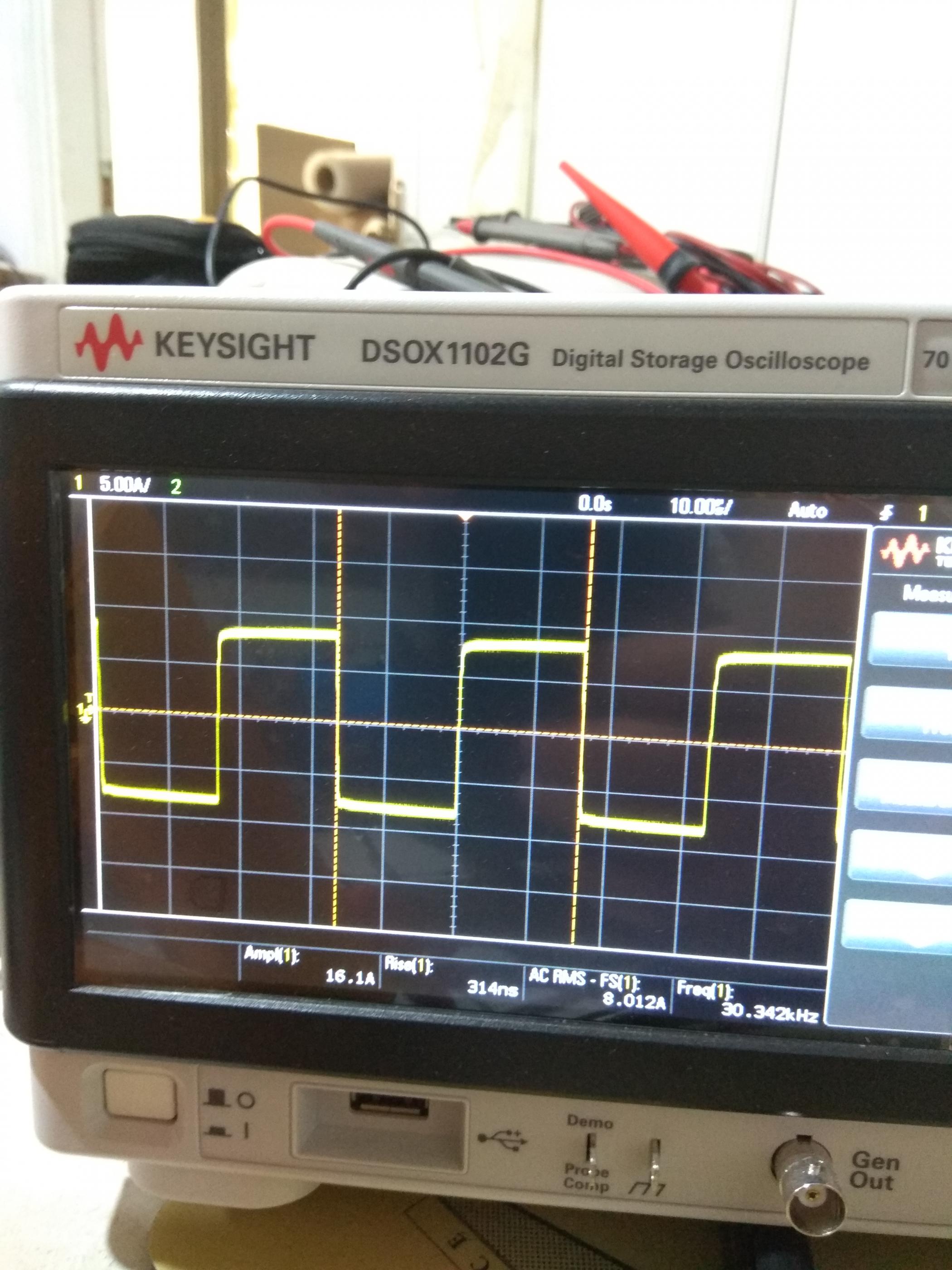

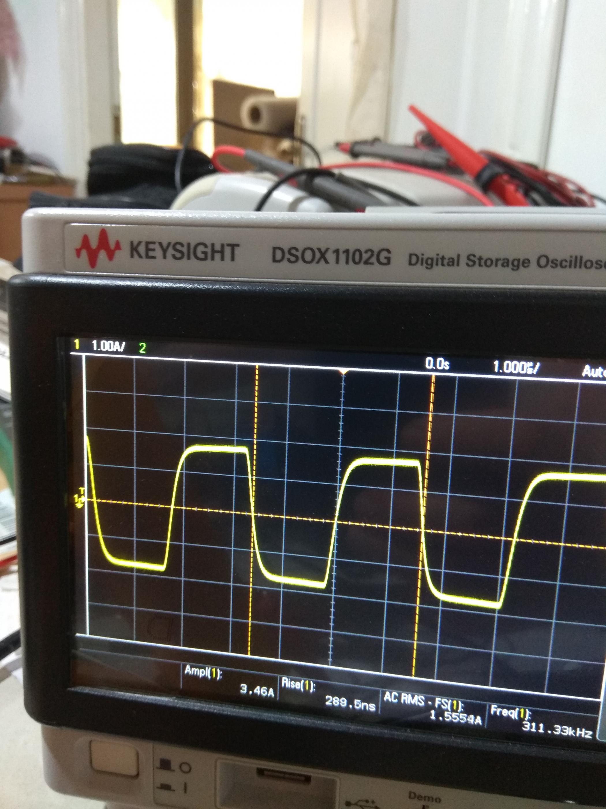

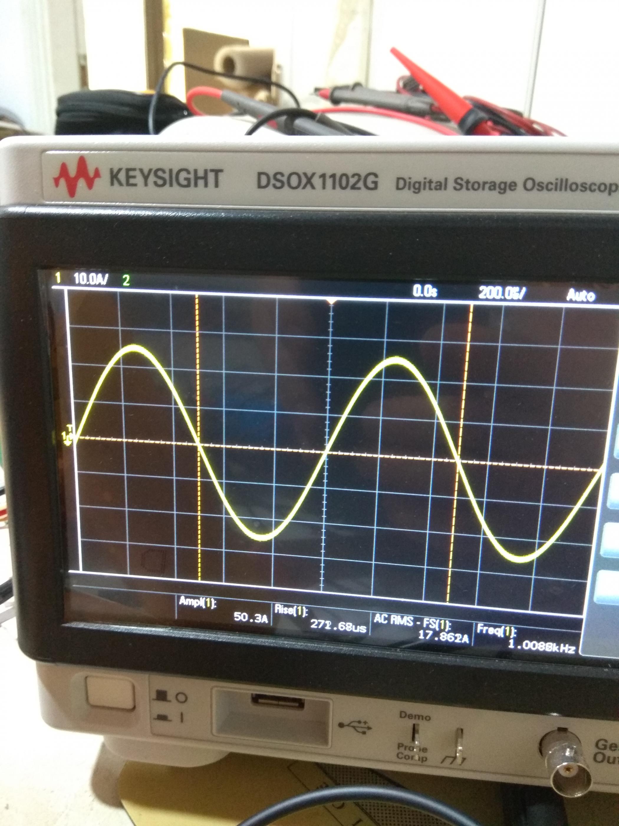

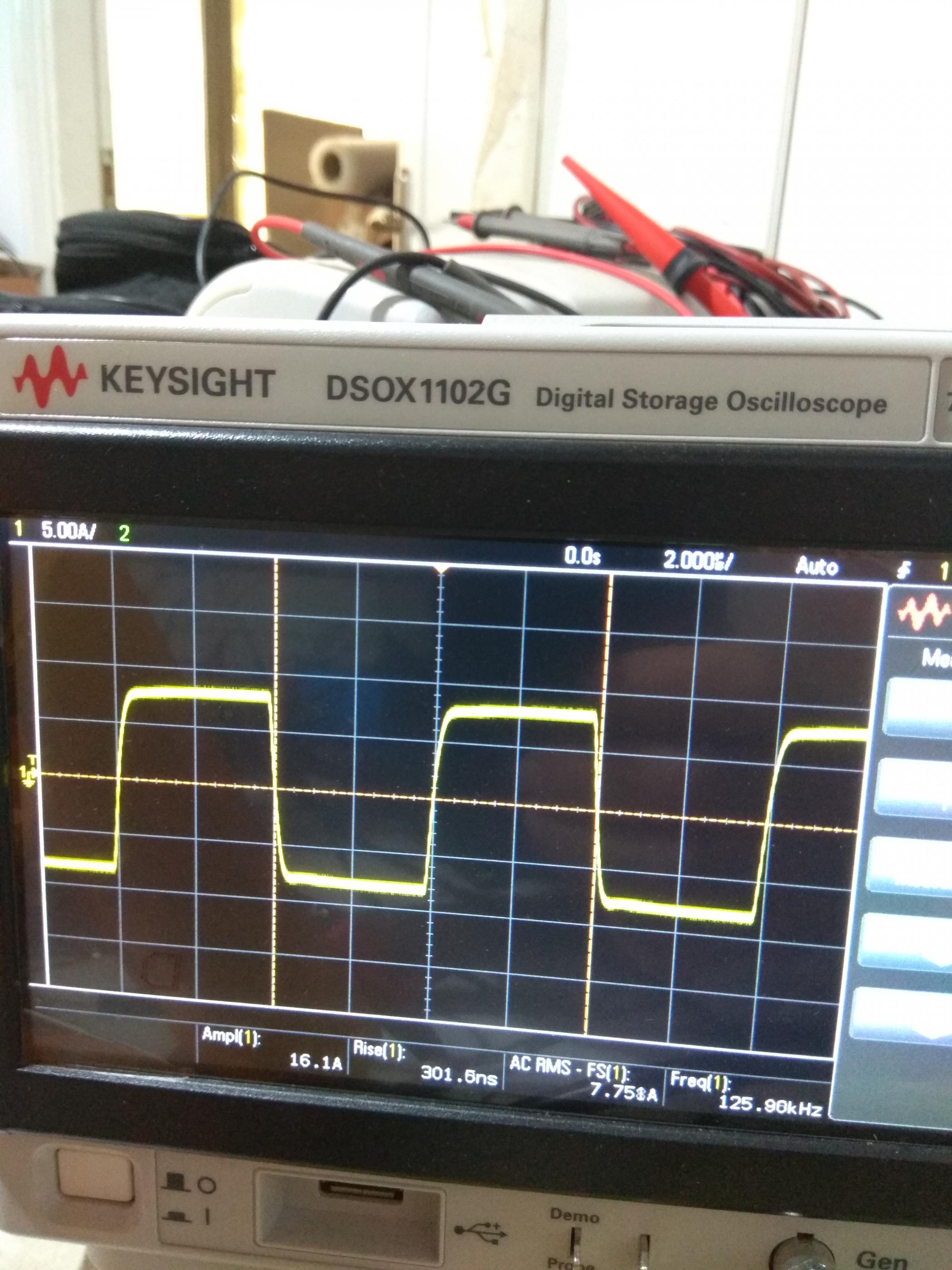

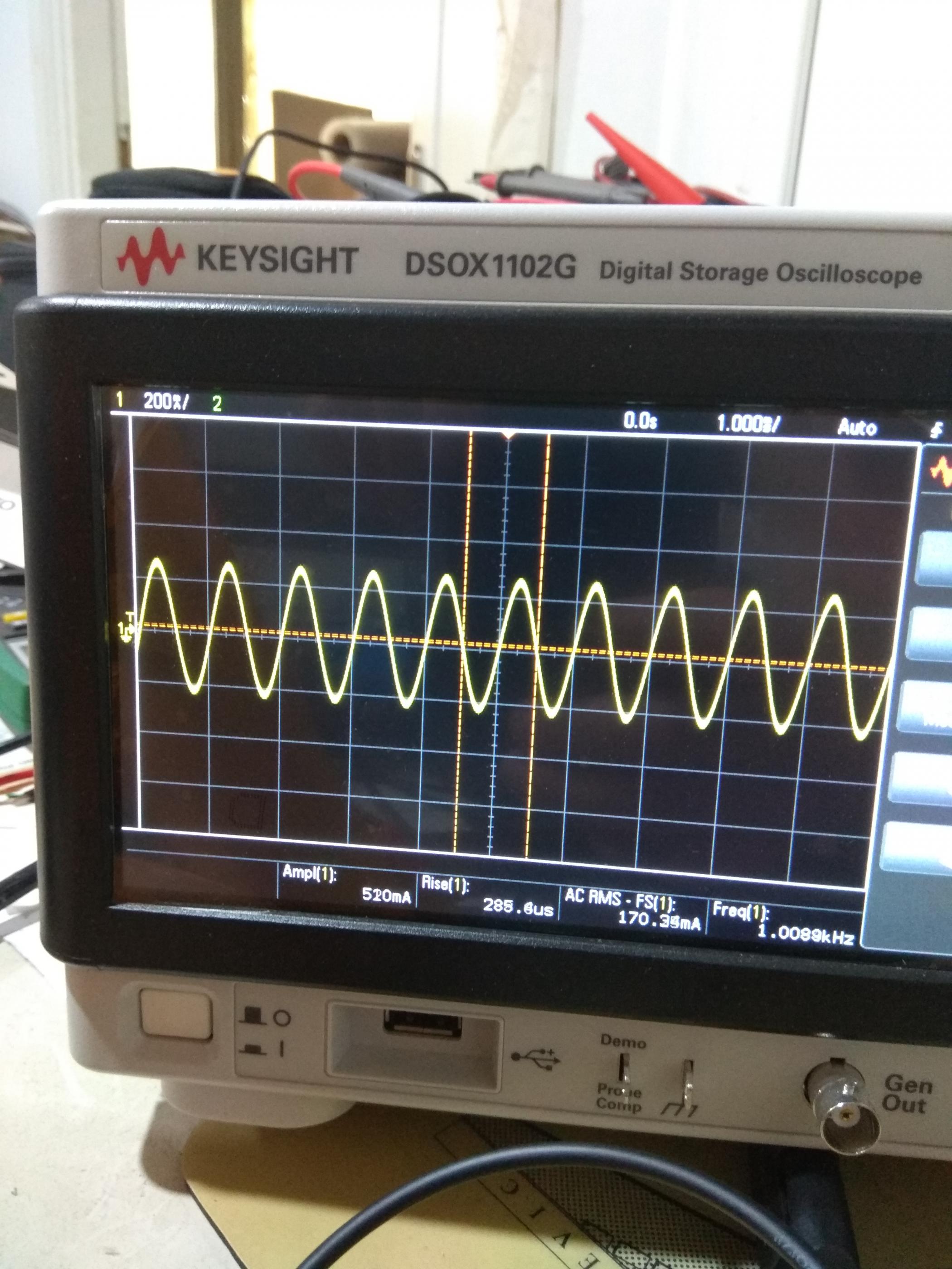

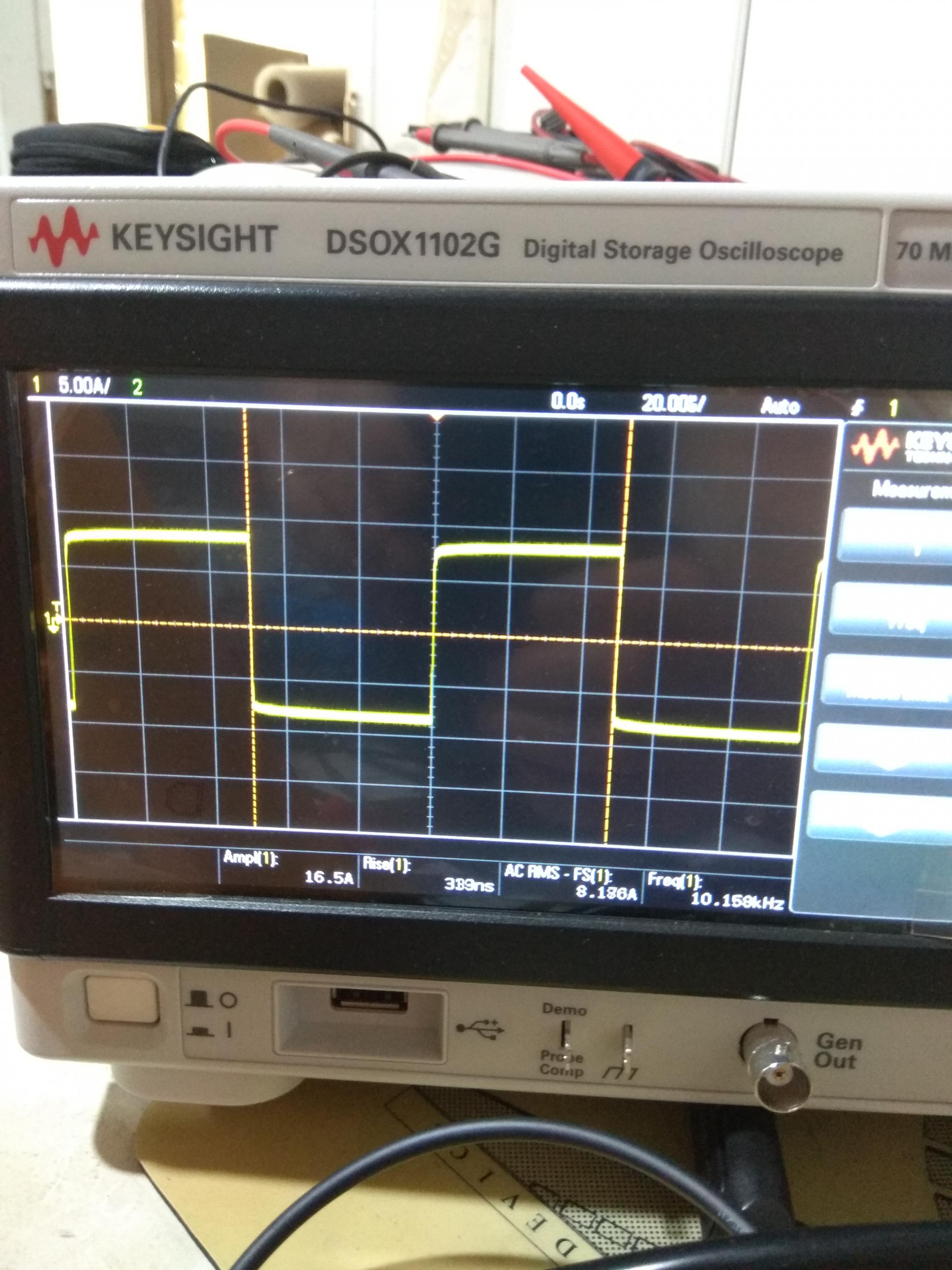

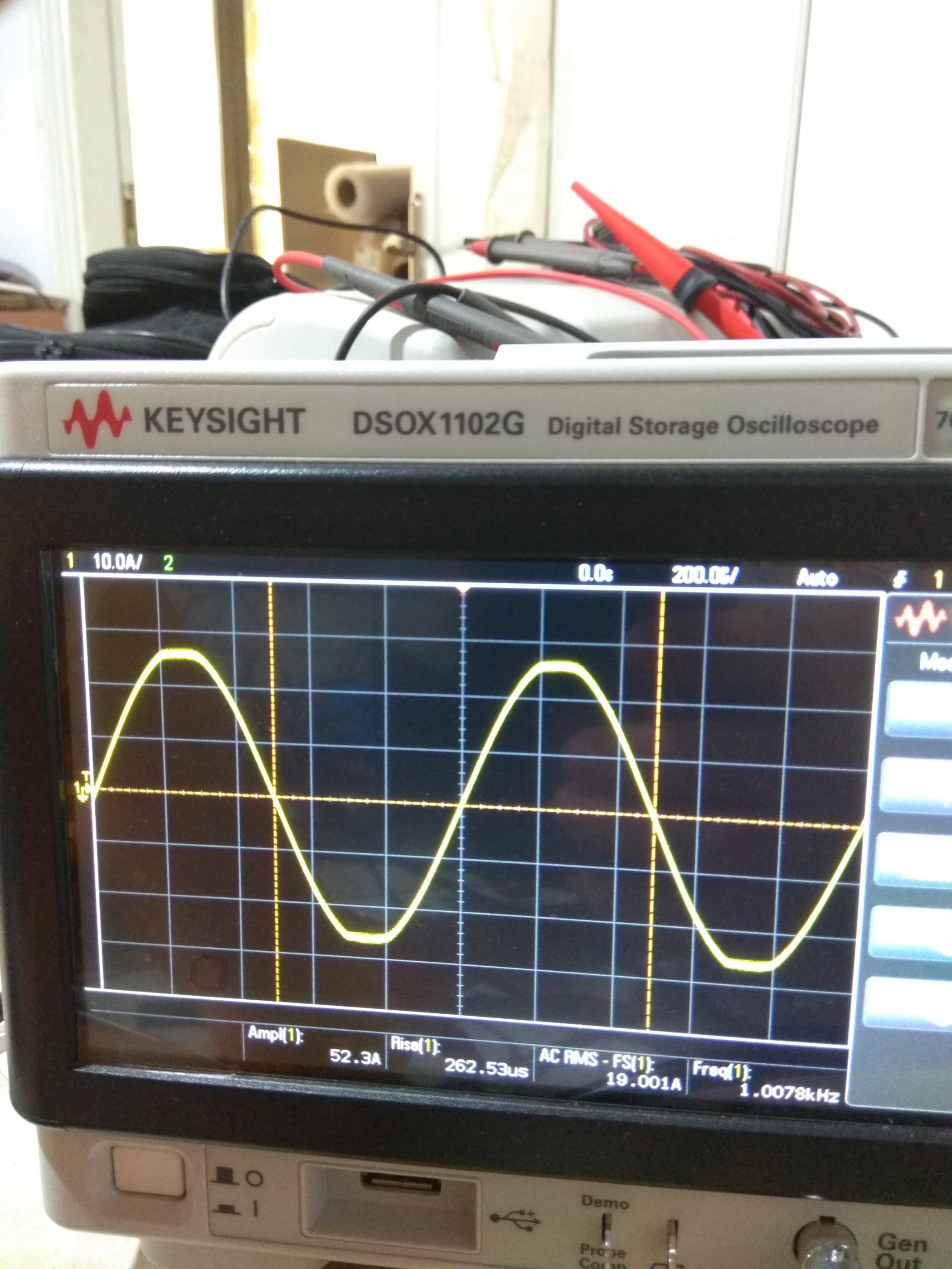

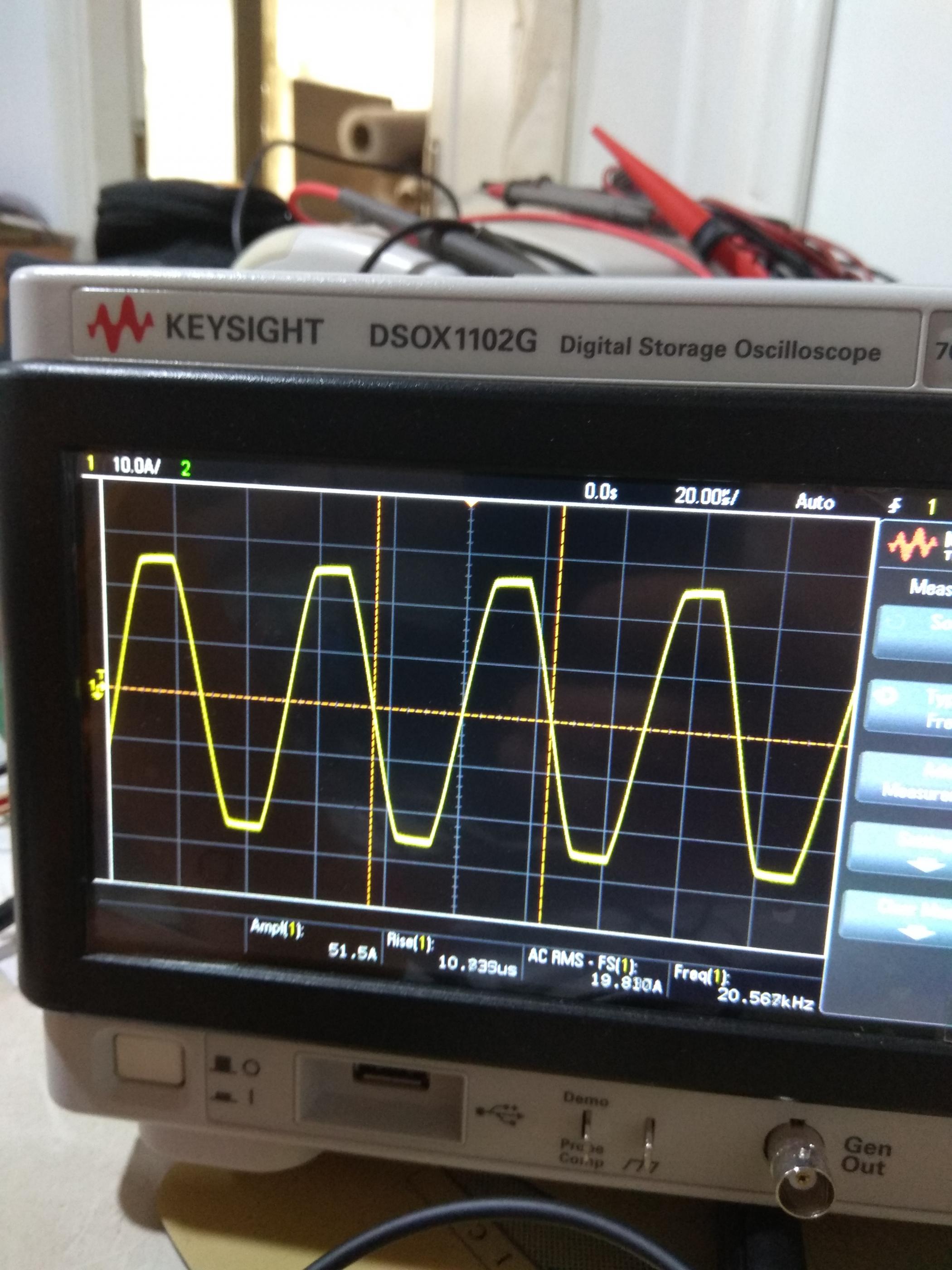

Sinusoidal test.

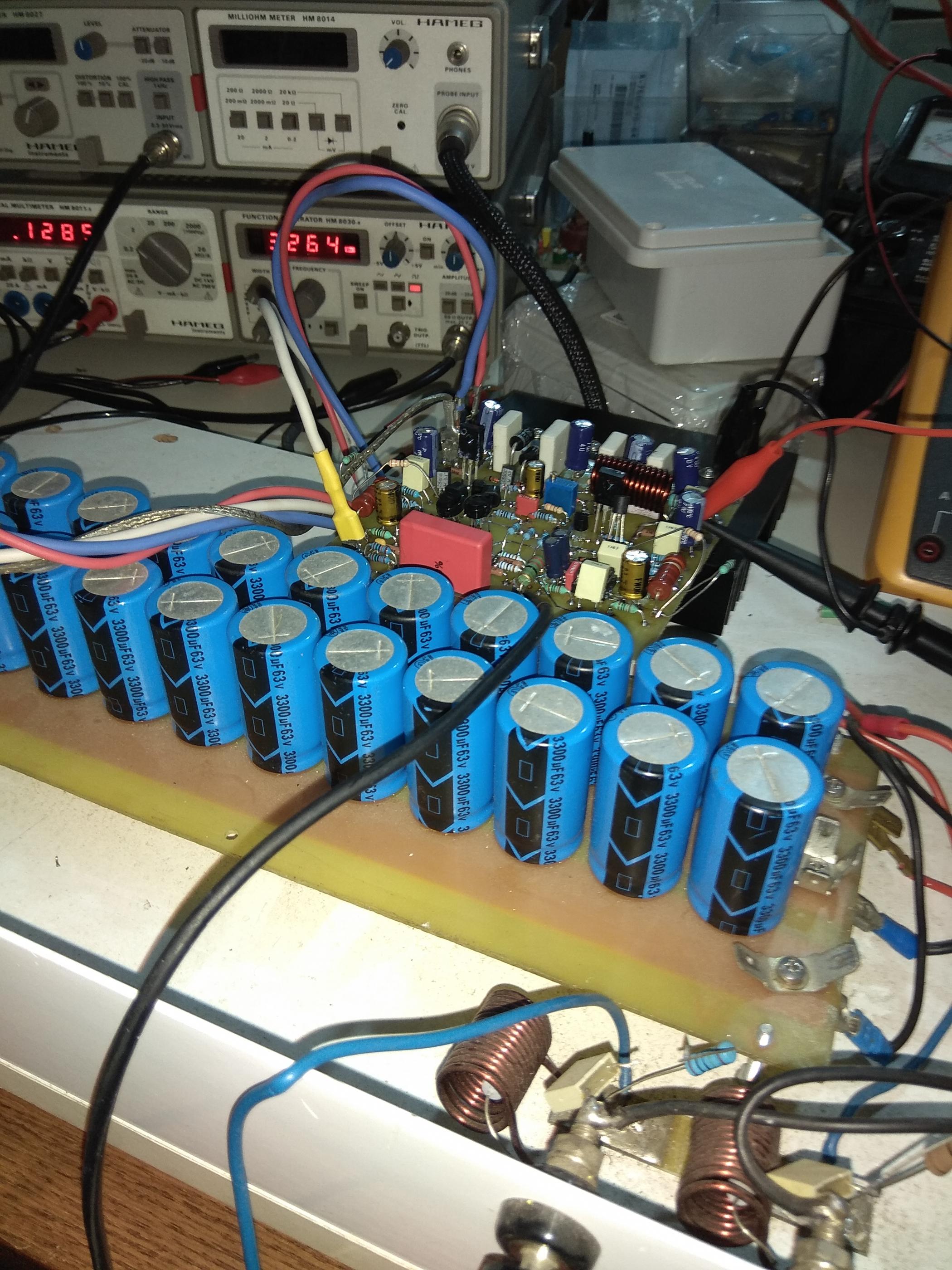

The 47pf is under the board🙂
There also, 1nf from base to gnd at the cascode but i will try to remove as no improvement when testing using +/-50v

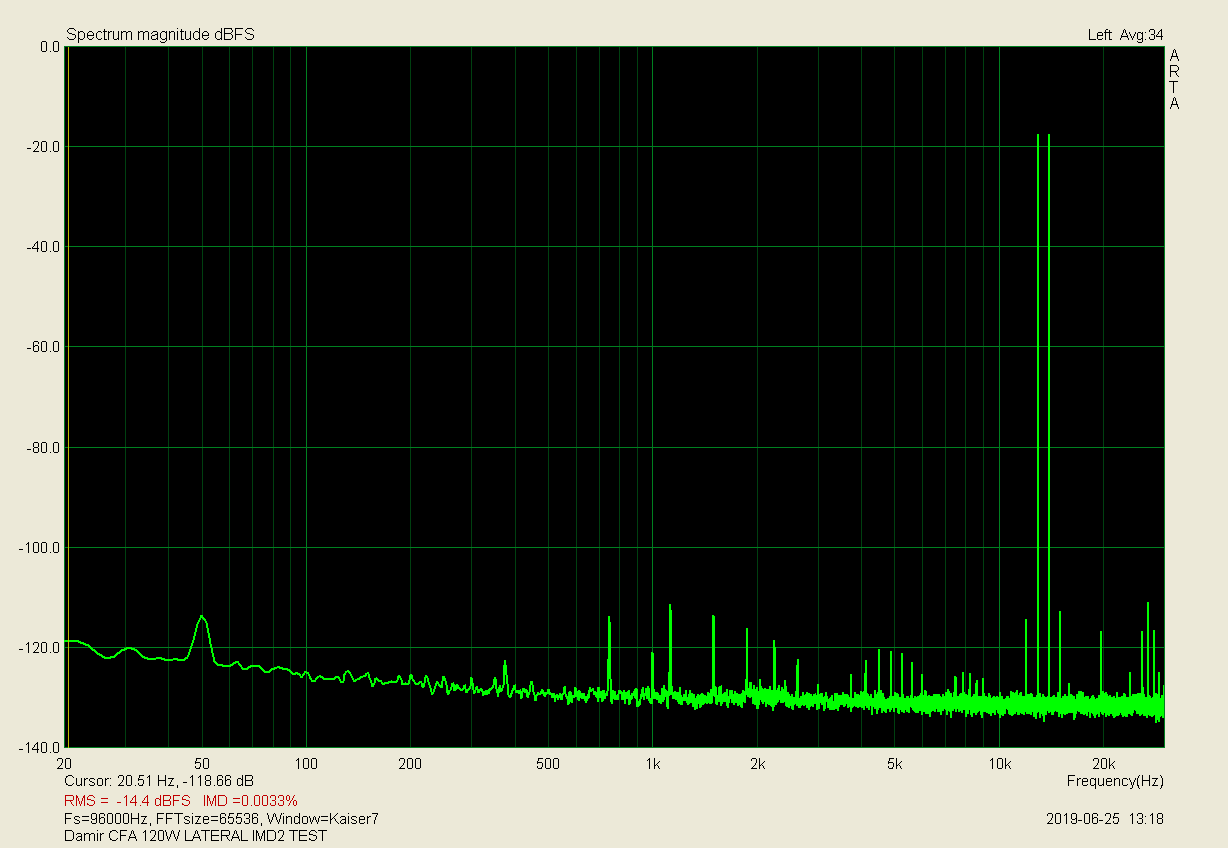

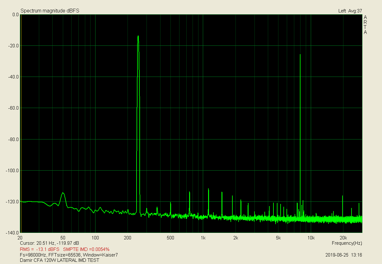

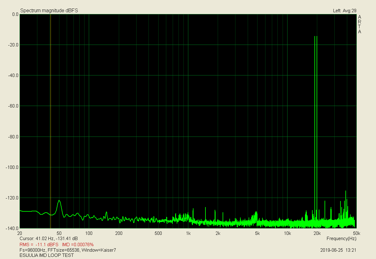

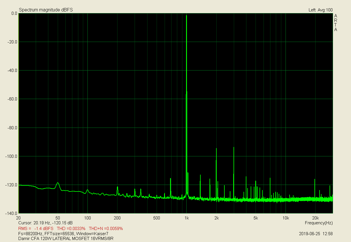

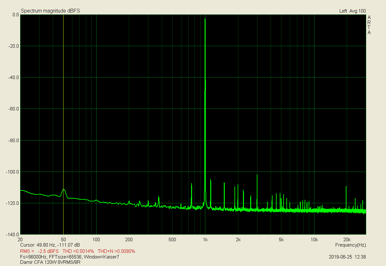

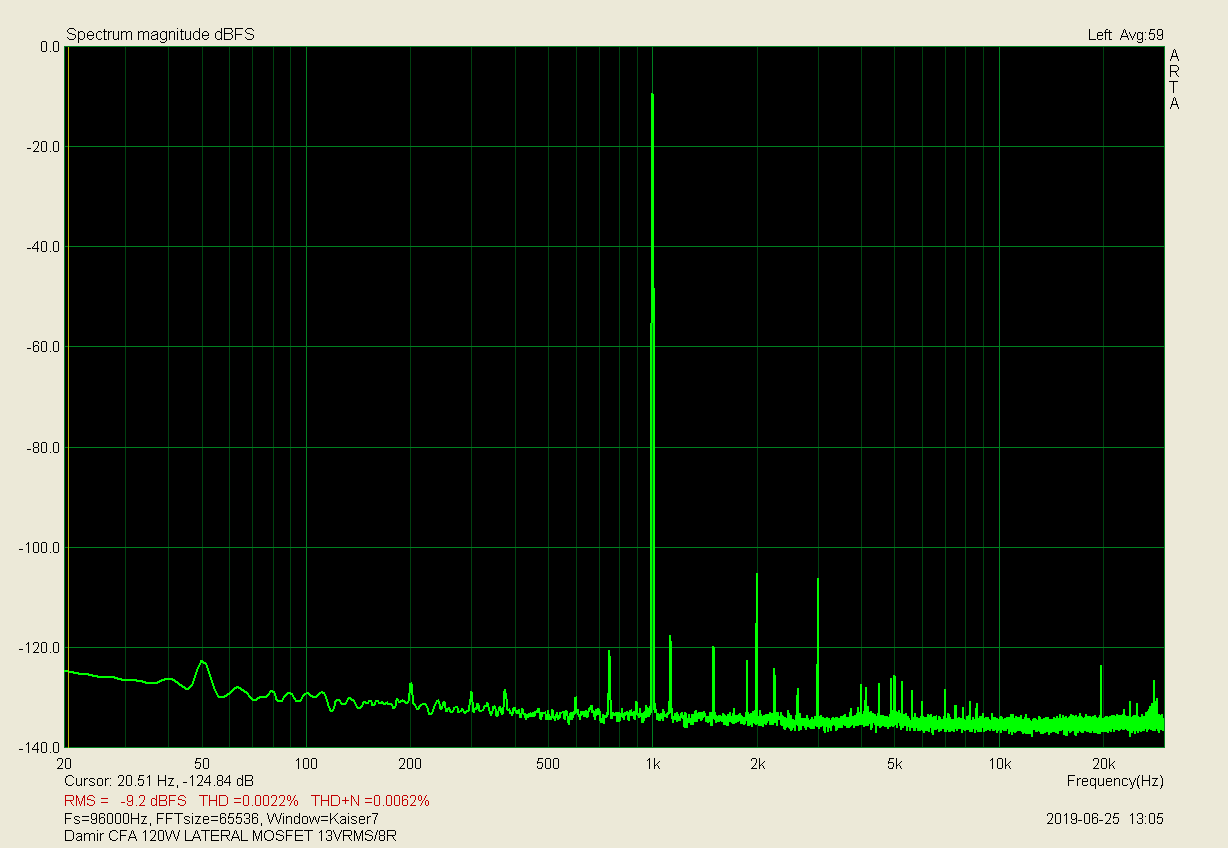

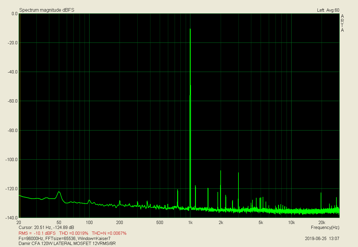

FFT analyze
+/-35v
idle=130mA
First 1,2,2,4 the sound card loop test.
