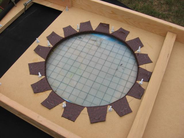

The "lizard skin" stretched around the woofer opening came out particularly well.
Paul W said:Yes it did. How did you do it?
A lot of glue, staples and patience. 4 hands make it go faster.
Basically the whole skin was stapled in place along the edges just to keep it from moving. Then a hole was cut about 8" in diameter in the middle of the woofer cut-out.
From that 16 radial cuts were made back toward the woofer-hole edge. See photo below. The flaps were pulled back around and staples in place - 1 staple per flap.
Now that the flaps were in place, we unstapled the skin edges and began gluing it to the front of the baffle. Just used ordinary carpenters glue. We spread a layer over the part we wanted to glue, and then smoothed the vinyl skin onto the baffle by hand. It was very easy to get it flat and tight.
We worked outward from the hole, section by section, until the entire face was done. Then we flipped the baffle face down and tightened the flaps.
In that step, working flap by flap, I pulled out the staple, put glue on the back of the flap then pulled it tight. 2 new staples were applied to keep it tight. Then repeat on the next flap and the next and the next. 16 times. This gave a very tight, smooth skin around the hole. See the detail in the next post. BTW, the hole had been rounded over with a router bit from both sides. You could also do that by hand with sandpaper.

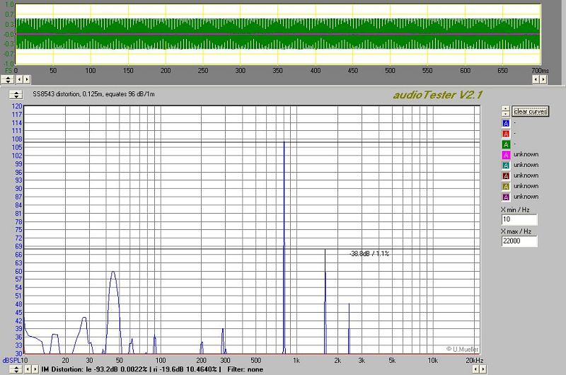

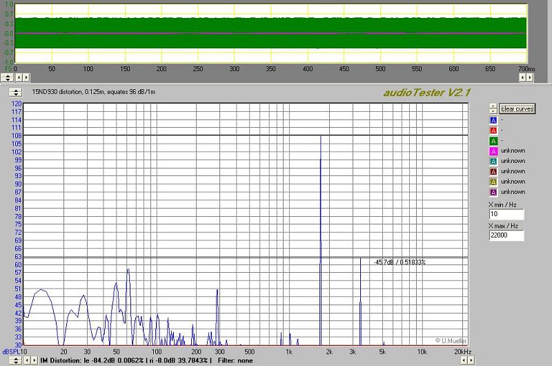

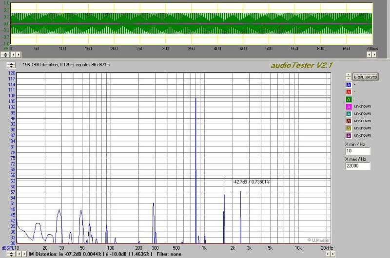

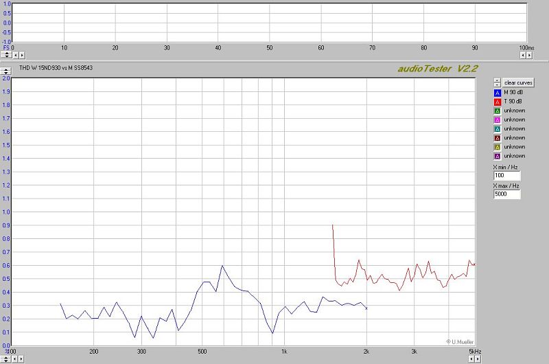

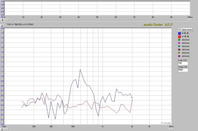

Well, I hope I don't bore you guys but I think it fits into the "large midrange for open baffle" theme: I did some more measurements to answer the question, is it rationally defensible to use a 15" pro driver for a mid rather than a 6.5" high quality hifi driver? Subjective likability is very positive, but how about data?
So I checked for distortion at equal output. Simple measurements, SPL calibration is only approximate, and of course at same SPL the 15" has much less work to do so it may seem unfair - but the question to me is on final result at equal output, not on comparing technical ingenuity.
It looks like there really is no replacement for displacement. The 15ND930 mostly wins against the SS8543, already a very low distortion driver and surprisingly, it holds up very well into treble territory.
Attached is a comparison sweep 150-2000 Hz, 15ND930 red, SS8543 blue, at an SPL equivalent to 96 dB/1m but measured at ca. 5". I am at a loss wrt the large peak in the 600 Hz range for the SS8543, I suspect a mounting hardware buzz or possibly the metal grille that I mounted in front of it, in other words an artefact. The 15ND930 is remarkable in its constant ca. 0.5% distortion figure over such a wide bandwidth - those demodulation rings seem to work rather well. In absolute terms distortion is very low for such a high level anyway, for both drivers. Level tests show that for both drivers, THD rises monotonically for all frequencies equally, when you increase levels. While at 96dB both drivers hover at the 0.5-0.6% level, at 90 dB they drop to ca. 0.2-0.3% (not shown).
And I also wanted to see the distortion spectrum, especially since I was puzzled that THD should be so relatively constant over the bandwidth. But the actual spectrum was consistent with the sweep. For example, here is the 15ND930 at 800 Hz/96dB/1m (ignore the IMD text at the bottom, I did not set the parameters necessary to make the IMD part meaningful)
Interestingly, or sadly, even at reasonable SPLs the tweeter (Seas 27TBFCG) is no match THD wise to either woofers. I am somehow confused by this, but the numbers correspond roughly to Zaph's results for this tweeter at same SPL, 0.5% or about -46 dB at 90dB/1m. Any higher in level and you go to 1 or 2% real quick. Attached the SS8543 sweep and the overlapping 27TBFCG sweep.
Energy storage and thus, transparency, is another can or worms of course. But subjectively it doesn't seem to be an issue, quite the contrary. Dispersion aside, which is extended by dipole application, there seems to be no penalty in running a good 15" well into kHz range, as compared to a typical sized mid.

Yes... I don't know if I should be pleased to come to similar conclusions as some more highly qualified people than me, or feel silly about it. OTOH - it's not quite the same. Dipole would have a greatly improved power response vs. f wrt the Summa, and I am also not so sure about Geddes' rationale for eliminating side reflections by designin for off axis listening. The x-0 xould be as high as 1.2 or 1.3k. And yes, the waveguide is the challenge. Have since found a spreadsheet for oblate spheroid contour, and an article describing Peavey quadratic. A quadratic equation produces a parabola, and we all know that these are used in reflectors, in other words, this should be a theoretically ideal profile to make sure any waves are always reflected to a path parallel to the axis (hence no production of the HOM that Geddes is concerned about).
I do wonder about the loading though - a "perfect" match to a dipole would require a 120 degree coverage (-6 dB at 60 degrees, like a dipole). This is very shallow, and for power reasons it might not be enough loading for a 1" compression driver. Now, I suspect any difference between Peavey quadratic and OS might lie in which part of reality is deemed "negligible", but the quadratic seems to be a tad deeper, so maybe this should be tried first.
The distortion measurements are primitive for now, to get a first guess. Audiotester can not generate, or import for that matter, multi tones or tone bursts, so no SL style HD and linear decay measurements. It can do dual tones for IMD however, I'll start playing with that at some point, and regular CSD of course, with all its windowing artefacts. What is the software you are using, Paul?
Ah, just realized the Peavey quadratic is quadratic in its area expansion, not in its flare profile (which is just a circular arc mated to a conical section). Funny how such extremely simple things can be made to appear complex.
