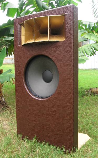

I have a big midrange OB project going. The mid is really big -18"! OK, it's a horn. Altec 811 with 806 driver.
Just going to be a 2 way to start. Bottom end is the Selenium 15PW3. A mid Q pro woofer. Should be great for OB. It has a very nice tone and pretty good midrange played fullrange. Nothing as fancy or lovely as your 18 Sound beauties, but a nice driver none the less.
Crossover and shelving filters will be active, at least in the begining.
Can't work on them today - rain. Should be up and running in a few days, rain willing.

Anxious to hear more about your experiences here, any updates from those of you experimenting with 18sound drivers large and small (well smaller I guess, as a 10" mid is still a large mid cone driver in relative terms...).
I am personally thinking about a three way active:
BMS 45552 with DDS Eng 90 for the top end (roughly 1400hz and up...)
Eighteensound 10NDA520 for the mid (maybe 200-1400hz)
TBD Pro Sound driver running in open box dipole of some sort (40-200hz) with a single sub handling the combined L/R from 40hz on down.
I am looking for more feedback on the 10NDA520 before I pull the trigger, and I am also wondering if those of you experimenting thus far have an opinion on digital versus analog active crossover. I am tempted to just bite the bullet and go digital, with a DEQX or PC based solution, but I am also a vinyl nut and thinking about tube amps, and considering Marchand line level passive components built into a preamp or each power amp. The big issue I think is the time alignment that digital offers but maybe there are other things to consider as well. Of course the flexibility of the digital stuff is unsurpassed, but the idea of a pure analog system is alluring to me as well. Any thoughts? Is it tough to get a good phase relationship between the mid cone and the waveguide or do their acoustic centers appear to be close enough for decent analog crossover work?
And finally, for those of you running 12s and 15s open baffle, if you could have any pro driver in the world for the job, running it 40-200Hz (maybe even with a little eq around 40-60hz to help out), what would you pick?

panomaniac,
Please post a picture or two when you have the system together! As a youngster, my very first exposure to good sound was a big Altec system in one of the grand old theaters in Chicago. My dad later said that's all I talked about for two weeks!
Greg,
It seems like you are headed almost exactly the same from 200Hz up. I first tried the 4552/DDS at 1,100, but the WG doesn't seem to hold pattern control low enough...so XO is 1,500 at the moment. Low XO is at 175-200.
So far, my only "complaint" about the 520 is that the basket assembly (probably reused from a ceramic driver) casts a fairly large shadow over the back of the cone. When I'm done experimenting with waveguides, I'll move on to the mid as it appears it might benefit from some felt strips or some other treatment on the frame around the spider. Response is fairly smooth as-is...EQ is primarily for the baffle, not the driver. I did a very quick HD check with and without the AIC and found about a 10db distortion improvement with the AIC...didn't expect anything nearly that good.
For crossover, I still have a warm spot for analog, but digital seems much more practical, especially when it comes to EQ. EQing the mid is no big deal, but the compression driver/WG/baffle is a different animal...in one spot, the DCX takes out a 1.5db bump with a Q of about 8 which would be tricky with analog.
With the mid mounted to the rear of a 3/4" baffle, WG to the front, there is almost no acoustic offset between the mid and tweeter. DCX time offset is almost nil. Of course there is a several inch offset to the woofer.
Don't know which 12-15" woofers would be best (why 12?) but I'd start the search with BMS and 18sound.

Thanks MBK! I do like how they look. The "lizard skin" stretched around the woofer opening came out particularly well.
Still need to paint the backs and foot plates - and the horns, they are a bit dinged up on the edges. Wings will come later. BTW, they look absolutely huge in my small living room.
I will post more details later, maybe in a separate thread.
