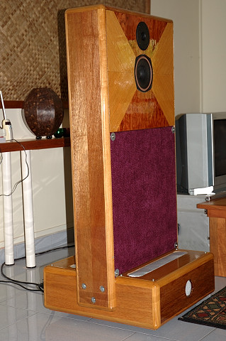

FYI here is a photo of a previous incarnation of my OB's, then with a Diatone fullrange. The form factor has remained the same.

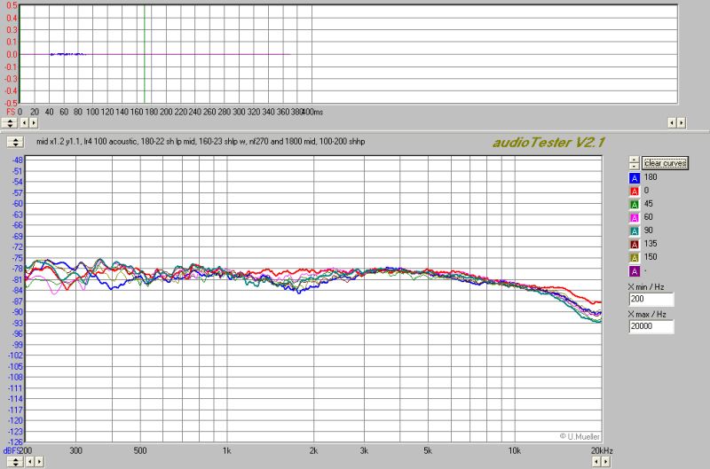

On the dipole midbass..
I agree MBK - its a balancing act between "punch" and proper image placement. I have found however that high force driver compensates for this ..to an extent. ALSO, (..similarly to what you have suggested - only in the inverse), IF you use a cardiod "sub" or a monopole "sub" with a 1st order high pass - it tends to add-in the "punch" without messing up the possitive qualities of the midbass dipole.
So I did a full 180 degree measurement of my OB's with all filters and x-o's in place. I used 1.2 m distance (4 ft) in the hope that all baffle effects would show up. Unfortunately the results are inconclusive - there must be too much wall bounce adding sound where there shouldn't be any. Everything is in a 6 db range from 200 Hz up (below that no hope with this setup, and even here the floor bounce already shows). Even the monopole tweeter is just 3 dB down at 20k ... ... at 180 degrees (!). Any other wiggles might just be due to variations in wall bounce when rotating the speaker. See exhibited FR graph. 0, 90 and 180 degrees in bold.
On the bright sides:
- I now got a rotating platform I made for the purpose, to repeat the same thing outdoors some time at 2 am when traffic quiets down 🙄
- if I take the graphs as a token of power response / in-room balance, this actually IS a good result.
Scott:
this is actually what I meant. I should write shorter posts, for clarity :angel:
