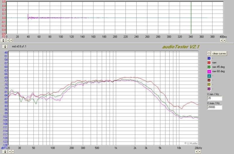

Just because it seems to fit in here - dispersion pattern of my ca. 48H 24W 7.5D (inches) shallow U-frame. Driver is a SS8543 (6.5"); data are without filters, the rolloff is due to low Q plus dipole effect. With hindsight the active impedance 18Sound 10" would have fit in here nicely.
Purpose of my post though is just to show the off axis response of such a baffle, I expected more dipole like behavior until up high but it seems it went towards cardioid in the mids w/o even trying. Back of the baffle completely open, no stuffing.
Yours doesn't seem to hit actual dipole behaviour until about 230 Hz. The freq. response from 500 to 1 kHz is effectivly omni (in the forward plane) and only starts into a cardoid response above 1 kHz - strictly due to the dispersion character of the driver.

I should add some caveats to my above data: in-room and closer to the baffle than I would like (80 cm or 32") for such a large baffle - the full baffle effects likely don't show up this close for the higher wavelengths since the rear-to mic distance is considerably longer than the front-to mic distance.
Agree on the dispersion above 1k. But even a cardioid would be failry omni in the +-60 degree range. I should complement this to a complete 180 degree polar view.

If you are doing more measurements, a full 360 degrees would be quite interesting.
I'd love to comply... but I have to find a cleaner setup to get truly trustworthy data. Indoors and without suspending the speaker, any measurement beyond 32" / 80 cm or so, becomes increasingly haggard due to room effects and especially, floor bounce. But 80 cm is too small to fully account for the baffle effects - at 80 cm front-to-mic distance the rear wave travels a full 80 cm farther than the front wave, which means it is 6 dB down.
