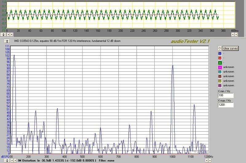

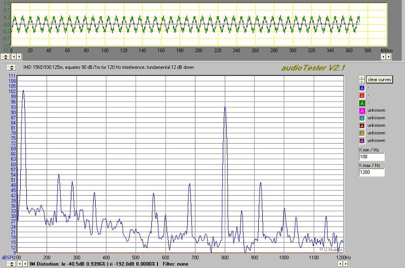

BTW so I did an IMD comparison between 15ND930 and SS8543. I didn't quite know what to choose but thought, 120 Hz is more useful than the usual 60 Hz because it is present both as hum and as music. Else I went with default, i.e. the interference signal is a full 12 dB louder than the test signal (400, 800 or 1000 Hz). I think it's tough test anyway. Result is again, no replacement for displacement. At 90 dB/1m interference signal and 78 dB for the test signal, the 15ND930 was slightly better in all cases, both hovering at 0.9-1.2% IMD or so. But at any higher levels, IMD for the smaller woofer could easily jump to 5%.

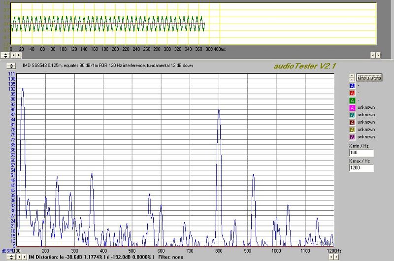

Here is the SS8543 at 800 Hz.

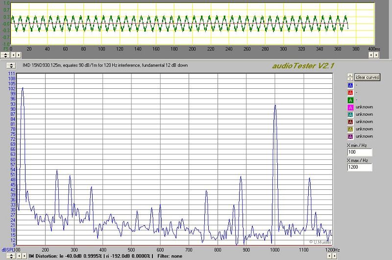

Yes, I have. The nearfield FR 15ND930 starts showing aberrations starting at 1.2k so I kept the highest test at 1000 Hz, attached.
(The farfield is OK until ca. 1.5k when the breakup takes off and I would think 1.2-1.3k XO is feasible, but the testing is harder to do there because farfield introduces a lot of "special effects" so I kept it at 1k).
SS8543.
Bottom line is that IMD just like THD for both drivers is fairly constant over a wide range, and depends mainly on level. And here the 8543 suffers first, and in IMD more severely, than the 15ND930.
