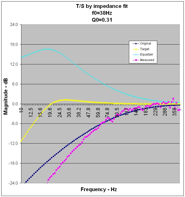

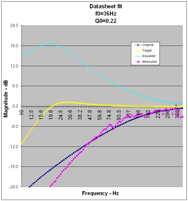

When I integrated the 15ND930 to my system, I expected to do a dipole EQ and a simple shelving lowpass driver EQ to compensate for low Q driver rolloff. The dipole EQ was rather easy and measured FR corresponded well to expected values from SL's theory. For the driver rolloff, I tried several values around the expected poles as per datasheet, but things sounded rather boomier that way. So I started measuring, T/S values by impedance method in-baffle, and actual FR at cone fitted into SL's handy "box EQ" spreadsheet. SL recommends to do curve fitting of the actual FR to find the T/S parameters, because actual drivers refuse to conform to theory exactly. The results were quite revealing:
Datasheet: f0=36Hz, Q0=0.22
Impedance measurement, small signal: f0=38Hz, Q0=0.31
Close enough, especially if you consider that the datasheet says T/S parameters were obtained after 2h pink noise burn-in at LF at 500W. I don't have 500 W at my disposal, so no wonder the suspension never warms up enough and there are some discrepancies in the Q.
The curve fitting was the real stunner though. Below I present the "fit" of the datasheet T/S - derived, modeled FR, with actual FR measured at cone at realistic large signal drive levels (I spare you the episode where I realized that my DIY mic had bass rolloff due to the preamp input filter. Oops I just said it).
Not too bad, though around resonance and below it, the measured FR falls off much stronder than modeled. Now here is the FR modeled after the T/S data obtained by small signal impedance measurement (using DMM by hand infact). The blue curve is always the model, the pink one the measured FR which is always the same, except for vertical adjustment to get the best fit).

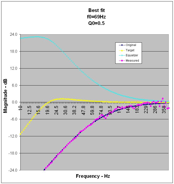

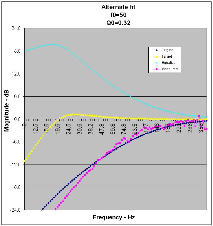

Essentially, measuring T/S data myself still gives an OK fit but we still can't fully account for actual driver behavior unless I pull out those 500 W for 2h. So, what happens if I just ignore theory altogether and do the best fit I can obtain, regardless of measured resonance or expectations of Q? Figure below.
Soooo, conclusions?
Apparently, above driver resonance, f0 and Q - either from datasheet or from impedance measurement by myself - present a reasonable fit to the measured FR, and so the theory is vindicated somewhat.
Below resonance though the suspension seems too stiff, at domestic drive levels, to attain its spec value.
As a result the actual and "typical" behavior I can expect at domestic levels is an f0 of 69Hz and a perfect Q of 0.5, far from impedance derived expectations of mid-30's f0 and upper 0.20's Q.
In general, this also shows that one and the same dataset can be fitted, reasonable well, to a host of vastly different f0 and Q values. Depending on what you expect to see, you'd likely beelieve any of the "fits". Below I throw in a random possible "fit" that would also pass if one was to expect these data.
In addition I will forever smile when I see people getting into heated debates of Bessel vs. LR rolloffs, especially when in fact they expect to obtain these alignments entirely by modeling box sizes after modeled FR's from impedance-derived T/S parameters. You can probably commit large errors here and you'll never know.
The conclusion for myself is actually a happy one: I expected deeper bass but unwittingly I now have a perfect Q=0.5 rolloff for free, and it works amazingly well in my room. Surprisingly I don't miss the deeper bass, it is as taut and impactful as I could wish for. I have to add that I have a strong room mode at 50 Hz, so just when driver rolloff occurs the room flattens the curve in my case, and the little content below 40 Hz or so just is not noticeable with the music I listen to. This also explains why driver compensation didn't improve the picture - wrong EQ from wrong modeling expectations, plus if I EQ the room mode does more harm than the EQ does good. I still might try to add sealed subs one day, which I can then easily blend in at 69 Hz w/o further ado or even a HP.
You never know until you measure. And that is, with several methods looking at differnet parameters.

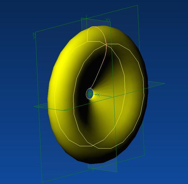

I was actually laze these past weeks, except for designing CAD files (friends want to do a LeCleac'h horn, and I wanted a combo of OS WG at 120 degree coverage with LeCleac'h roundover termination). I hope I'll have the opportunity to abuse my said friend's CNC and try first my existing 27TBFCG dome tweeter on such a WG. I noticed that the actual opening of the TBFCG is 1.4" and I suspect the poor results by Zaph/others with WG on this tweeter might have come from milling down commercial WG's too much ( to fit the 1.4" diameter) so that the curvature was off. But only an experiment will tell...

Well, let's say it is an experiment, with several possible implementations...
If used on a flat baffle as an insert, the WG would be ca. 14" in diameter. If using the full LeCleac'h roundover contour (as a freestanding horn) it would extend to 18". I thought I try the flat baffle insert first, and compare it to the free standing full contour. My baffle is 24" wide (o.d., 22" i.d.) so it all fits anyway.
Optically the flat baffle with horn cum woofer below it would be more simple in its looks, but a bit bulky (that is what it is now). With a smaller, say 24" square bottom just for the woofer and a free standing horn on top, it would look a bit more exotic (imagine a typical large guitar speaker "box" - they're usually open baffle anyway - with a horn on top).
In terms of X-O my minimum target is 1.2k, but ideally I'd like to reach 800 Hz. 1.2k would still allow me to use a dome tweeter, if tests turn out OK and loading is sufficient to save it from overexcursion. With the 1.4" throat, it fits perfectly the actual opening of the 27TBFCG (1" dome plus surround) that I have now. And if finances permit, I can also plug in a standard 1.4" compression driver at any time. Chances are this would actually be the preferred solution re: clarity, dispersion, and audibility of the X-O.
So in summary the horn design criteria were:
- fits my 22" internal width baffle
- allows 800-1200 Hz X-O
- has 120 degrees coverage to match a dipole's nominal -6 dB at 60 degrees off axis
- can fit 27TBFCG 1" dome or 1.4" compression driver
- can be tried on flat baffle or as a free standing horn.
I hope it's not going to turn out a swiss knife kind of thing - does everyting, but nothing really well ;-)
Unfortunately the depth is a meager 4 inches, so this is one of the open questions: what loading, if any, can there be under these conditions. As a consequence a dome tweeter might actually work better. Then again 4"x4=16", i.e. the wavelength of 840 Hz. It might actually work...
The material should be wood if I can use the CNC machine. Pics: no idea yet when this will actually get done :xeye: ... but I can offer the drawing of the full roundover WG which is 18" in diameter. Due to the shallow depth one can ignore sculpting the rear side of the horn (the outside), and make the backside where the driver mounts flat - this could then simply be flush mounted on top of a flat baffle, with only the driver protruding inside the baffle.

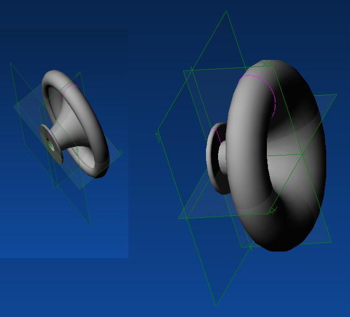

The 500 Hz LeCleac'h I drew for my friends is actually prettier, and smaller too (500 Hz cutoff, recommended to X-O 1 octave above). They will have a small series made in Fiberglass, and then we can add adapters for 1.4" and 1", that explains the flange.
To match the 120 degree OS WG I needed to use the edge of a 380 Hz LeCleac'h (hypex contour). But its coverage would be more like 80 degrees if I am reading the available info correctly. All this is very skimpily documented anyway...

Nice CAD work...what software did you use?
It will be close. If the DDS Eng-90 is any indication, the 4" depth might be an issue...or not! The ~conical section of the DDS (which determines pattern) is about 3" deep and, as shown in the measurements above, it begins to lose loading and directional control around 1.5k. The MSC waveguide is a little deeper than the DDS and holds things together a little lower. The ribbon WG I'm working on is the same 90 degree conical section as the DDS, but 19" wide (overall) and about the same depth as the MSC...we'll know in a week or so how that works out.
I used Alibre, at some point they gave away fully functional CAD software (to better sell their "professional" versions later, but even the base version is way more complicated than I need).
