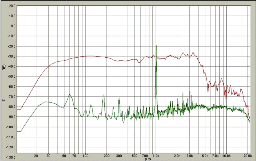

What is the 70-80 hz peak ? Driver itself or due to the measurement environment ? Is it a problem tha day it will be puted in a bass cabinet ?
electrical measurement (not maid on acoustical on a IEE baffle) ?
Don't know, I assume it's a measurement artifact of some sort since it's the only Altec impedance plot I have accumulated with one; otherwise it's ~ typical for a 414 whether A, B, C or Z model. Don't have any yet for GPA's replica.

The peak of which you speak is in the bottom curve is the rendering of harmonics , it sends a wave 1 kz at maximum rms value of the speaker and looking at the spectrum that it gives to see his behavior ..... unless there is better than it is. The top curve is the real curve 1 watt if you notice in the frequencies from 300 to 700 there is a depression from 4 to 5 db (not good )
