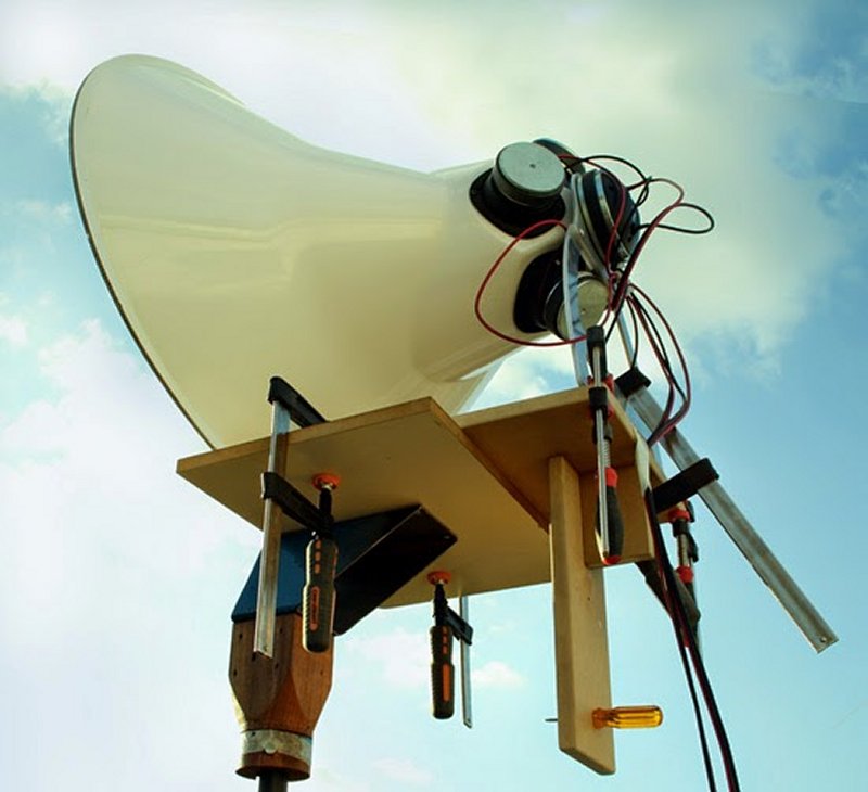

yes the half moon horn with a long neck and the CD above is a "pavillon replié" with a mouth of 1 quarter meter !
It seems more logical to have a cone driver for mid bass... (>80 hz) a strong electro magnet speaker could be good if No 'Voice of Theater" ?!. maybe a 2" CD >= (400-500 hz) is a good thing if you find the good match below (Onken à la TAD like Ibre ?) but a voice, a cello, going from a 15" to a fast horn.... you need a holy crossover to match the fastness, no (it seems impossible for me as a lot of people try to setup their 2 ways high efficienty speakers the half of their own life...)

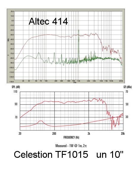

What does GP Audio advise for XO slope & Fhz crossover - 3db ? second order (12 DB) for a good match (around 1.5 octave below and above the crossover) ?

yes: the dynamic, the transcient... less distorsion at same midle volume DB than low efficienty. And more difference db level with dynamic between two notes !
We live here with very low to low efficienty (85 Db/ 6 ohms to 92 db/ 4 ohms with a 89 db/8 ohms as third system... this last always off because lake of space !)
