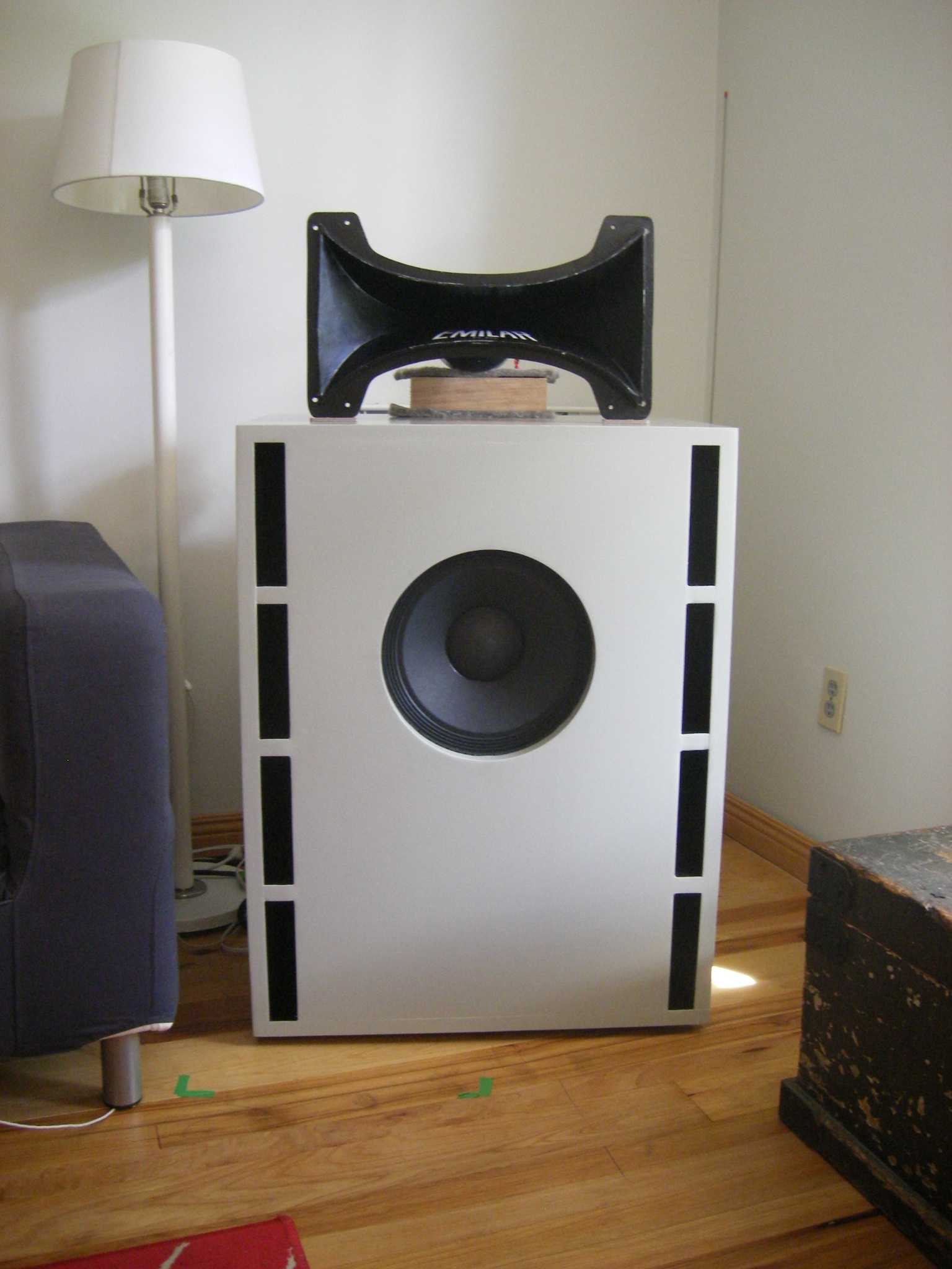

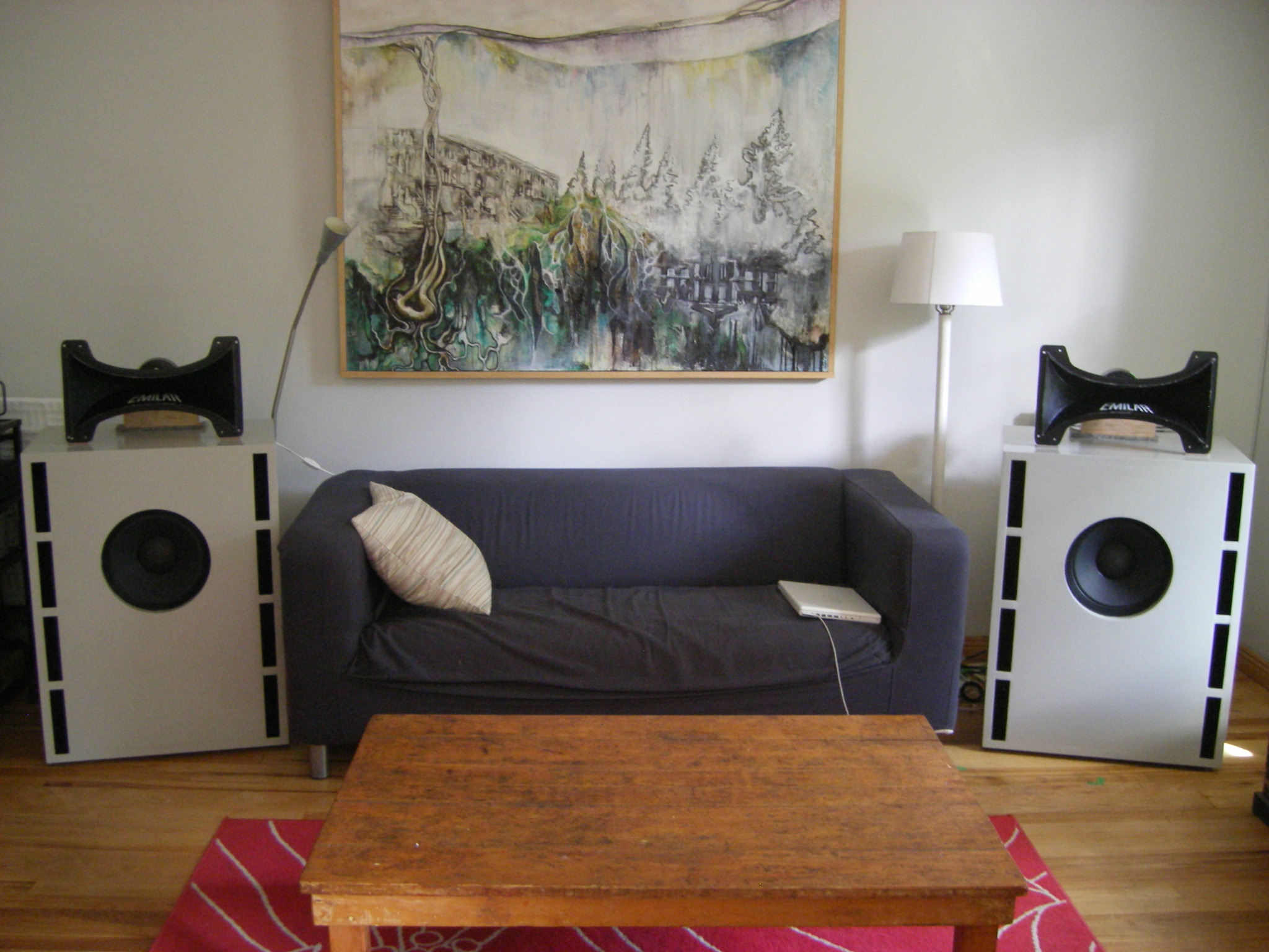

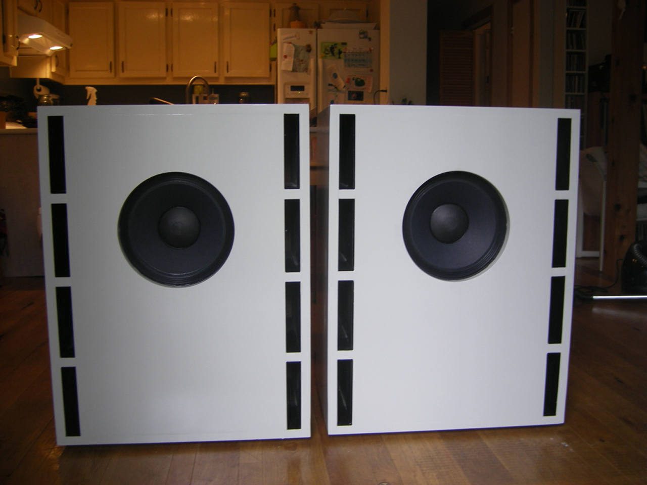

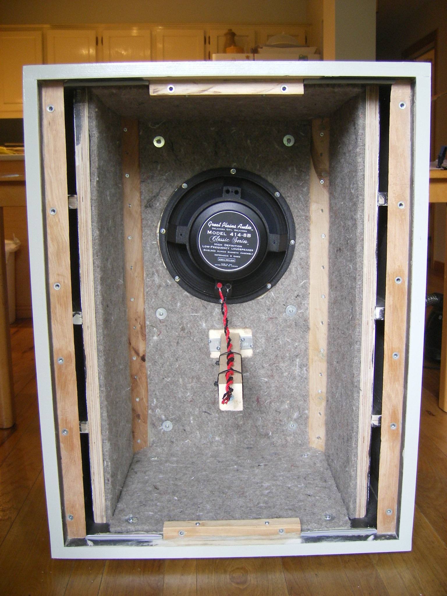

Hi everyone,
I just want to tell you that I've finish my petite Onken. They are running since last week. I'm really impressed by their sound. Wow!!! One of my goal was to get more bass than my actual AMA 3x100 and it is totally accomplish.
Plus, their sound is full, rich, pleasant, natural, dynamic... All the best! I'm also VERY surprised by the quality of the Emilar EA-175 compression and EH-800 horn. Thanks Michel (4mc2) for the suggestion.
Here's a few pictures.
Have a nice summer,
Sébastien
Have a nice summer,
Sébastien
