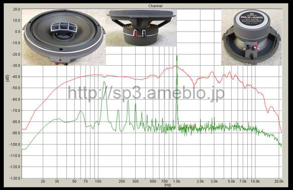

Any here,
Do you remenber the brand of the high efficienty japanese famous monitor speakers (70ss & 80s') which used the ALTEC with a front little multicellular horn than Hiraga use in him last comercial speakers ? Do the CD exist on the shelf yet ?
Maybe in second hand could be a good purchase for Sebastien ? What it the price of these Altec at Great Plain Audio ?
I didn't finally understand with my bad english with the testimoinie of Gary if new one copy are better than the genuine Altec. Ok same equipment at Great Plain audio than Altec but the cone material and roundings ? Better today than ever ?
Do they try to improve the old design as well at Great Plain Audio ?
Sébastien , You know the price ? ...... find
Interresting ...... annular diaphram with super tweeter in center
He write 300 to 7Kz but on graph it's more 700 hz !
" The unique voice coil technology employs a light weight Copper Clad Aluminium wire wound "
not new .............. Coral and MarkAudio use it
