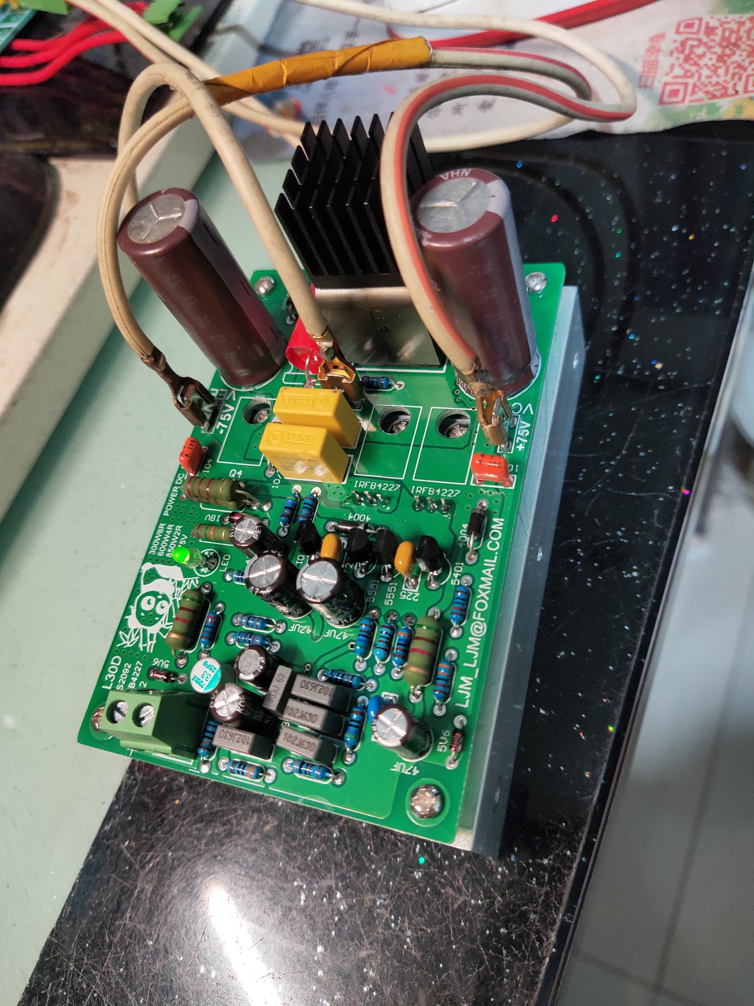

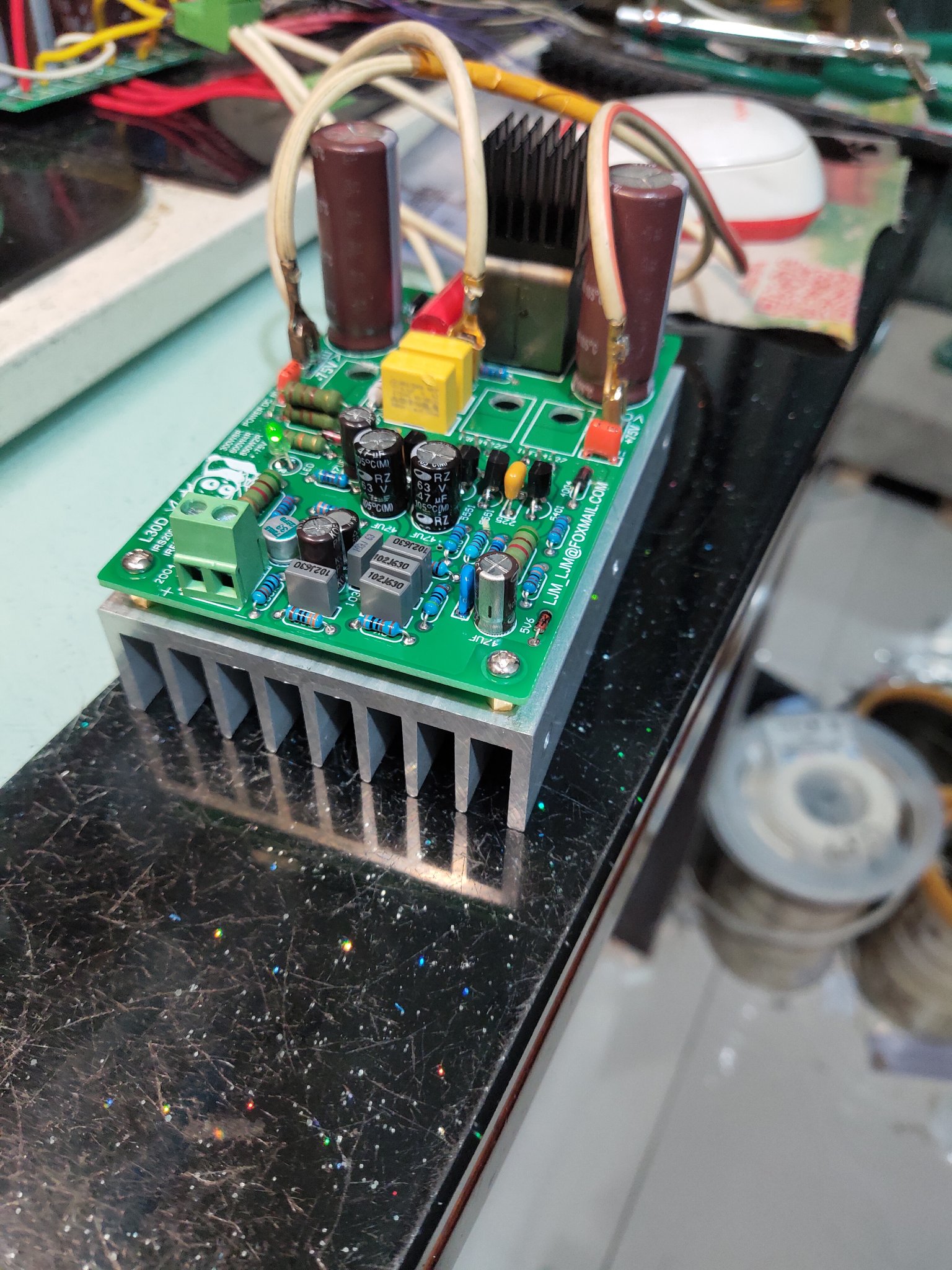

L30D IRS2092 IRFB 4227 IRAUDAMP9 MYDIY
The issue is the heating of the 2092, that has no heatsink and blows up. The switchers themselves dont run very hot...

Not sure I understand this. The IRS2092 can handle voltage swings of +/- 100vdc, which suggests an inbuilt VAS stage to drive the output mosfets... given the chip is handing 120-200 vPP, I can definitely see it heating up as other have suggested. I myself had 2 L30D boards blow up on +/- 75 v supplies with NO signal input after 15-20 minutes of running fine.... 2 boards not one. This suggests an inherent inadequacy...

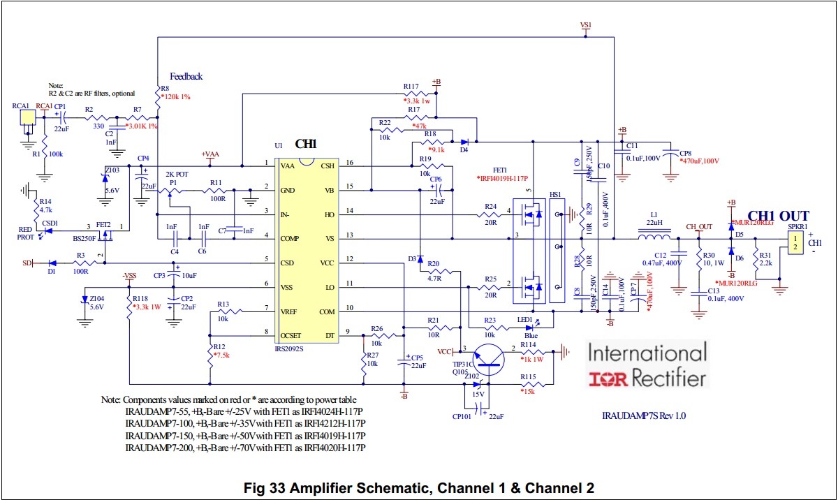

I have several amps based on this design (L15d pro) that are very stable, produce little or no heat and generate very high quality sound. All of them use a seperate 15v regulated power supply (Q105, Z102) for the Irs2092 (as based on the original IR example design). The HT supply is +-70v SMPS. All amps are in closed boxes with no additional fans or heat sinks. They have been in service for years, without failure and are used for long duration on a daily basis.

Why?? As LJM has indicated, HT supply or even power output have no effect on the IRS2092. It runs from a seperate 15v power supply. In the circuit above taken from the HT supply, in other designs from a seperate regulated rail. The IRS2092 has suffiecient power to drive the MOSFETS directly without heating. In more powerfull module the Parallel MOSFETS are driven by a transistor driver stage, but like the direct MOSEFETS in the previous circuit, the requirment is not enough to heat the IRS2092 device, even with the HT into 100s of volts and KWs of drive, only the output MOSFETS, or inductors can ever suffer heating.
In the my case and my L15D Pro, the module is in an enclosed ABS box, with the IRS2092 in direct contact with the plastic. The IRS2092 is surface mounted on the back of the board, never even gets warm and the MOSFETS (and TIP31c power reg.) only slightly with the stock heatsink provided. Today the tempreture reached 40º degrees in the studio, these have been on all day and the enclosure is cooler than the wall.

In addition, if you can send L30D to me for research. I'll find out the cause of the damage. And give you two no problem. But this L30D is very simple. It is actually iraudamp9. No special treatment.
In fact, its temperature is lower than iraudamp9
Iraudamp9 is about 110 ° C.
L30D 63 ° C

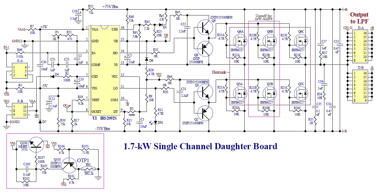

Can I use other parts apart from 4227's? I dont mind stepping up to higher powered parts available in digikey...
I found I had to be careful using higher power mosfets as many have higher gate capacitance which requires stronger drive signal.
This caused amp to cut out at high power levels due to mosfet not switching on fast enough and amp thinking there was overload.
I used TC4420 gate drivers to drive 2 pairs of 4227's.

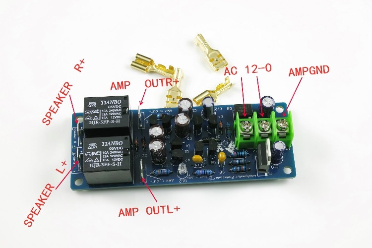

I have been using this amplifier for few years after some mods suggested by Greg the amplifier is working very well.
Now my doubt is does it have DC protection? and short circuit protection? do I need to use one if it does not have.
You need a DC protection.
It must be relay based. Triode protection is not safe.
