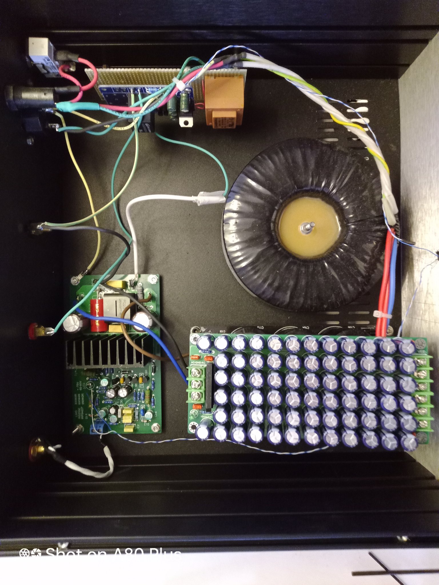

The problem is not completely on the L30D, it seems those 68 tiny 220 mf caps rated at 80 volts, should warm up with my 70 volts total passing thru, I m told , I m not sure, but the resistance is low, so....(?)
Some say that a 50% safety margin is recommended,so for 70v operating voltage should be used 100V rated capacitor,but this is just for pure safety,in practice I've never had any problems or excessive heat with 10V safety gap like you have,so you should be fine. Also they are rated at 105C I think,therefore if they are just a bit warm it's not a problem.
An 80V capacitor will tolerate 80V, so for 70V there is no need to use 100V.
Some may wear a life jacket under the shower, you can but do not need to.
If you run something unregulated, plan for 10% tolerance. If your 110V mains have 121V over voltage, the 70 V stage after the transformer will see 77 V. If lightning hits, even 500V caps won't save your amp.
With 50% over, probably some transistors will fail, sooner than the caps.
Capacitors should not heat up by them self's, just sitting in a power supply at idle. If a Chinese product does, maybe something is not quite right.

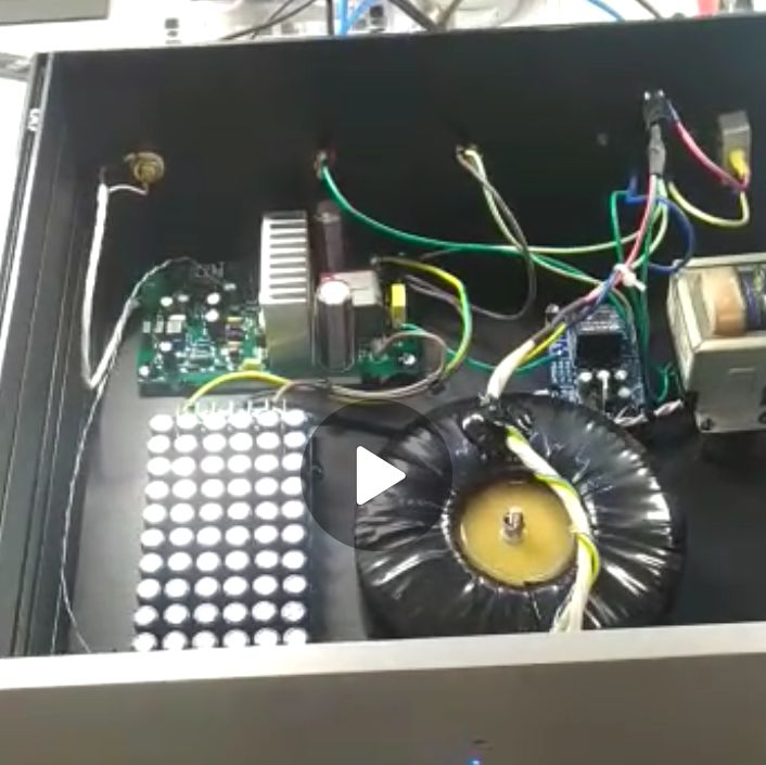

We are changing the power supply which burned. Installing the 68 mini caps power supply. But we found protection had burned 220-12 transformer, and the l30 d has burned the second that burned !!!! One exploded actually.

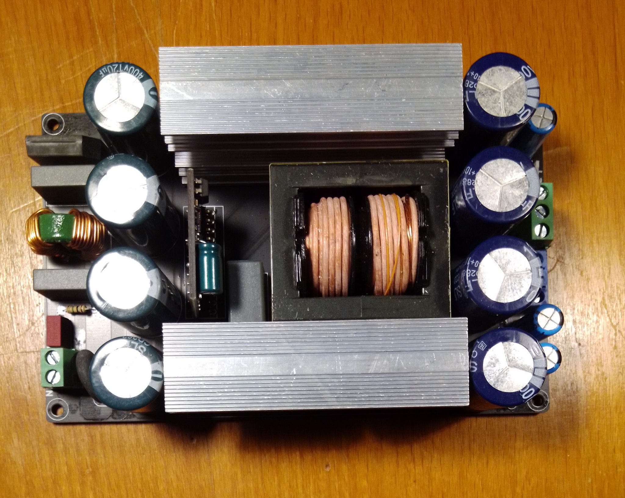

It looks like a neverending story for you,I hope your bad luck will end soon . I've always used SMPS power supplies for their compactness and easy to use and I have never had any problems. I've just received mine 70V 800W,I will try it soon with my new L30 module and let you know,hopefully this combo is better.

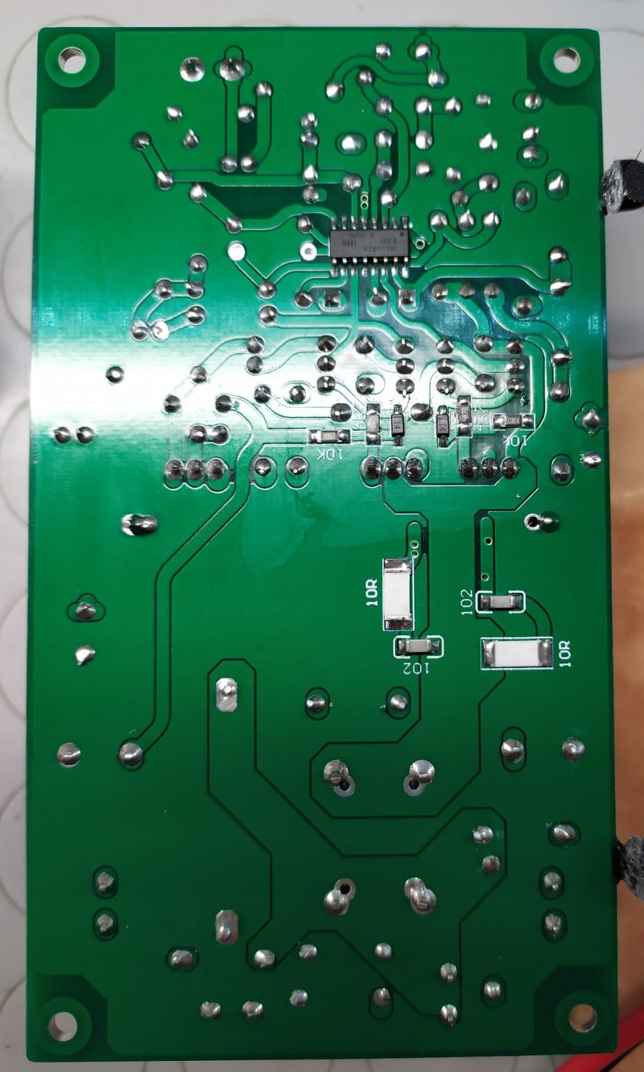

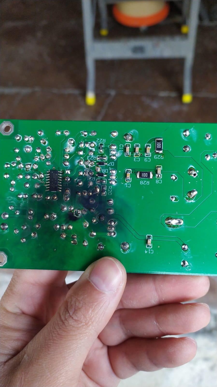

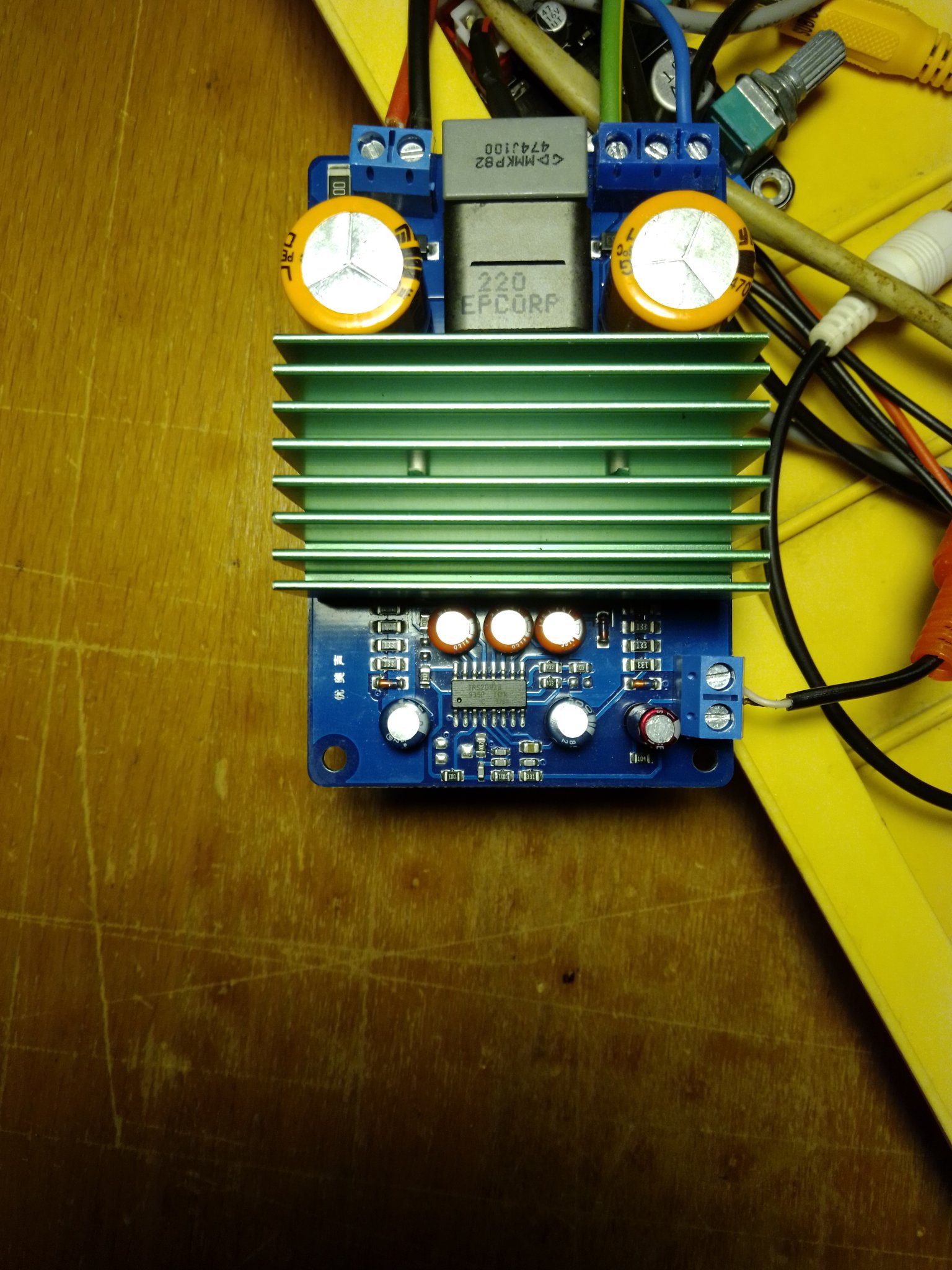

The underside looks like something shorted out on a solder joint, or somthing got very hot and the solder dripped and then shorted out. are you running a big subwoofer? if so you might be getting "buss pumping" and this can increase your supply voltage above what its supposed to be.
I guess the faulty ( fake ) power supply was the culprit, plus yes, the bottom of the pcb could have had a short circuit. The 220-12 safety circuit transformer also was gone. Mr Ljmaudio suggested me to use that power supply, apart from costing three times more, they are not so utterly good.

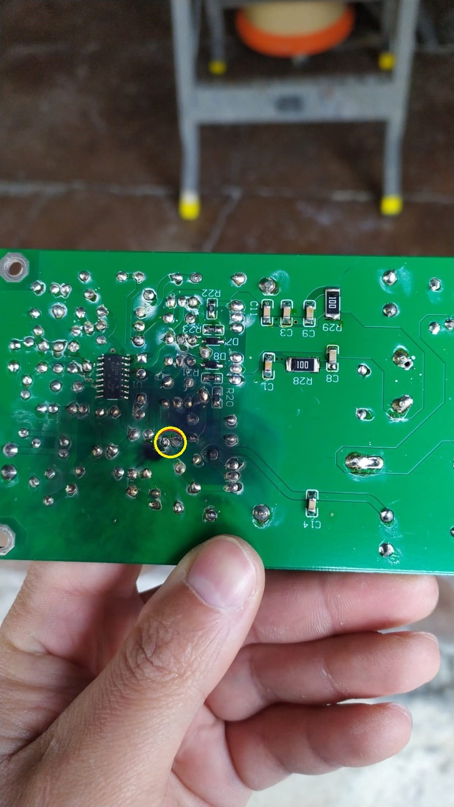

This looks like the starting point/short circuit. I am not surprised about the fake/faulty boards,I have experienced exactly the same thing with 2 tpa 3255 boards,one burned and one exploded,the bottom was black just like yours. Since then I check with a magnifier the soldering for anything suspicious or solder points too close and clean them if necessary. And of course I try to buy (amps and power supplies) only after at least a few reviews about them working ok.

I know,that was exactly the case with my TPA 3255 boards,they worked for hours in different days then suddenly exploded and burned one after the other I was puzzled too,so I suppose it's either a bad/fake/unreliable part or some kind of conductive oxidation between very close solder points that evolves/advances in time. Anyway after that I gave up with them,,2 burnt boards was enough for me (in my case the SMPS power supply was and remained ok)

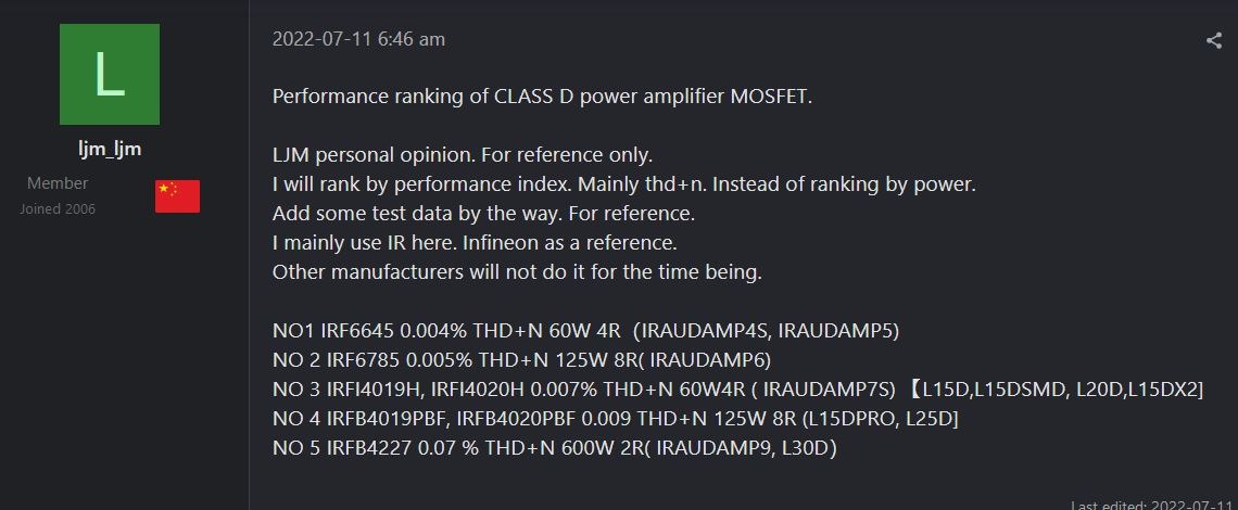

Thank you for the responses its was really helpful. have anyone had any experience with the L25 it looks good. That would be my next option. What I want is an amplifier powerful enough to give at lease 600w at 4ohms stable without breaking the bank. The power supply I own is rated 73v however when I tested without load it's 78v, I'm guessing it might go down with the amplifier connected.
As far as I know the L25 is designed for 8 ohm load,at 4 ohm it becames unstable at the least. You can see that in his specs and reviews. There are many types of IRS2092+IR mosfet based boards available for different loads and different powers everywhere (ebay,aliexpress,amazon,audiophonics,sure/wondom etc). If you want only a LJM amp board here is a summary of them (load,power) from the designer himself. Capture.JPG
