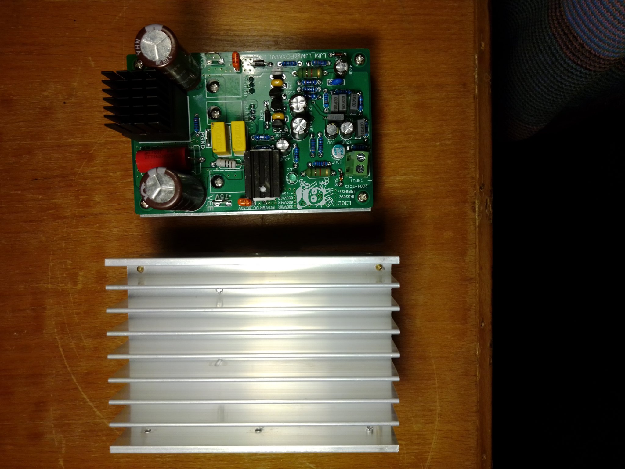

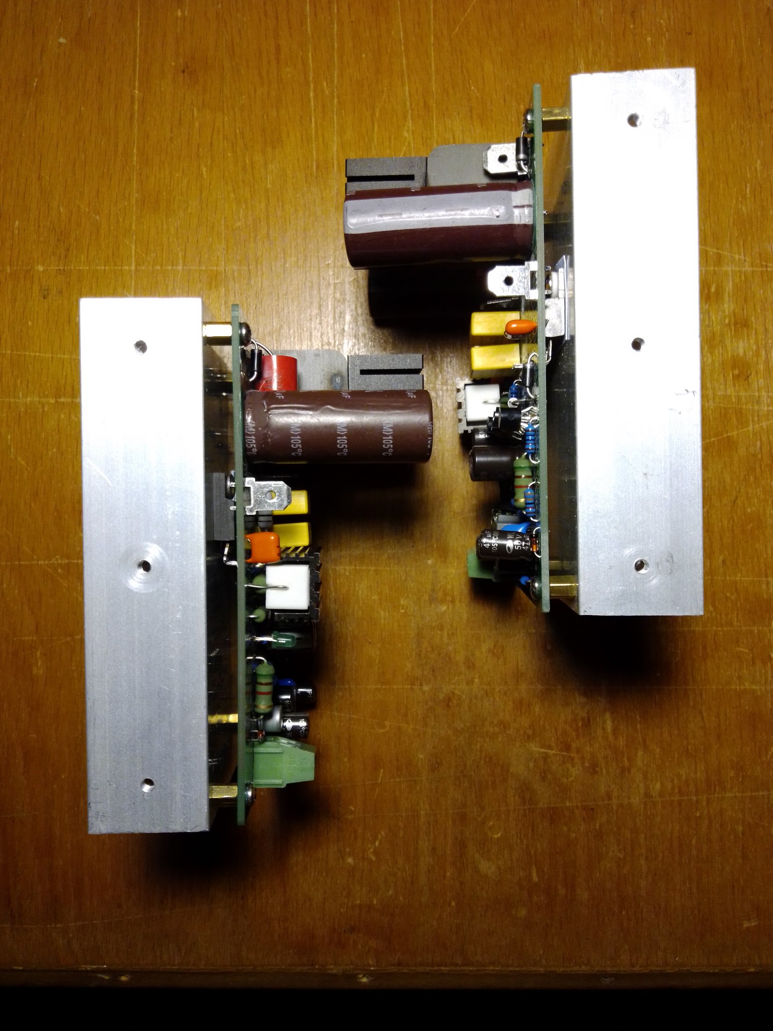

I've received the L30 boards,they look very well built,large heavy heatsink,metal spacers,heatsink on the output coil and even a small one on a ceramic power resistor. I'm waiting for the power supply to arrive.

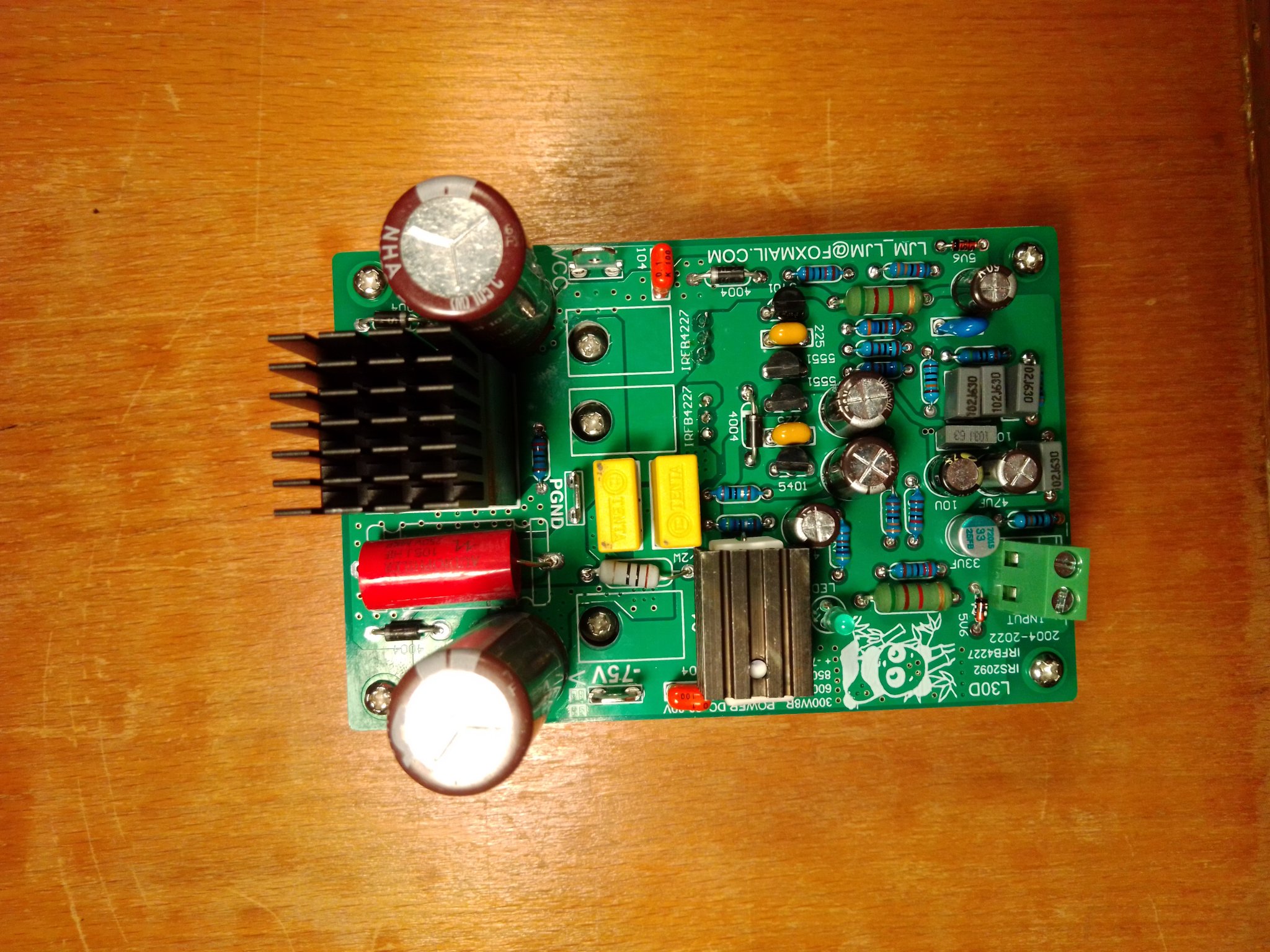

I received my l30 boards. One works the second one is defective. It starts without line-in connected. If i connect the line-in the led keeps blinking and the will not start. So help how to solve this is appreciated.
The connection between the line-in connector and the pcb is oke. I swapped the line-in connections between the amps but that did not solve the problem.

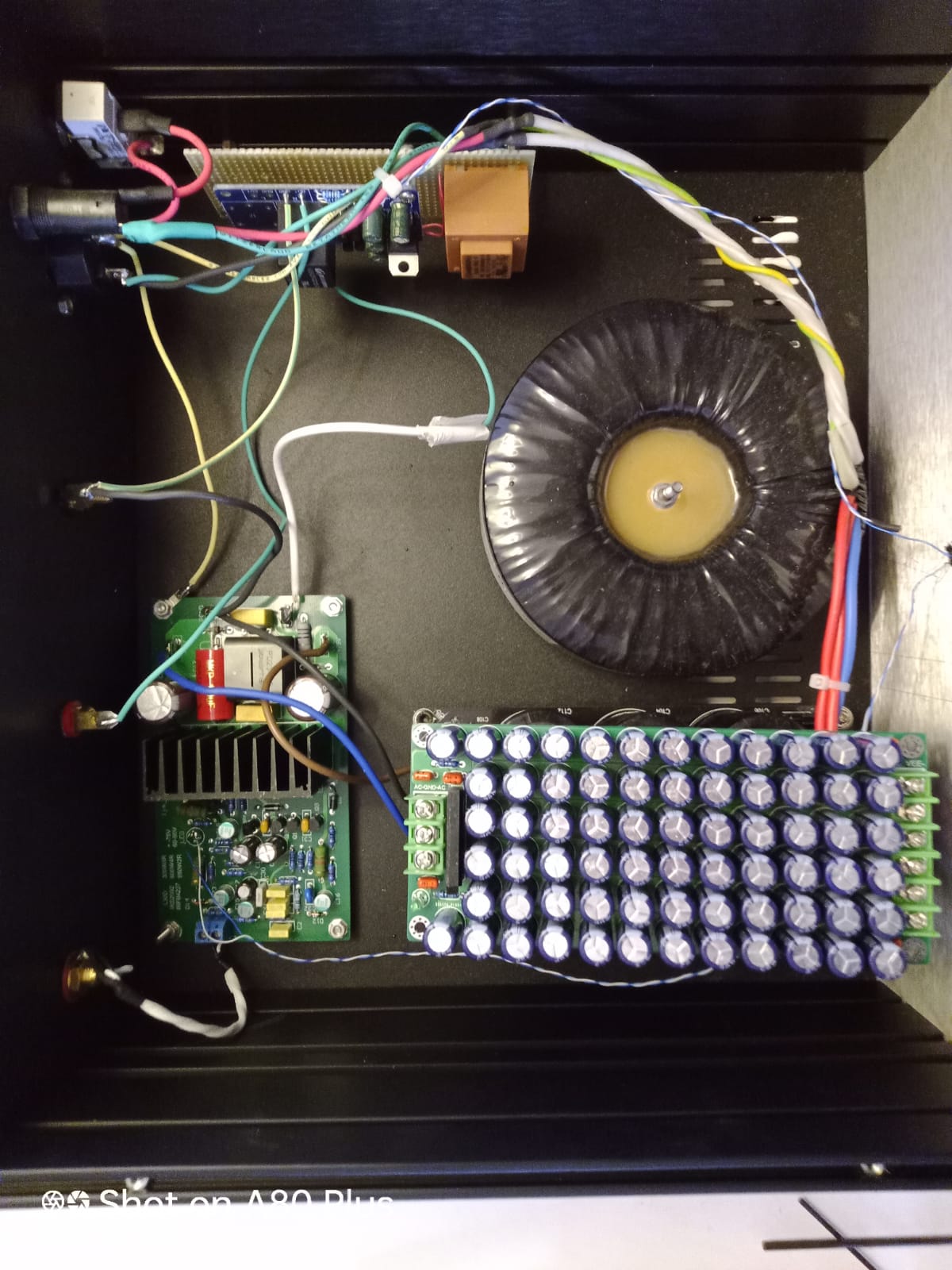

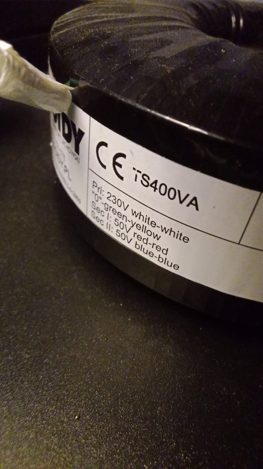

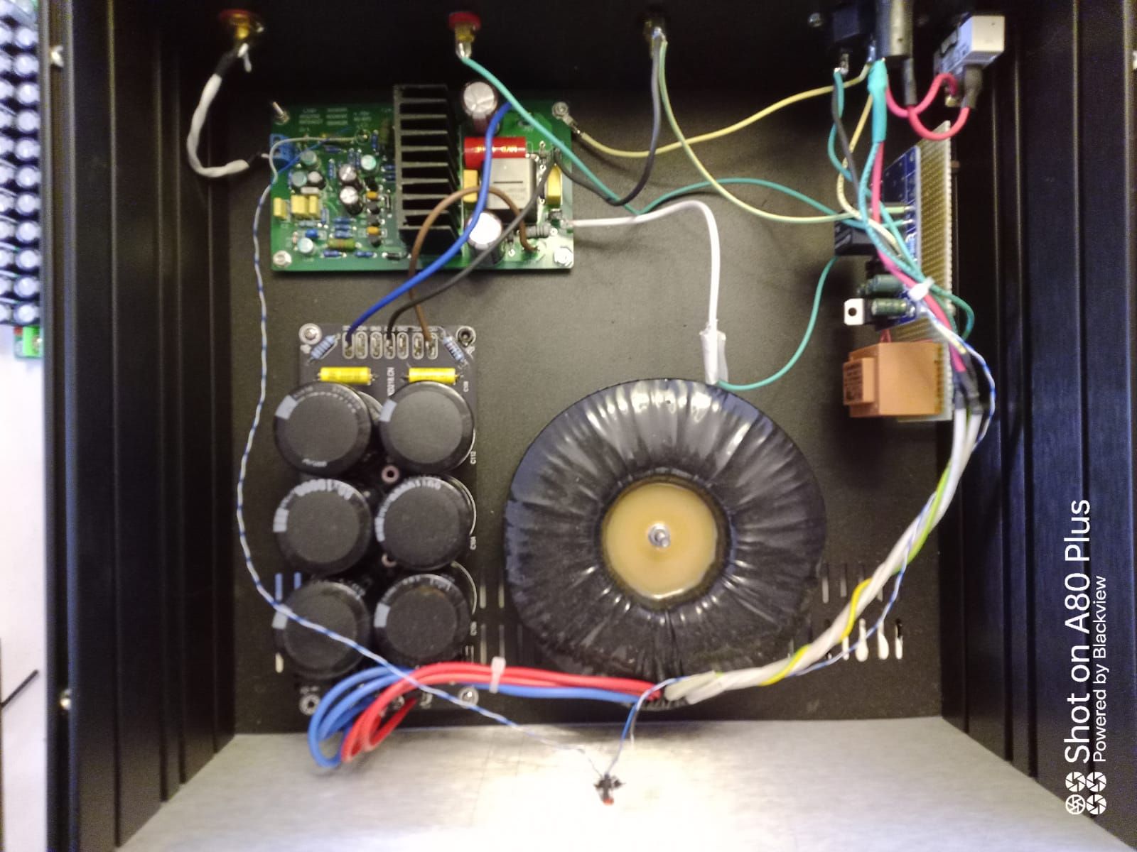

Hallo, here s my mono l30 d amp---I have 2 of course, nice sounding, powerful, unfortunately, the power module break down, I bought like you suggested new power modules, transfo is out at 50 Volts, so we get 70 volts, capacitors are rated 80 volts, will they get too much warmed up ??? is everything correct now ??? power will be 70 * - volts.

the amp module has been on one hour driving my 18 inch sub woofer, the temp is 40 C-I have not yet installed the new power supply module, the old one is 20 C
40C seems acceptable to me,and also first you shoud try a vent in the cover/lid of the amp just above the L30 amp module for passive cooling,and if that is not enough a 12V fan is perfect ,whatever diameter you like. However if you add a fan don't forget to add it in a way so that the air can move inside/outside ,a fan is useless if it only moves the hot air inside the casing of the amp.
Reactions: chienmort
Also, make sure the fan is directing air directly onto the fins of the heatsink. It is the turbulence of the air passing through the heatsink fins that helps cool the heatsink and hence the MOSFETS.
