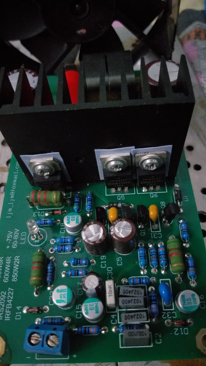

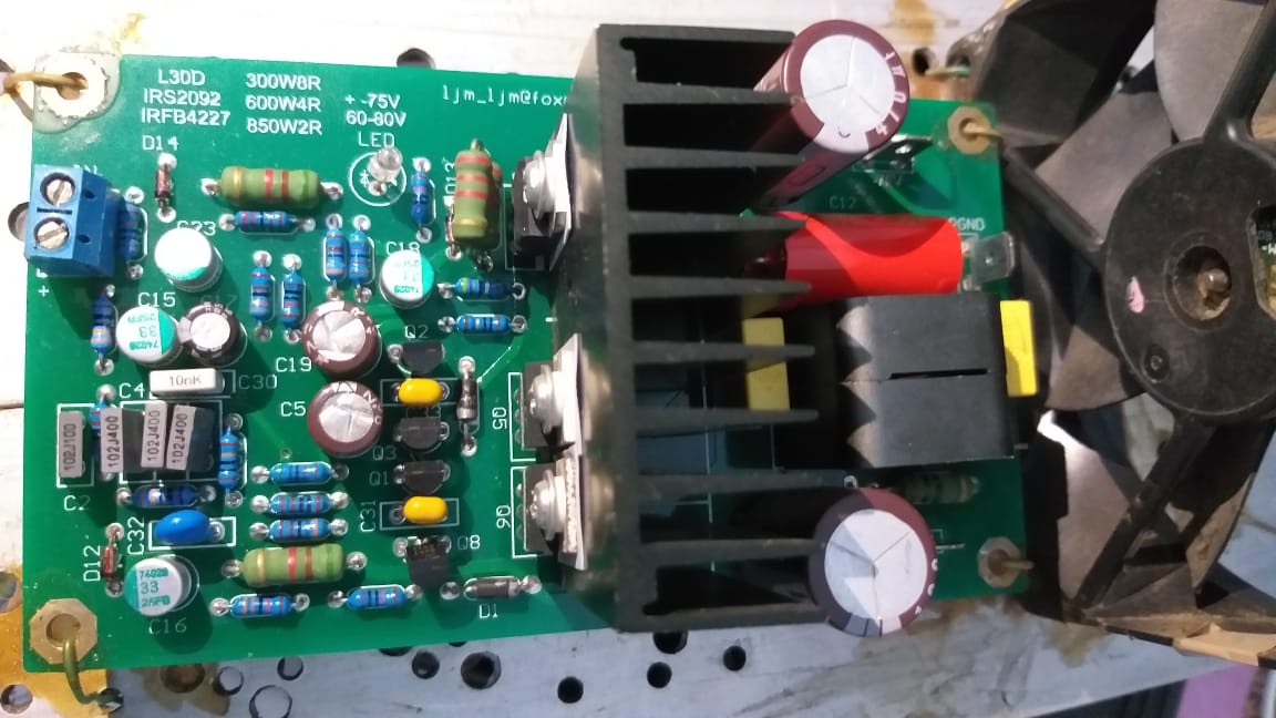

I see in the picture the L30D has two driver transisors for the MOSfet´s. So it does not have the problem of other boards like the L15D, with the IRS2096 having to supply too much current from the internal voltage regulation for driving the gates? Or do I miss something?

You can refer to iraudamp9
It uses two triodes. As a drive.
There is no problem with the L30D. It's a standard irf427 circuit.
It is not the same as l15d.
The main reason is that the voltage of power supply is different. L15d uses + - 50V
The L30D uses + - 75V.
Its either that (too much current being sinked) or that the 2096 is not heatsinked and overheats and shorts the IRF's. I have blown 2 of these (including my woofers one time ) as they play fine, the IRF's heatsinks are not even warm, then poof... So I suspect the 2096 shorting...
These changes were implemented so the board would be stable down to 60v , mount them slightly above the board as they get hot. The k1 resistor is part of the 5.6v zener regulator that supplies 5.6v rails to the 2092 these should be 3-5 watt rated.
I am not sure how relevant this is but I have one of these modules (purchased some years ago but only now being considered for use). My initial thoought was to change he silpads on the MOSFETS. They are not great for heat transfer OR insulation especially on a high power amplifier.
In you picture you can see how the area of the pads have distorted under the clamping pressure.

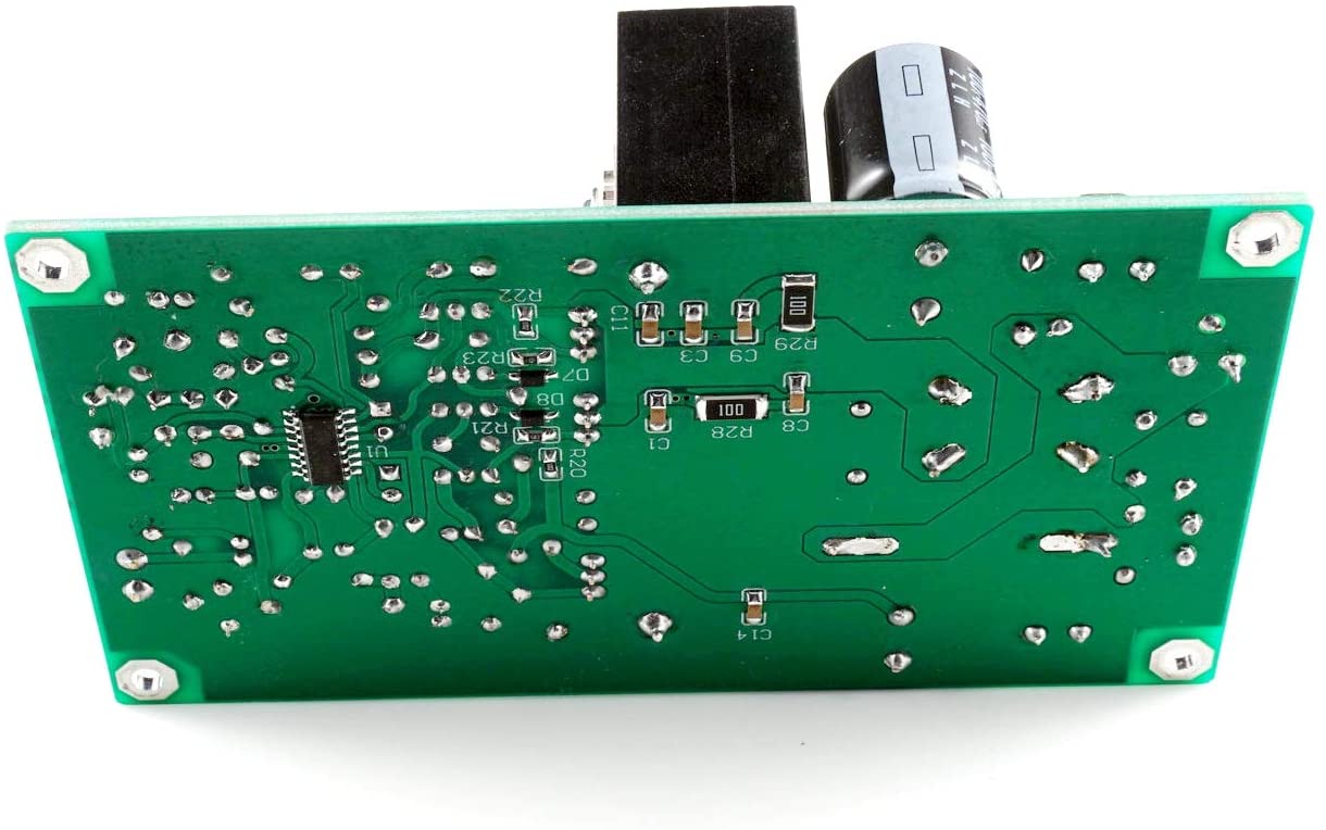

IRS2092 is this chip on back side? If thats true, I could glue some heatsink on it.
My supply voltage will be +-63VDC so I wont push it to the limits. But the speakers are 4 Ohm, on the other side...

can I put L30D inside SEALED subwoofer box of 30l (together with linear PSU)?
How much heat does it produce?
The replies above are worth consideration but my worry would be that there is no air flow from the inside of the cabinet to the outsid. I am also concerned that the module cannot achieve higher power levels without additional heat sinking for the output mosfets. You will notice that most commercial designs include a hearsink of sorts. These can be large Aluminium backplate or a fined heatsink..
