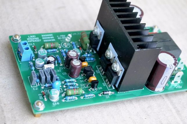

Nigel can you help me with my issue on l30D. It worked well now start to reset on half the power. On dc+ rail measuring above 1.4Amp is resetting. How did you fix the resetting issue? Everything else is working well ( except the heating but I am using forced colling and its ok ).
I found I had to spend a bit of time getting over current detect circuits to work at high powers. Increase the resistors to get a higher over current detect limit. See datasheet for resistor values.
I also found driving mosfets with high gate capacitance needed low value gate resistors, as low as 4r7. I found I could get away with 10r if I used gate driver buffers.
This is the board

+/- 80V power supply
Will the L30D run with a +/- 80V power supply (quoted as going up to +/-83V on higher mains input voltages)?
I'm planning to use a pair to drive two 4 ohm PA woofers at 500-600W RMS (for the loudest passages) and wanted a bit of headroom, though from what I've seen these modules will be a bit stressed with that much voltage?
I can see already that I'll need to beef up the heatsinking, and will make a separate speaker protection board (DC/unloaded).
The version I have of the L30D has 4r7 gate resistors with a diode in parallel for faster turnoff, has emitter coupled pair for gate drivers and appears to be otherwise OK for the task. I do notice that the heatsink (which is soldered on and at ground potential) is sitting right above the +/- rails without insulation and I'm a bit concerned that with a bit of vibration the solder mask will get cut through with some spectacular firworks to follow shortly after...
I might look in to an auxiliary supply for the L2092, I don't like the idea of dropping 150 odd volts across a resistor for more than 1 or 2 mA, seems like a lot of heat for not much gain..
Thanks,
Duncan
Make sure you have speaker protection in place. I had two boards die on me with about 5-10 run time. They do have a lot of power... but the suddenly die. I used 82v rails. Most likely the switcher chip died by over heating. It needs a separate heatsink.
Out of 4 boards only 1 worked.
Even changed chip on others and they were dead.. also changed mosfets.
Chip should not die by overheating, there is transistor totem pole that drives mosfets, mosfets are not driven directly..
