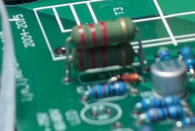

the description says Vmin is +-60V.
how bad would +-50V be?
+ -50VDC Will not work.
I've tested + - 68 v. Can't work stable.
Show the blue flashing LED, sound increases, will go out.
Voltage increase to + 75-75 - v or + v. LED does not shine. Sound and stable.
If change k1 resistance 5k1 to 3k9 2w. So can work stable in + - 65 v voltage.
From now on I will change by default. So can stable compatible between 60 v to 80 v voltage.
So, voltage range does not change (60-80 - v DC)

Only need to change a resistor. 2 k2 in parallel can be completely stable working above> + - 50 v voltage.
Of course recommended voltage is still 60-80 DC+-v.
From 10 days ago, all L30D in this way.
