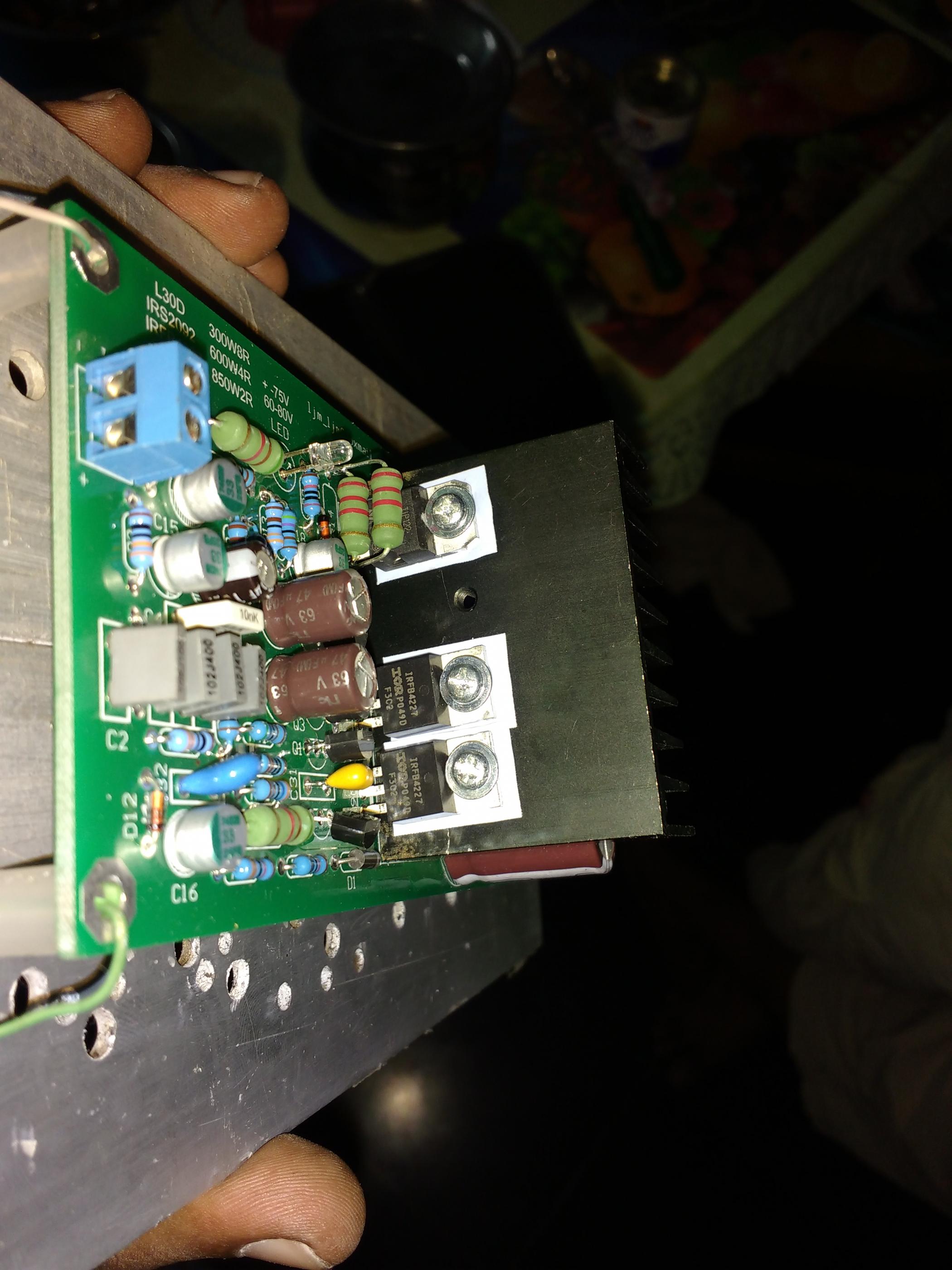

Got the amp from aliexpress
It worked great around 17 days sound was good
but dont know what happened, initially sound used to break in between for less than one second at high volume and later gradually distortion started and it stayed with it, sounding very bad now
what could be the reason IC failure?? please help
