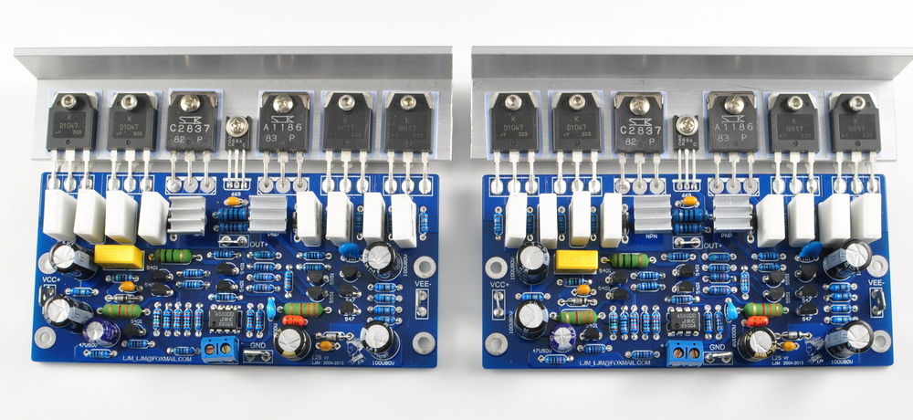

I was referring to the L25 class ab and not the L25D. Ive had many bad experiences with irs2092 boards myself.
On second thought when I check the datasheet on the transistors for the L25 I realize they're only 140v, therefore my guess is that it cant go over +-70v. my final option in my opinion is between a PR-800 amplifier board and a irs2092 board I've seen only good reviews online about.

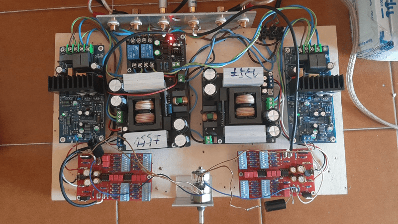

Here my L25-D
In the first photo work at 55-0-55 without modification and in the second photo work at 70-0-70v with a little modification to limit the hot on some resistors
The 2W resitors has been replaced 5100 -> 2 x 12K in parallel and the 2200 -> 2 x 4700 in parallel
Probably in the future I will try to use the aux outputs of the switchg power supply to generate the +5, -5 and -12v in order to eliminate the hot generated on these resistors.

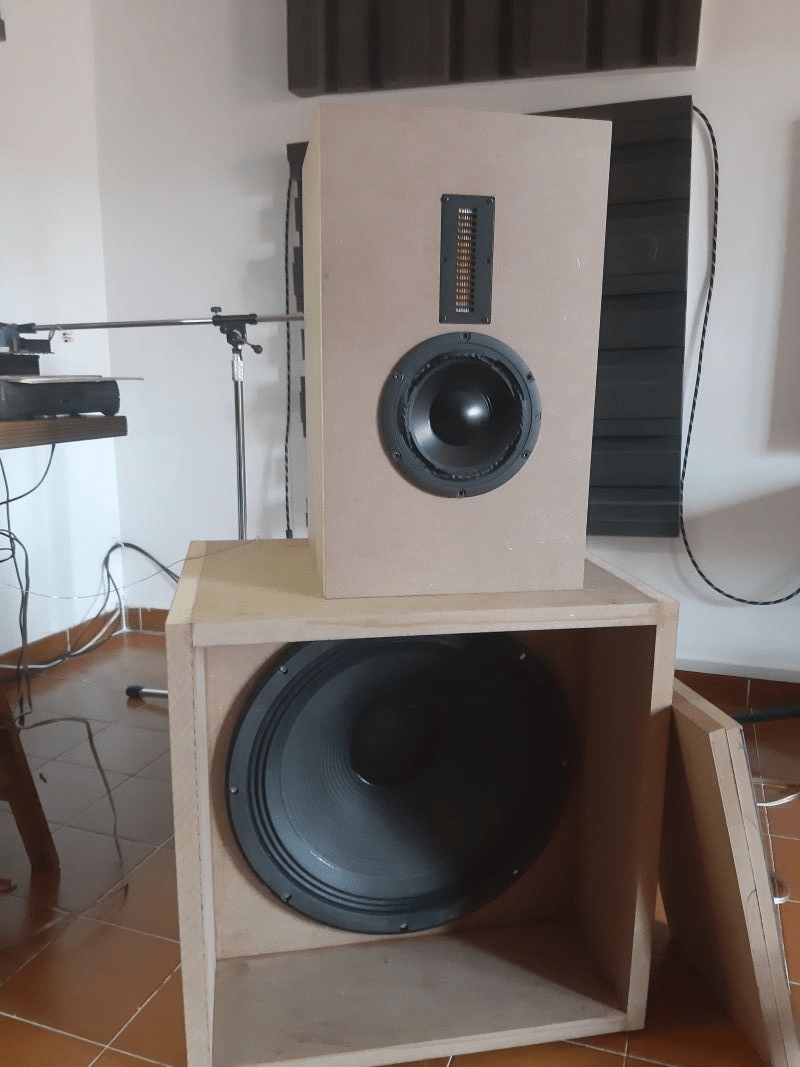

To drive this H-frame dipole subwoofer
L20 amplifier can be selected. Not L20D
It is L20 Class AB.
Then choose to use the ONSEMI NJW0302G 0281G transistor version.
You may need to consult the sales merchant.

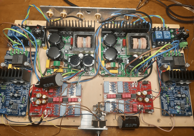

I would like to share here a positive experience with the L30D, different from the experience posted here by @Zzalex. I had to replace the amplifier board for my JBL ES250P subwoofer and this spare part was no longer available from JBL. So I ended up choosing to use the Chinese board L30D, which is a hybrid solution between the IRAUDAMP7S (for the IRS2092S input circuits and power supply for Vcc) and the IRAUDAMP9 (for the IRS2092S output circuits). I had to make some modifications to this L30D PCB to reduce the temperature (since the entire JBL subwoofer amplification assembly is in a closed plastic box, without any ventilation system) and also to preserve the entire original JBL protection system. If anyone is interested, below is the link to the thread I created with more details.
