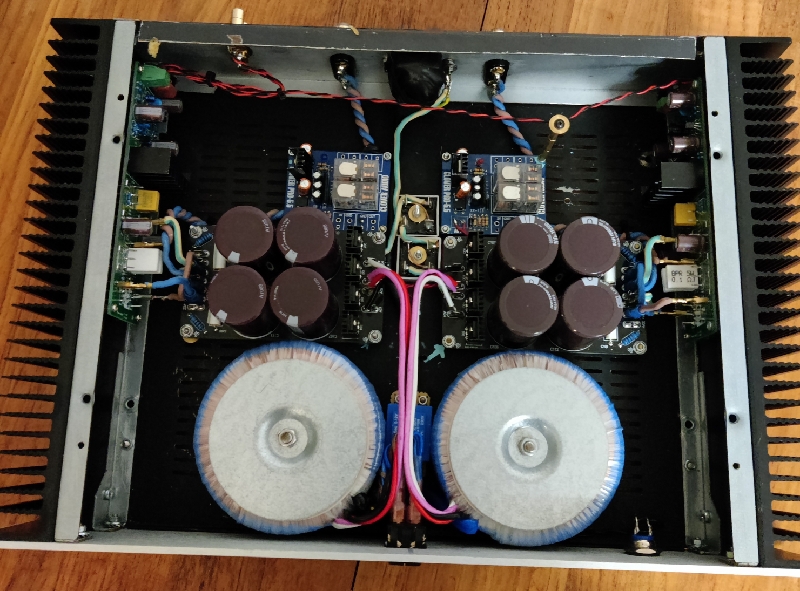

I had originally hoped that it was a good implementation of the Blameless Amplifier. However I am finding that considerable assembly is required.
As for measuring (low levels of) THD I am finding that is not a simple task. Where the measurement is taken and how the wiring done is not trivial. I am not finished sorting out my measurements but I am finding that a well done amplifier PCB layout can be easily messed up (in terms of THD) by rectifier/filter boards and speaker protection boards that join returns together in multiple places. For example, my uPC1342V board has an obvious star ground layout on the PCB and you can measure 0.0015 to 0.003% THD between the feedback point and the star ground on the board. But if you use a rectifier/filter board that is designed as the star ground point and then also a speaker protection board that joins the returns of multiple channels together you can measure 0.02% THD. (I am currently in the process of sorting this out. I will at least go to an isolated (per channel) protection board. However for the best performance I might just build it as two mono blocks.)
In other words a single channel with a single power supply and no protection board is currently measuring 10x lower THD. Perhaps that is how it was measured with the AP?

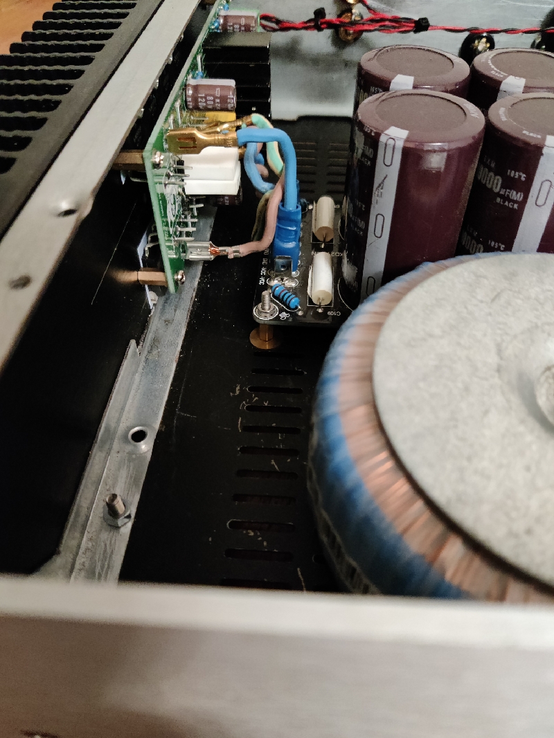

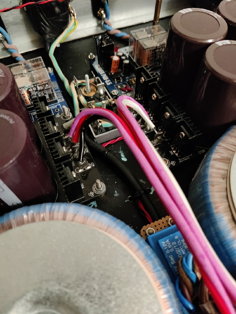

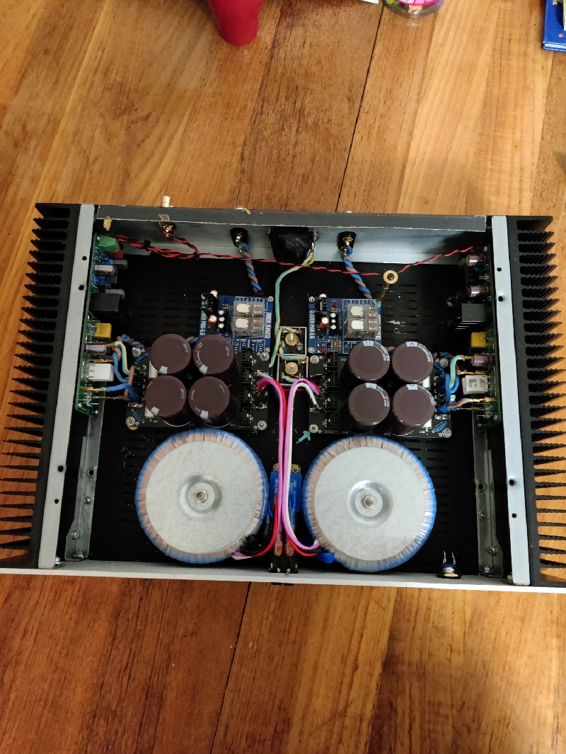

Here are a few pictures of my final build of the L20.5.
No noise can be heard with headphones connected to the outputs, even with source switched on. Believe me I did not think it was possible to accomplish that. I have invested silly amounts of time in trying different layouts, cases and blowing stuff up.
I am now working on getting a single supply build as noiseless and well behaved as possible.
