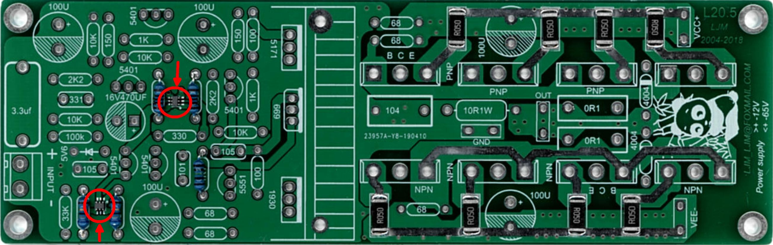

I have assembled two L20.5 boards, measured all components and sorted the transistors according to characteristic curves. I still have the Toshiba driver transistors as selected components from my setup 10 years ago. I have also used these.
Now I have connected the boards to +-36V and the output is -34V. A high DC offset.

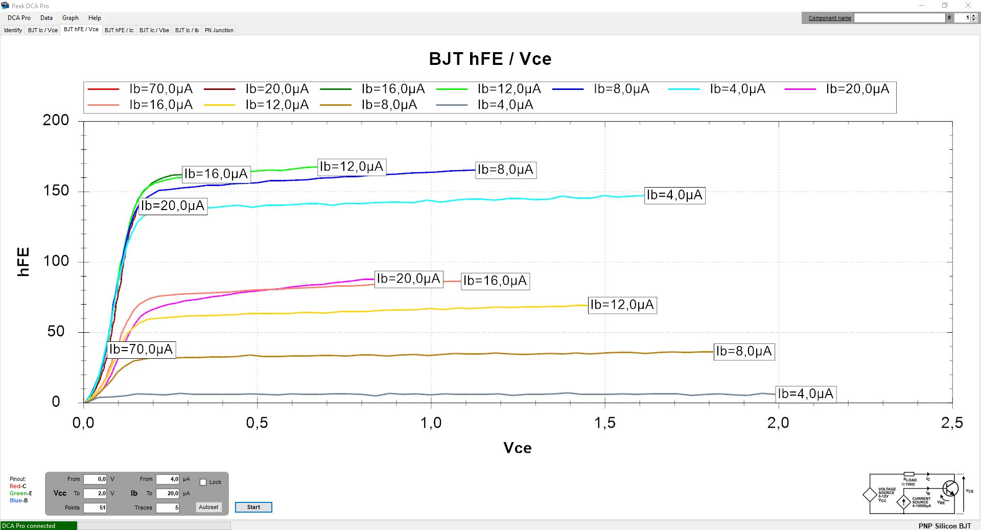

Since only the SMD transistor pairs were not measured, I did this with the input transistor and measured very strange curves. Both transistors (my unit says they are BJT PNP) deviate massively from each other, it looks like I got some waste.
Now of course I'm thinking of rescuing the amplifier and making a replacement input board or soldering in other components with free wiring. Any ideas on this that might work well? JFet p-channel like J175 maybe?
Update:

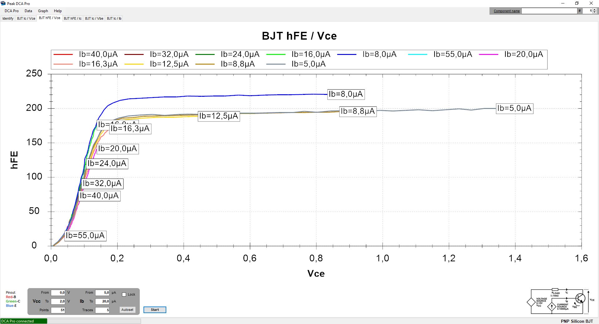

I measured the input transistor (pair) and made the following diagrams.
Because the chips don't seem to be that great and the one may not have been soldered properly as well, I replaced the input transistors with old PNP ones that I matched. The result is unchanged, a DC offset of -34V. I have no idea what is wrong there.
One point I noticed is that the Chinese 2N5401 are at hFE of 200, the ones in the kit are at 240, but my sorted out ones only have a current gain of 160. The kit transistors just have pretty non-linear behavior.
In an NHB-108 kit, the included 2N5401 and 2N5111 also have a low hFE and higher linearity, which is not wrong for music playback. But in this kit the drivers and final transistors are a horror, maybe they are just duplicates.

PS1: Have you noticed these very small ICs on the board? What if the problem is there?
PS2: they sell a single channel version too. Guess why 😉
PS3: You can purchase 2SC5171, 2SD669 (don't forget to isolate it from the heat sink) and 2SA1930 transistors at Reichelt.de. Not originals, but at least reputation of Reichelt.de gives some confidence.

"these mysterious little on-board ICs stopped"
Nobody can figure out what those IC's are?
most likely - dual smd transistors 5401 or 5551

... I assume that these chips only came as copyright on the boards, so that they can be sold better without the next one copying them.

I didn't mean that the dual transistors on the boards are unnecessary, but if they were also large components, then everyone can identify what it is. Then it would be easy to change them and there would be no ominous black crumbs...

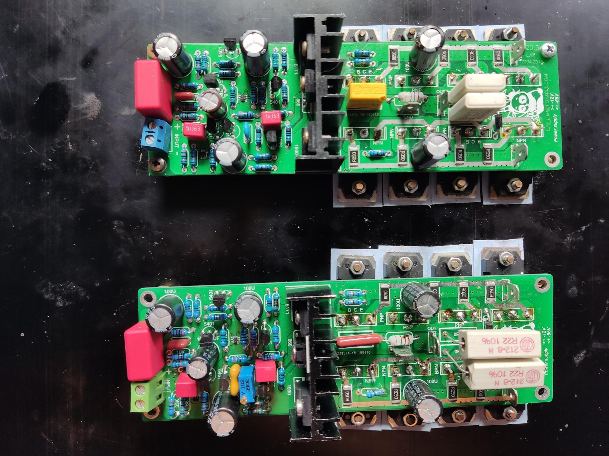

Hello friends,
Meanwhile, I have spoken to Billy and I must say, this was a fruitful exchange. He has explained me the nature of the problem and possible solutions.
Now, please, refer to the schematic in post #3.
To repair the damaged board or improve its reliability, you have to:
1. Replace R13 and R20 with higher resistance
2. Replace the yellow 104 capacitor with something better.
I have successfully recovered one of the boards by replacing resistors with what I had available: quality 0R22/7W and much better 104 capacitor.
I have also re-soldered and tested all output transistors. One transistor was damaged and one 01R resistor has shown megaohm resistance.
I have tested the bord on dummy load at low wattage and it works now.
The lesson learned: something causes sudden high current inrush into the output stage and it usually damages one half of the output. The result is extremely high voltage at the output, almost the value of the rail.
I suggest cautious evaluation of the board before connecting it to the speakers because this kind of failure would most probably destroy your speakers.
I have also tried to repair yet another board but this time I couldn’t apply the same cure. Measurements at the bases of the output transistors indicate that the signal doesn’t reach the output stage, indicating that the problem must have been somewhere in the previous stages. I might get back to this problem later on.
Below you may observe at the snapshot below one board without modification and the other after the repair. All credit for the presented method go to Billy, I just followed his instructions.
