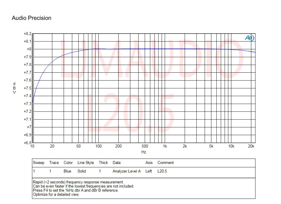

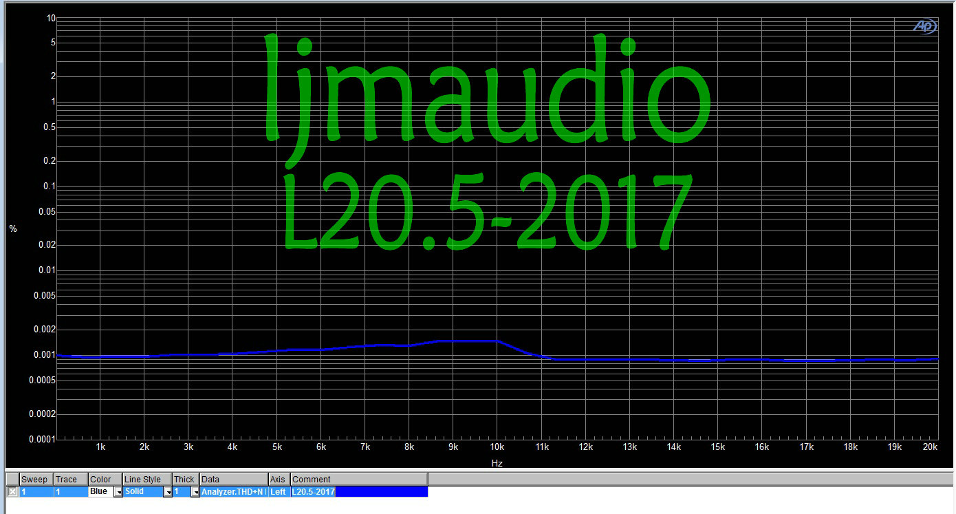

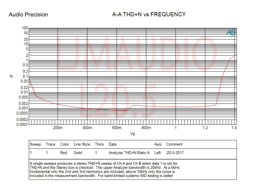

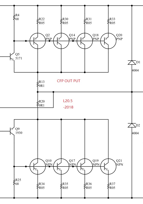

It's very low distortion. The main reason is because it uses a CFP output structure.
CFP can refer to DOUGLAS SELF.
Can be applied to other general circuit structure. But note that CFP is easy to self oscillation.
To ensure the stability of the instrument for measuring strictly.
Because CFP almost no crossover distortion, so L20.5 very low quiescent current. No heat.
But it's smaller than CLASS A amplifier distortion.
The distortion of 50 watts is about 0.001-0.002%.

Hi, LJM! What is the best quiescent current for this amplifier? Earlier you wrote about 20 mA. But hou do you measure it? Is it collector current common for four pairs of output transistors or is it emitter current of each transistor?
hello
About the static current. I think 1-50 ma don't have too big effect.
The SELF is introduced in the book. Not suitable for large static current.
Because it can increase the distortion.
But I found in practical measurement, the influence of the static current did not too big.
Whether it is a 0 or 100 ma. There is almost no difference.
So I set about 20 ma. Is about 3 * 8 = 24 ma ma
May have some different actually. Even different temperatures will have some changes.
But in fact will not bring any influence.
I think my test is also suitable for other amplifier.
Of course L20.5 adopted CFP output. It of the distortion, voltage is the smallest.

frequency response 20-25 Khz -0.15 DB 20 Khz-0.05 DB 10 Hz -0.7 DB
AP TEST (8Ω)1-50 W
THD+N 50 HZ 10 W(9 Vrms) <0.0007
THD+N 1 Khz 10 W(9 Vrms) <0.001
THD+N 10 Khz&20 Khz 10 W(9 Vrms) <0.0008
THD+N 50 W(20 V rms) 1 Khz <0.0015

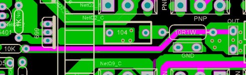

Unfortunately, the seller himself demostrated a very wrong way to use AP.. which led to the master design error and insisted on the wrong AP test method, we have different views, so we could not communicate with each other, fortunately, my friend is an experienced university professor who is very interested in this product and makes a simple MODification (feedback) I'll show you how to MOD the motherboard later.
index.php
Don't change anything.
There is no point in doing so.
It's just a wire. From top to bottom. There is no difference.
There are many people who think they will be better. As your neighbor told you, he found that chicken legs were delicious.
Take a look at the feedback from L20.5. It's very direct. Effective.
And it's almost the same as in the photo.
This change is like writing a word on it. Then tell you. Performance has improved.
I don't think it's necessary to waste time here.
There was no change at all.
