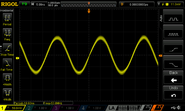

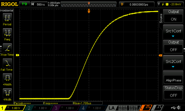

The problem is, that this board in its original, unchanged form oscillates at ridiculously high frequency. Look at the attached snapshot: almost +-100mV peak-to-peak 53MHz oscillation takes place behind the scenes, inaudible, but real and persistent. To solve this problem you should increase the quiescent current to shift the operation conditions of the devices into adequate region where crossover distortion and oscillations literally vanish. The board stabilizes and prevents oscillations caused by other events.

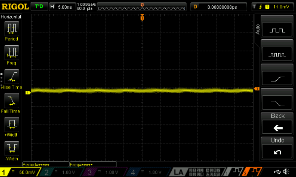

In the 2nd snapshot I have captured the same situation except the adjustment of the quiescent current to optimal value.
But anyways this board is prone to oscillation and other irregularities may drive it into wild oscillations and to self-destruction. The final solution to these unpredictable risks is to replace all components with reputable products.

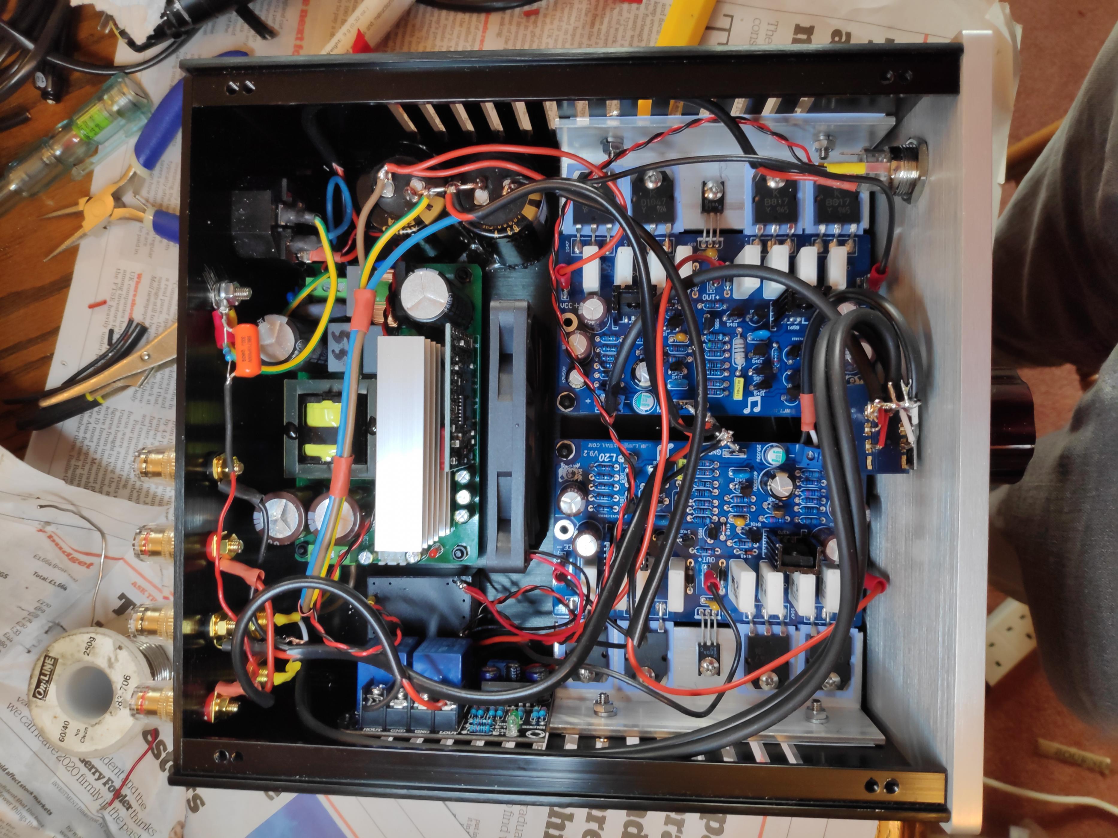

I have just remembered that I bought a cheap pocket scope from Banggood some time ago and hauled it out. (ADS5012H). It seems to go up to 6nS sweep time. No sign of oscillation (phew!) and I also have an old RCA audio test disk that I digitised - no sign of crossover at all even at 100mV - 1V output. I have attached a photo of the general layout though it doesn't show the extra resistor as that was a bit later.

I have posted up a photo but it hasn't appeared yet - moderator I guess. I like the amp as although my Icon valve amp looks very pretty with chrome and large glowing bottles, the power is a little limited and the sound a little soft - as all valve amps seem to have. The LJMs have great reserves and attack.

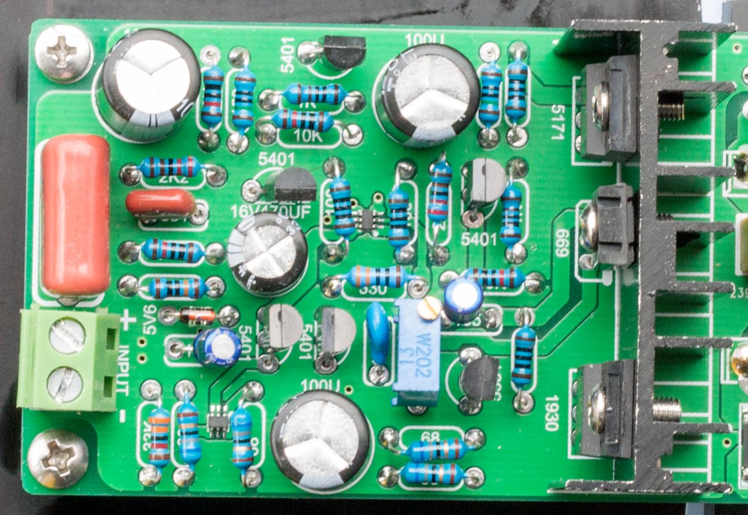

1. First look at the attached snapshot of the board. Note that the 1K resistor is replaced with 2K 25 turns potentiometer.
2. Bend the wiper lead and solder it to one of the remaining pins.
3. Adjust the trimmer to exactly 1KOhm. This is very important - do not be sloppy here: exactly one kiloOhm.
4. Solder the potentiometer to the board.
5. Fix the board on the heat sink.

10. a With oscilloscope
With the use of oscilloscope adjustment is much easier because you can see when distortion of the response to square wave ceases to exist. First stretch the rise line of the square wave to the width of almost entire screen. Initially there is a bulge, concavity which gradually fades with the increase of bias and then vanishes and turns the response into a smooth, convex line.

Just slight crossover distortion is visible at 953 ohm (17,62mV). See the attached snapshot 1.
At 910 ohm, there is no distortion and no oscillation. Snapshot 2.
At 900 ohm (non-existent standard fixed resistor) there is no distortion too, so going lower than 910 ohm or higher than 22 mV is pointless.

Yet, it is never too late to have fun and I guess you have lots of fun with building these midgets. There is a way you can improve reliability of your boards. Bare PCB is fine but I suspect low reliability of the on-board components in the "finished" product. Given the inherent instability and lower quality of components it is conceivable that, sooner or later, circumstances may randomly cause self-destruction of the amplifier. There are many reports that support this line of reasoning. By the way, aren't exactly you who proves this rule in the best possible way: ten times in a row. I understand 'Third time's a Charm' but ten times? It is no coincidence, it is a great deal of certainty. Such as it is, this amplifier boards are sounding great but just waiting to go in flames, or in smoke. 😱
Therefore I have ordered a kit and populated just one board with the "original" parts from the kit. Now as I have learned glitches of this board I plan to order real components from the reputable source and re-vamp the amplifier because I plan to use it in a tri-amping LJM system: l20, L12, MX59SE.
Perhaps others would like to do so. Below is a photo of the board from a DIY kit. (The photo is in high resolution, taken with quality camera. If you enlarge it you may see all details.) You may see that just surface mounting components are soldered. The rest is easy. 😎
