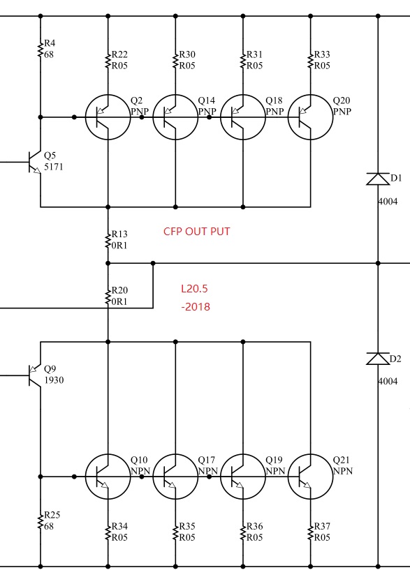

Finally, let me explain what should be measured to establish the quiescent current.
First look at the schematics below, it is published in the post #3 of the present thread, by LJM himself.
Now observe that all currents from Q5, Q2, Q14, Q18 and Q20 flow into the resistor R13. This simply means that the quiescent current goes through the R13. When you measure potential drop over R13, you have just to apply Ohms law to establish the quiescent current. However, for practical reasons, voltage drop is more convenient value .

Meanwhile, I’ve spoken to Billy and he came with a good idea, he asked: can we just replace the 1K resistor with a fixed through-the hole resistor instead of meddling with that all complicated stuff?
The answer is yes: simply replace the 1K resistor with 910 Ohm resistor and that’s all. But wait before you start soldering, there’s more to that.
I have measured at 910, 953, 976 and 1000 ohm which are standard resistor values. I have measured also at 900ohm to see what happens then.
Here are the results:
900 ohm->25,94 mV
910 ohm->22,40 mV
953 ohm->17,62 mV
976 ohm->17,3 mV
1000 ohm->17,24 mV
Voltage was measured between the »OUT« connector and the collector of any of power transistors (middle pin).
Just slight crossover distortion is visible at 953 ohm (17,62mV). See the attached snapshot 1.
At 910 ohm, there is no distortion and no oscillation. Snapshot 2.
At 900 ohm (non-existent standard fixed resistor) there is no distortion too, so going lower than 910 ohm or higher than 22 mV is pointless.
However, I would suggest first to try 953 Ohms and compare the result with my measurements. Characteristics of particular devices may differ and the results may be different from mine too. Choose the resistor which results in slightly more than 22 mV.
I hope this is easier way. But be careful.
