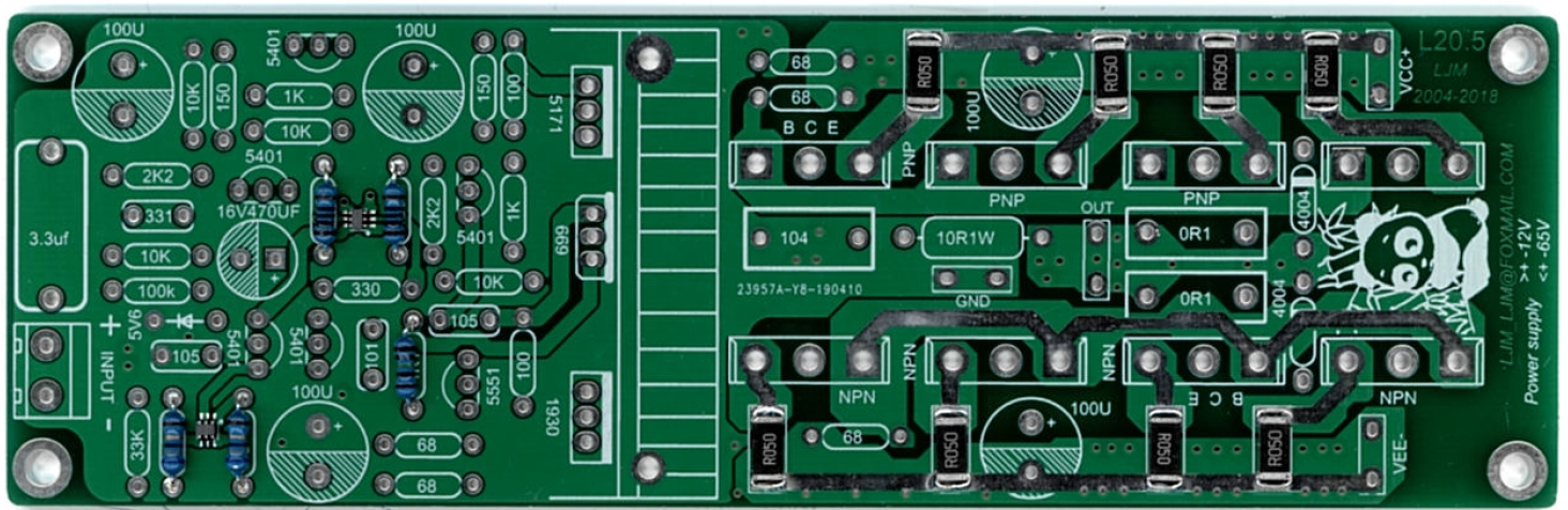

Now, please, refer to the schematic in post #3.
To repair the damaged board or improve its reliability, you have to:
1. Replace R13 and R20 with higher resistance
2. Replace the yellow 104 capacitor with something better.
I have successfully recovered one of the boards by replacing resistors with what I had available: quality 0R22/7W and much better 104 capacitor.
I have also re-soldered and tested all output transistors. One transistor was damaged and one 01R resistor has shown megaohm resistance.
I have tested the bord on dummy load at low wattage and it works now.
The lesson learned: something causes sudden high current inrush into the output stage and it usually damages one half of the output. The result is extremely high voltage at the output, almost the value of the rail.
I suggest cautious evaluation of the board before connecting it to the speakers because this kind of failure would most probably destroy your speakers.

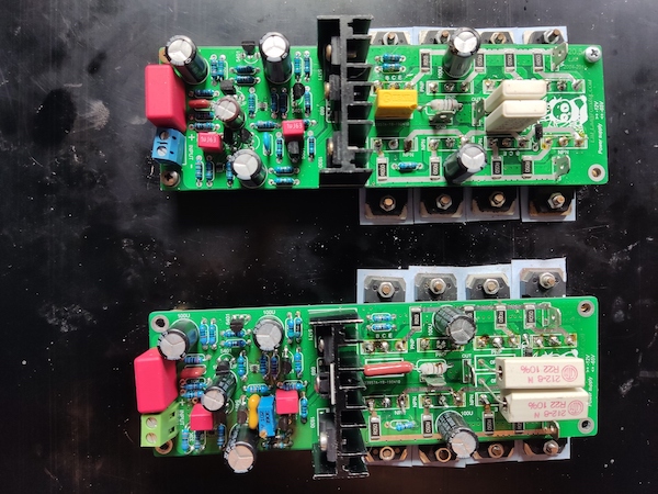

I have also tried to repair yet another board but this time I couldn’t apply the same cure. Measurements at the bases of the output transistors indicate that the signal doesn’t reach the output stage, indicating that the problem must have been somewhere in the previous stages. I might get back to this problem later on.
Below you may observe at the snapshot below one board without modification and the other after the repair. All credit for the presented method go to Billy, I just followed his instructions.

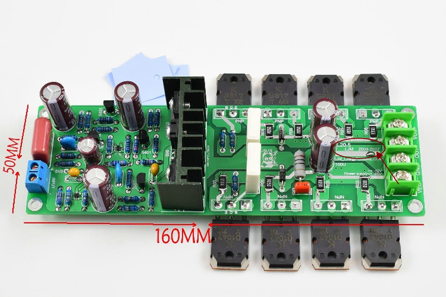

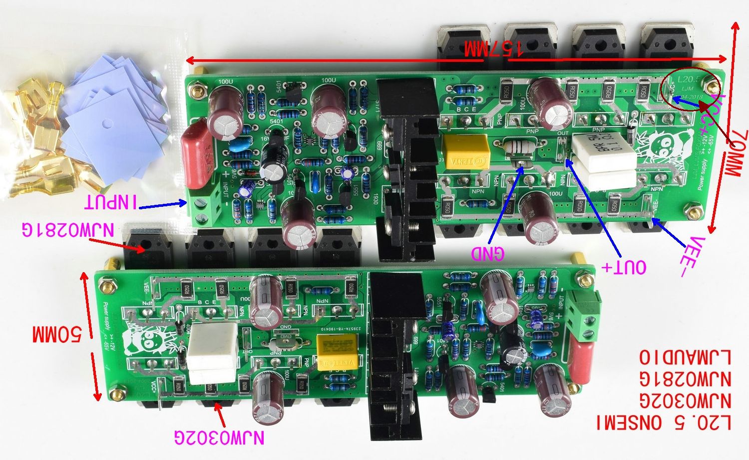

The biggest problem is actually getting the later boards they have been available for about a year but even when sellers show the newer board in the ad they aren't guaranteed to send the new board I have purchsed what I thought were the new boards and despite the pictures in the ad showing the later boards it has always been the older boards they have sent. These sellers clearly have a lot of older boards and will do anything to sell them so be careful and ask for a picture of the actual product you will be receiving.
What are the differences between the old and new boards?
How can you tell the difference?
Thank you,
David
Hi David,
The new boards are easy to spot due to all the power connectors being all at one end of the board. I will put a picture up as soon as I get settled in I have just got back from another couple of weeks in hospital and need a bit of time to sort things out. I should have the picture up by tomorrow.

Hi David,
That is the old one - you won't mistake the new one when you see it there are pictures on ebay. Just type in L20.5 amplifier and it should show up.
