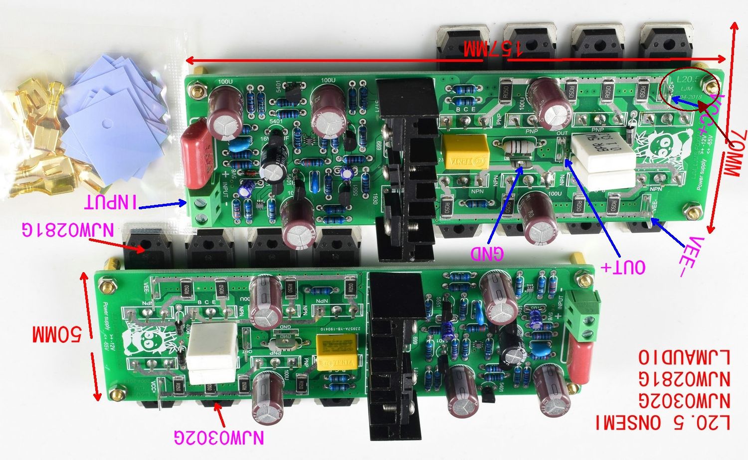

Thanks Kozard!
I used ONSEMI NJW0302G/NJW0281, they came with the boards. I also have boards with the KEC transistors but l was getting impatient at the time.

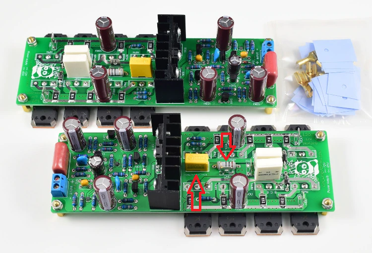

Are you sure?

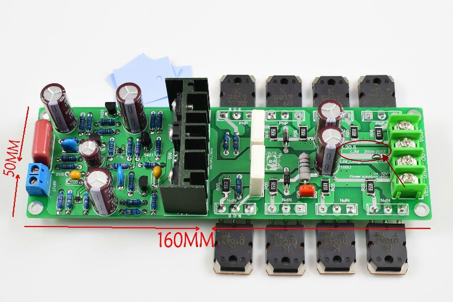

The ones with the connectors on the end of a (c) date of 2017
and the ones with the connectors in the middle of the board have a (c) date of 2018
did you ever get confirmation that the older dated boards (2017) are technically the newer ones?
i'm not entirely sure which are which now
i know @billyfish010 is saying that the 2017s are, but never saw any further confirmation
of if there are 'in between boards' what other identifiers can we use
i have a 2018 board with the speaker connections in the middle, and the power connections at the end, just hooked it all up and my power supply went 'poof' (yay)
... just hooked it all up and my power supply went 'poof' (yay)

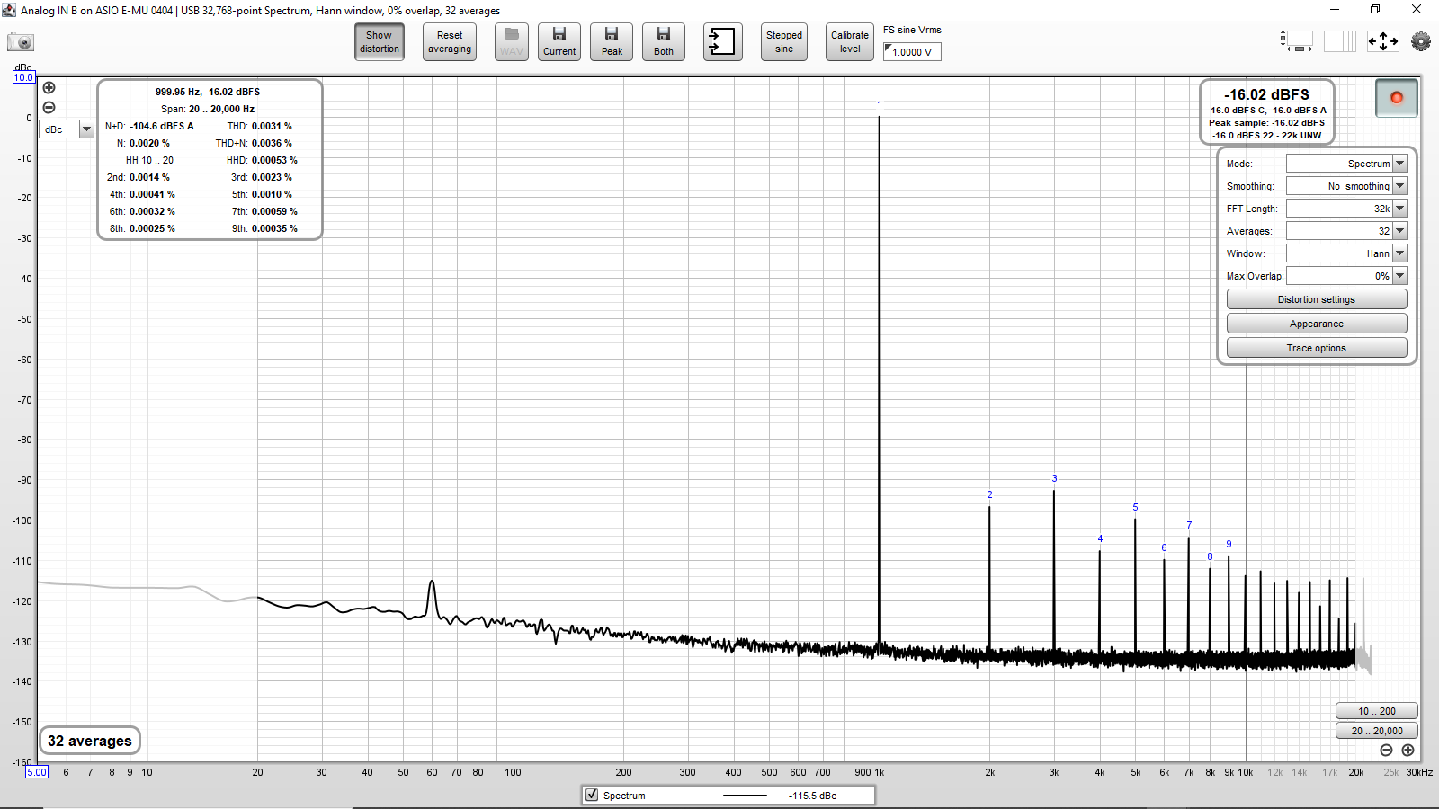

Attached is the distortion measurement from the surviving L20 V7 setup as a monoblock at 64W. (V7 is CFP output like the L20.5)
It sounds very nice. I am listening to the left channel through the L20 V7 monoblock but the right channel is a uPC1342V monoblock since the outputs blew on the second L20 V7. I think the other L20 V7 can be fixed. After removing all output transistors it can "power up" so to speak with the normal output offset voltage that it had before. (With no outputs and obviously no load.)
Next I will try to fix one of the L20.5 and see how that measures. I sure hope I don't have problems with those SMD...

i see a lot of the l20.5 boards lately are coming with the NJW0302G/NJW0281 transistors, do you have a link to the seller you used?
