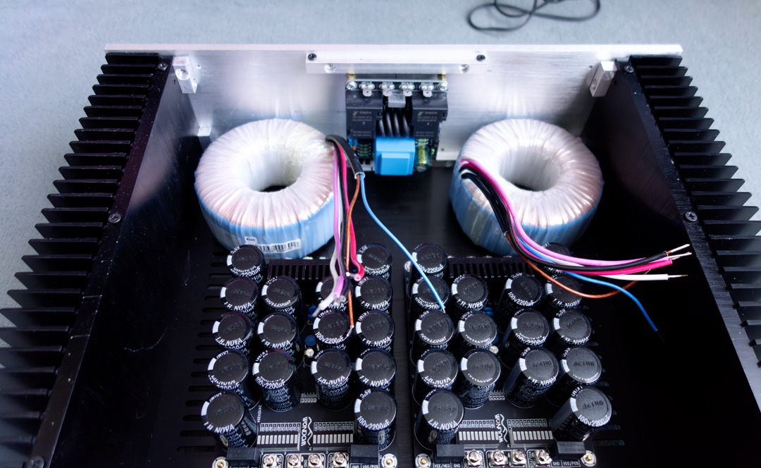

Two pictures of the box with the transfo, PSU and soft start before wiring. The PCB is now designed with Kicad and I wait for the components to send the process file to the manufacturer.

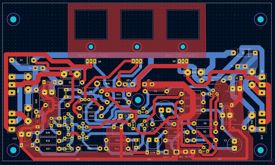

The PCB in Kicad (without mask layers) for larger components and heat sinks.

Great work I must say. Have you thought about possible group buy when you finish this project.

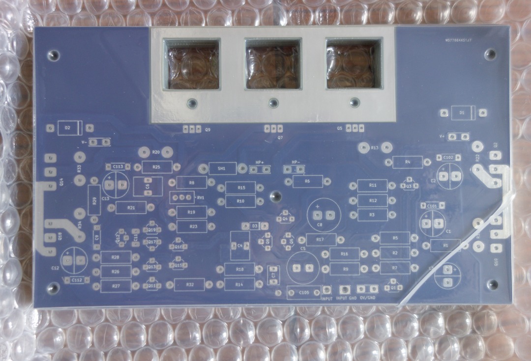

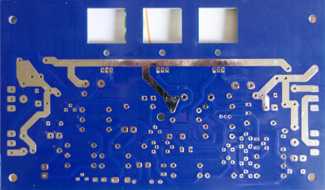

My PCBs (4Oz) come from PCBWAY...
Now I'm ready to solder the componants.

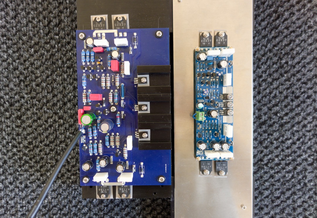

4oz PCB, larger tracks, larger space for 1 w resistors and better capacitors. So not the same PCB...
In addition to the resulting large areas of power circuits, I consider the main mistake to be the change in the location of the three transistors. The transistor - current sensor should be on the same cooling plate with two drivers and be as close to them as possible in order to more accurately read the temperature. And you made this worse with your board compared to the LJM board.
