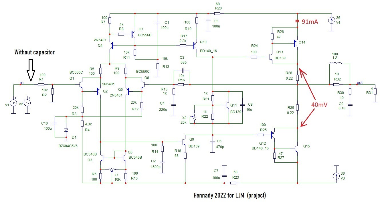

Oh, I think I found it. It looks like your development, Gennady. Project.jpg And it looks like this scheme has been simplified at all... Project-3A-ldsound.ru-1.png

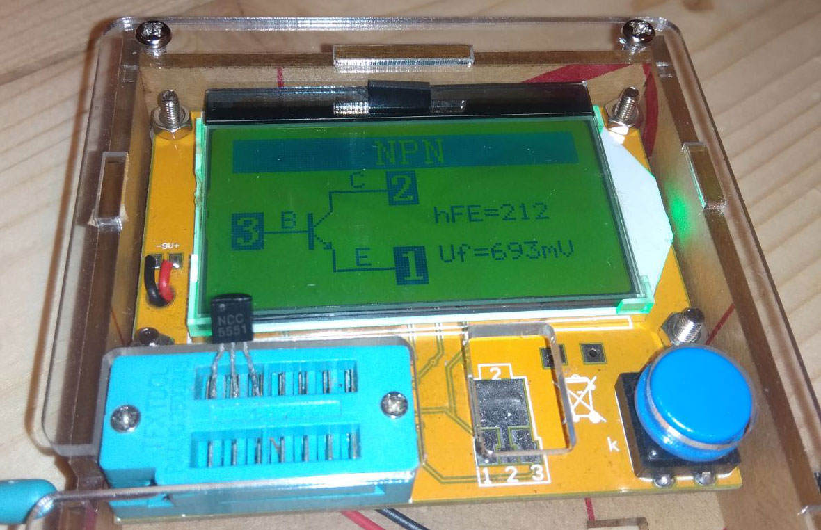

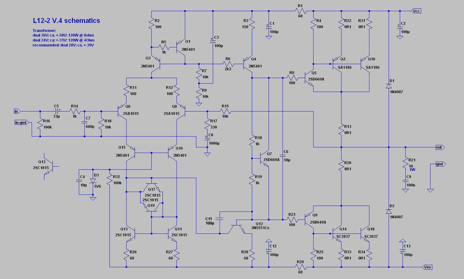

I decided to create a voltage map of the amplifier. I used the scheme from the Calvin website. Many thanks to Calvin!
I noticed one discrepancy with the scheme on my boards. Transistor Q12 is connected differently. On my boards, the base of the transistor Q12 is connected to the resistor R19, and the collector to the base of the transistor Q17. I made a change in the circuit.
Maybe I was too hasty.
"It turned out that for 2N5551 there are different schemes of arrangement of contacts. Chinese KEC is different from all others, such as Fairchild, OnSemi, etc. EB CE CB standard."
I will need to remove the Q12 transistor from the board and check the contacts.

I removed the transistor and checked the location of the contacts.
The location of the contacts differs from the standard European one. Now it is clear where the L12-2 amplifier circuit with an incorrect Q12 connection came from on the Internet.

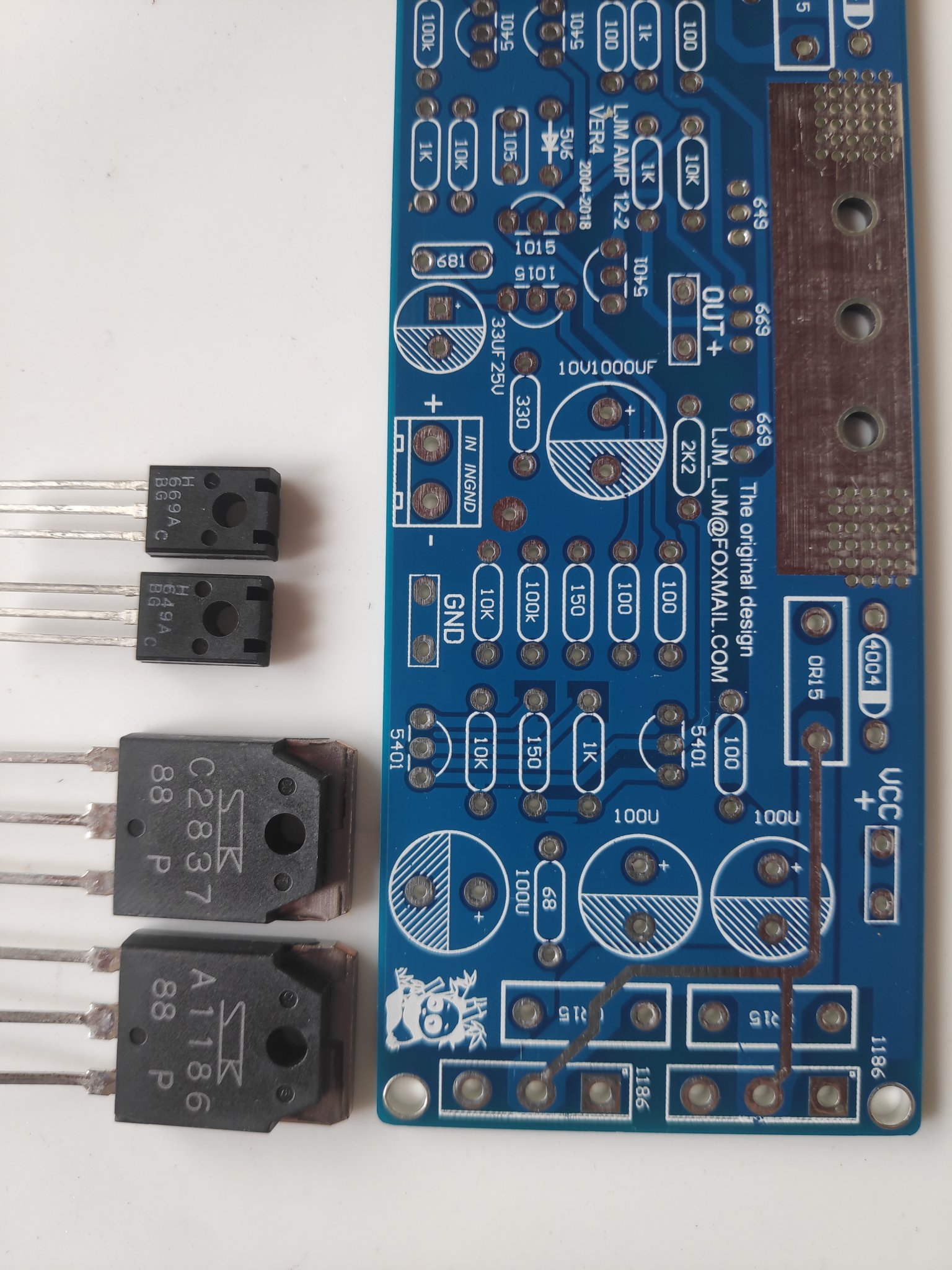

I bought this kit from ebay a long time ago, and cannot remember the seller. I have been having second thoughts about assembling it because I'm not sure if the BJTs are genuine.
Your input is appreciated.
This pcb looks like the one designed by ljm ljm version 4. Be careful with the power transistors (theirs back faces are linked to the collector).
