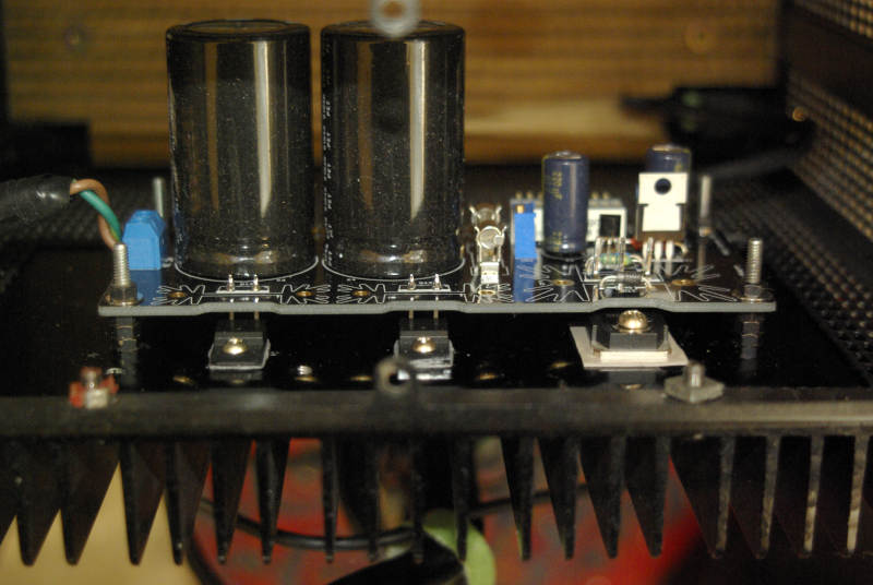

I have recently changed from 12v trafo to a 9v for my 5v L Ad powering Rpi 3b. I found the sink on Q2 was getting quite hot with the 12v...touchable but definitely very warm. Still warm with 9v but I am happier!
I thought that might be the case.
I am planning to mill a full "cover" for the PCB (and populated parts, obviously) out of aluminium so that it looks like a single block. Q2 would be attached to the cover (and the PCB upside-down) so that the entire cover acts like a heatsink.
Heat management should not be that big of an issue - but still want to make sure the PSU operates optimally.

I have on hand an encapsulated, double shielded 2 x 12V @ 50VA toroidal transformer. I understand that within the guide you recommend 9V transformers for a 5V (well, 5.1V output) - but is there any chance to use this transformer?
My initial plan is to have 2 PSU's built in the same enclosure with the same transformer - one for the RPi4, the other for an optional USB isolator if the need arises.
I'd like to be able to use this transformer, especially since getting a new one will delay the build significantly, but do not want to compromise on the PSU.
Any thoughts? Thanks!
It is quite likely that you may need to upgrade the heatsinks for dissipating the increased heat; in your case it may be a better solution to use your choice of transformer (it seems to be a quality one) and larger heatsinks if the enclosure you have in mind allows it.

Yes, a large heatsink with devices insulated will work fine..

Much appreciated all. Once I have the boards in hand, will post here a CAD of the "cover" which should act like a heatsink.
One more sanity check before I go ahead with milling, if you will.
Also, may be a stupid question - but are there any issues with mounting the boards, and with that, the PSU, upside down?

All the electrons are going to fall out! Naah no issues.

In all seriousness though, I was wondering about the fuse clip mostly - but I take it that should be just fine.
Now the only thing that remains is to locate 6,800uF capacitors which work well for the circuit according to recommendations (35V, 105 C), but are still shorter than (or equal to) 25mm (20mm would be ideal, but they don't seem to exist).
Trying to cram all this in a low profile case, but if all else fails, I will have the PSU cover stick through the top like the transformer does.
If it isn't going to be too hot inside the box 85C capacitors aren't an impossibility. Lifetime is stated in hours at nominal C. Rule of thumb is it doubles with each 10C less. A 1000h 85C cap is expected dry in 8000h at 55C for example.
Got it.
Vertical height is exactly 38mm. With, say, 6mm spacers and 2mm board height, I still have 30mm above the board, so I can go with 25mm capacitors (CDE makes some) and will mount the PCB the right way up.
This means no cover for the PSU, but I can mill a proper off-board heatsink for Q2. I may still go for board level heatsinks on the diodes, just to be on the safe side.
Proper ventilation on the top cover, of course.
Some of those CDE caps are small and might fit - or maybe mount the caps on their sides and glue to board.
