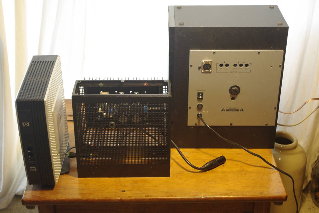

I have an idea to power my F6 amp at 2 x 1.7A/rail - by using the recent lt4320 fet bridge on the inputs (replacing the side diodes) and a bit of 'stuffing around, I can use 1 brd for +24v rail and the other brd for the -24 rail but each transistors will need to get rid of perhaps 25W per rail so locating the bigger heatsink is a problem
Is it possible to use longer wires (maybe 60mm) to mount the TO-247 pass transistor off board on a bigger heatsink without losing circuit performance?
Maybe not a no go because it initially worked on a breadboard with wires but for the printed board itself I never tried or seen extensions. The whole PCB can alternatively be mounted against a large heat-sink. Horizontally.

I have seen the "Smooth Like Butta" boards with quite long leads and surprisingly, it doesn't appear to create any problems but I'll try for the "pcb to heatsink" direct connection as designed first and maybe play around with variations later on.
The current Cap multiplier drops about 3 volts across the pass transistor so the L-Adapter is only about twice that (curiously, about the same as the AMB Sigma 22 regulator) - it'll be interesting to see what difference it makes ...

As Salas says devices can be mounted horizontally with insulation to a single large heatsink...I placed mine from below, marked, drilled and mounted then soldered them as the final step.
I am only using a single board for a 19.5v supply for a Thinclient and it runs fine.
