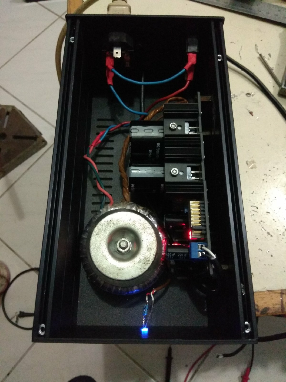

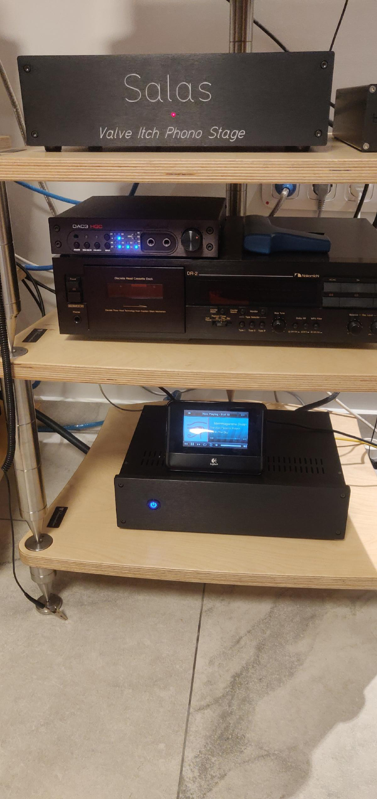

I built mine lately,in 5 volt version to power my Logitech Squeezebox touch.guys the difference with the stock smps psu is night and day.i can surely tell you that if you have a Squeezebox touch you have not heard it without L adapter.now,i can clearly hear my Benchmark dac3, through coaxial.salas bravo!
A few weeks ago a friend of mine brought me a bryston player,bdp2,and listened through Benchmark dac3.it was better than Logitech,but not far,now, with L adapter,my friend will cry his hardly earned Euros....the difference is huge!
Nice to know that it worked so good for your Squeezebox player + DAC3 system. I just use the Foobar controller app on my mobile phone, that's my "player". 😀

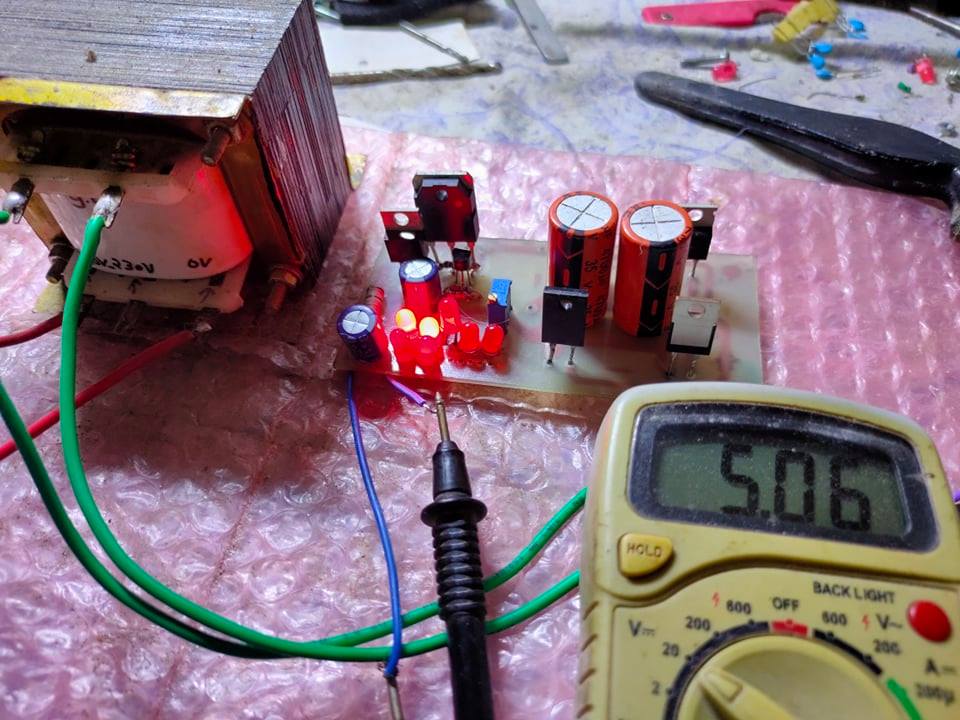

Hey Salas, many thanks for what is poised to be a great PSU option for the RPi4.
I have a few boards on the way, and as I am slowly gathering parts (I am having the PSU built by someone much more experienced than myself), a question:
I have on hand an encapsulated, double shielded 2 x 12V @ 50VA toroidal transformer. I understand that within the guide you recommend 9V transformers for a 5V (well, 5.1V output) - but is there any chance to use this transformer?
My initial plan is to have 2 PSU's built in the same enclosure with the same transformer - one for the RPi4, the other for an optional USB isolator if the need arises.
I'd like to be able to use this transformer, especially since getting a new one will delay the build significantly, but do not want to compromise on the PSU.
Any thoughts? Thanks!
