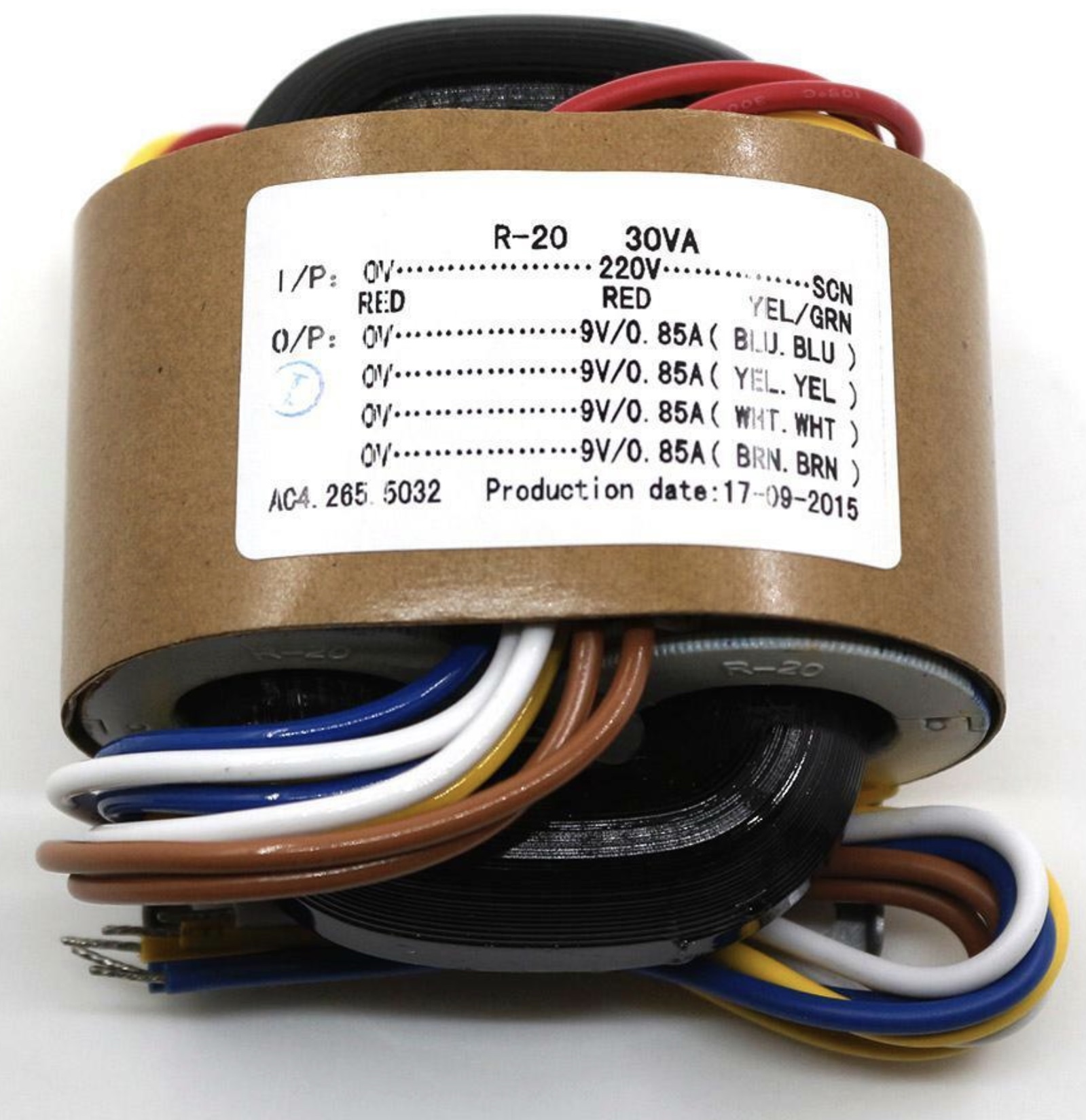

I'm hoping to build this for RPI4. I ordered an R-Core 9V at .855A x4 from Ebay.
That should be ok?

Better parallel two 9V secondaries on that R-Core. What VA power it states? 30? You may use 10000uF filter caps no problem. Yes, 30mm max diameter.

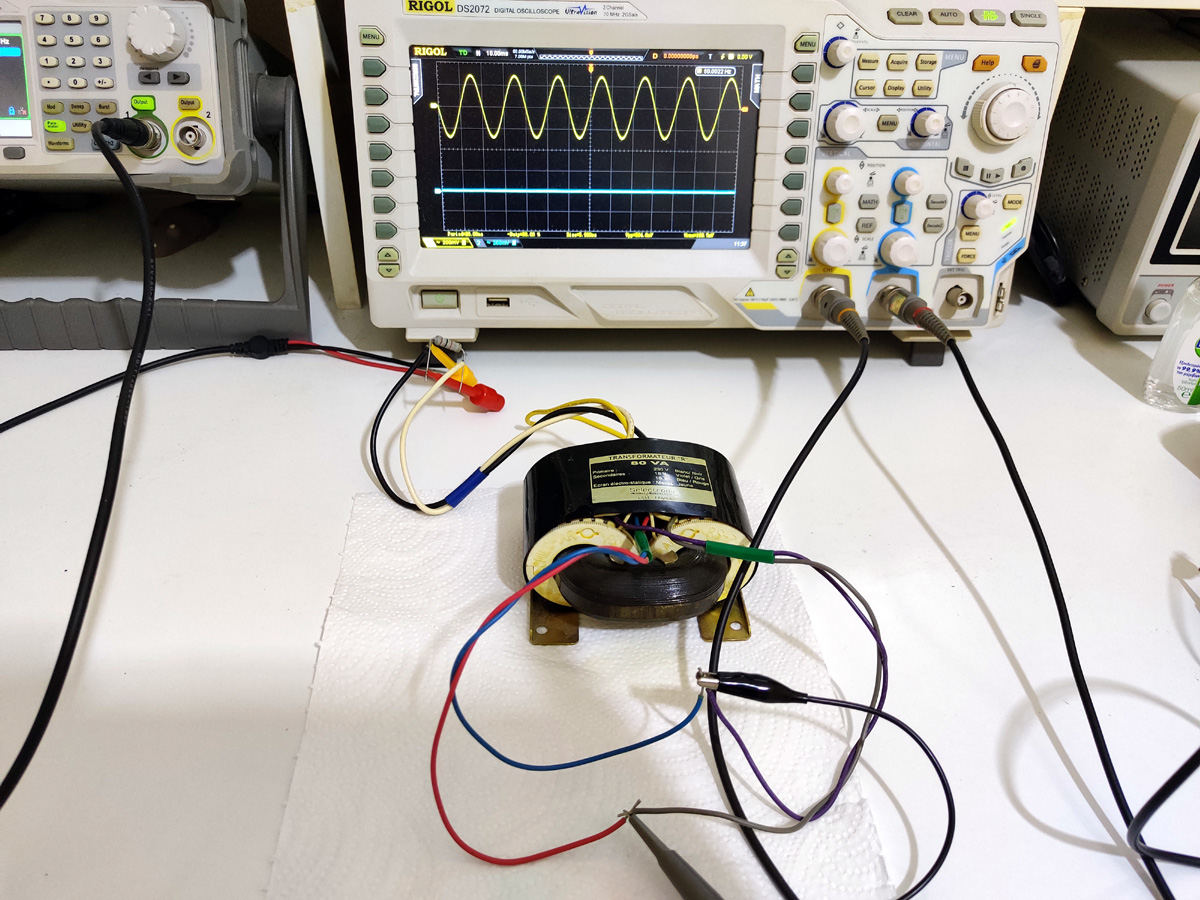

DVM will show no AC voltage when secondary instantaneous polarities are paralleled opposite. Over-current and heating will be happening already if testing with high energy i.e. with the primary on mains. Dim bulb tester is safest way to know paralleling is wrong in this case. Big glow tells you to reverse one secondary while current limiting opposes high current draw to happen. Dim Bulb Tester

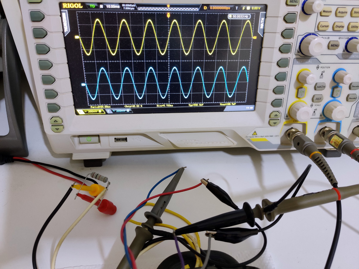

To know safely before hand with generator and scope, feed 2.3VRMS 50Hz via 1k series resistor to the primary*, probe the secondaries, one for each scope's channel. When sinewaves align on the screen you know each wire on a probe's nose is in phase. Put a dot on them with a marker pen. When paralleling secondaries connect dotted cables together and non dotted cables together.

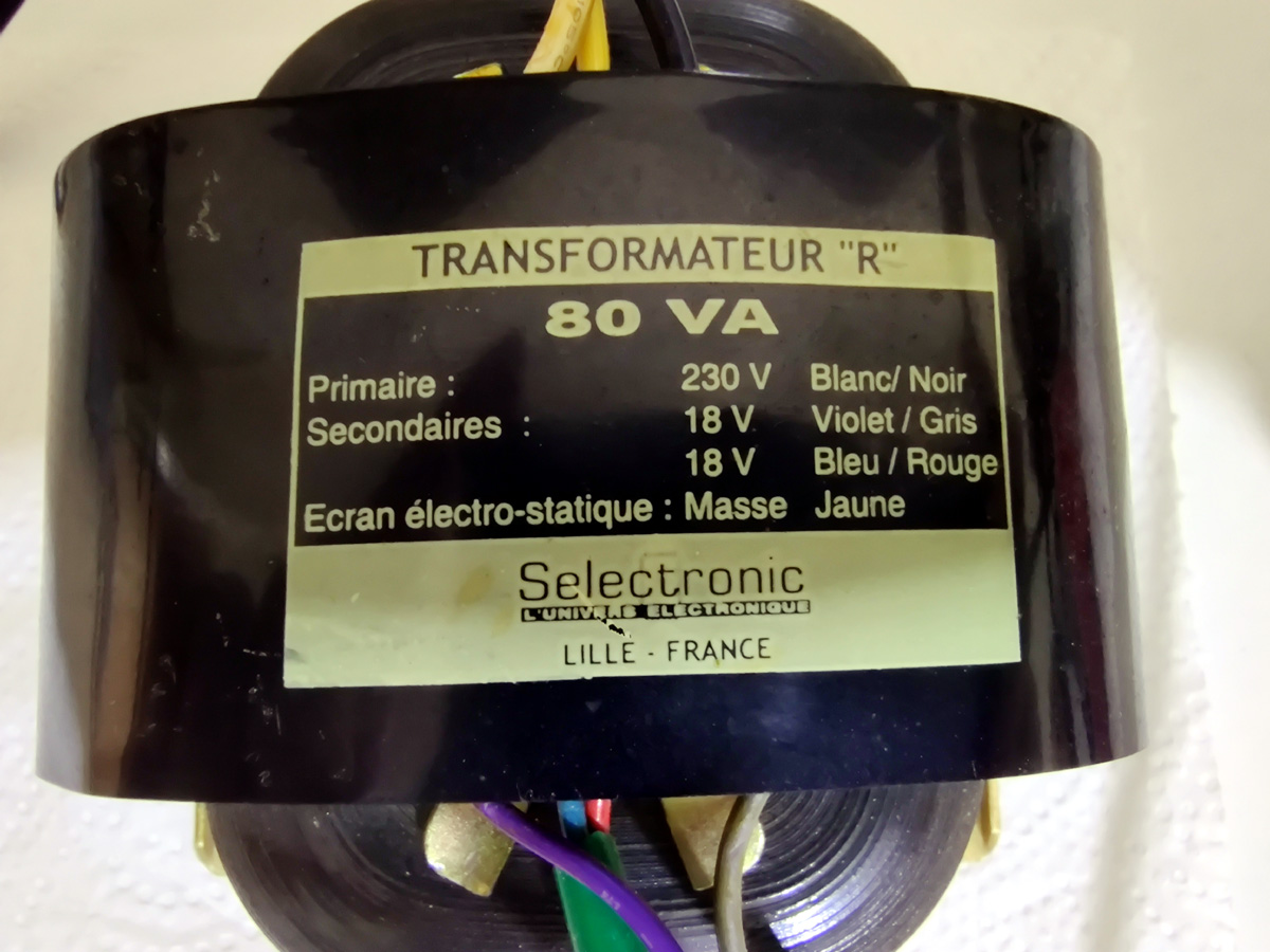

Example pictures from an R-Core of mine. Blue and violet proved in phase. Paralleled secondaries are the last picture. When I reversed wire colors mating, the yellow sinewave vanished and became a flat line. If colors were the same for each secondary pair I would have marked dots to distinguish.
