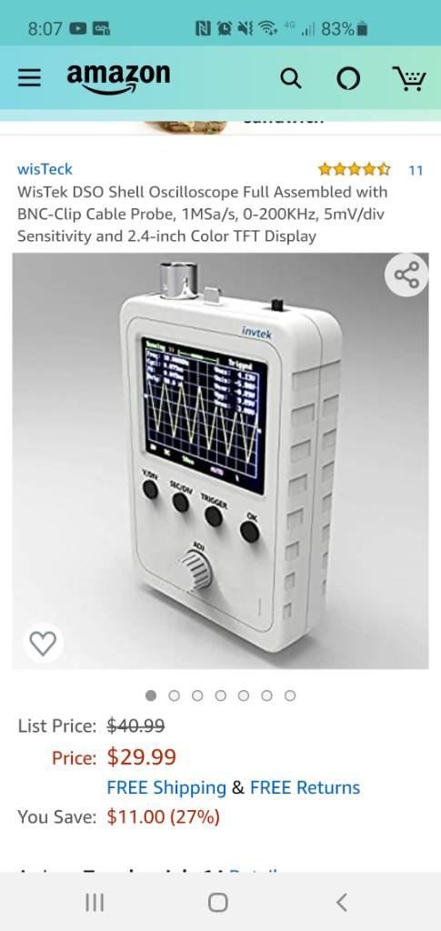

No its one channel only, you want to reliably compare secondaries phasing, so two channels at least.
And the generator is ok?No its one channel only, you want to reliably compare secondaries phasing, so two channels at least.
Theoretically yes but who knows it's voltage and frequency precision or stability or adherence to 50 Ohm Zo modern gens standard.
Easiest no bench gear idea I thought of is use a PC as generator with 10k in series to the primary for as much signal it can manage to give out at 50Hz/60Hz and see with the DVM in what way there is AC voltage on paralleled secondaries. Correctly phased should give a reading while when in opposite polarities they should cancel. But I haven't tried that, you guys tell me if helpful.
