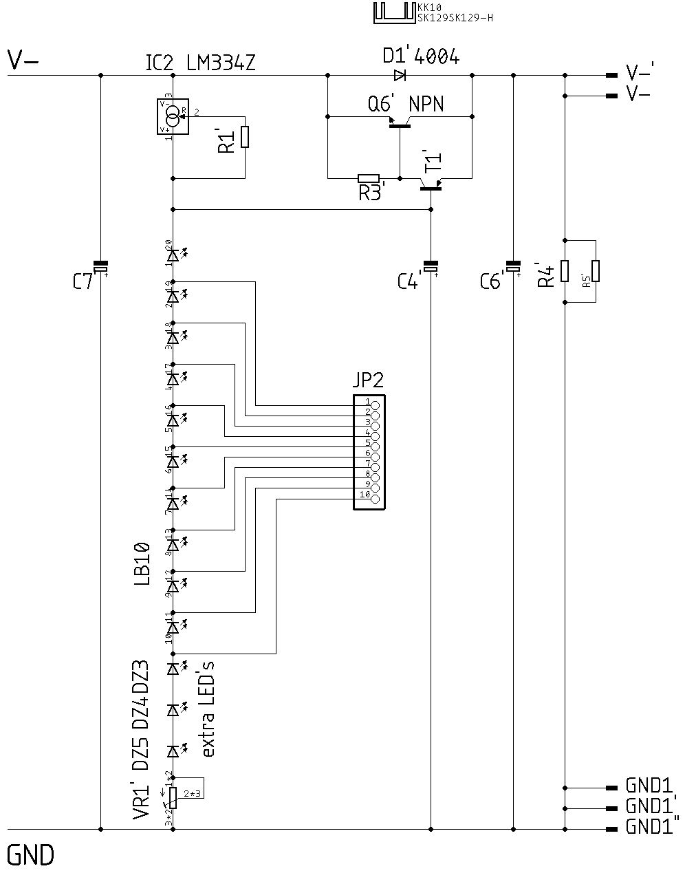

First thing that strikes me wrong in your schematic is the LM334's pin 2 should connect R1' to pin 3. Don't know about the rest. Without practical development, parts comparisons, electrical & subjective tests, I can't predict some equivalent spec compatible sounding negative.
But there is also another way. Two regular positive guaranteed identical L-Adapters can be connected up like batteries for dual polarity output with midpoint common. The official boards already have independent own bridge rectifiers and reservoir capacitors. They would also need dual independent AC secondaries for dual polarity setup. Not necessarily dual independent transformers.
Thank you Salas,
I will have a relook into the design, probably drop the -ve rail idea.

Alright. Good luck and keep us posted.
