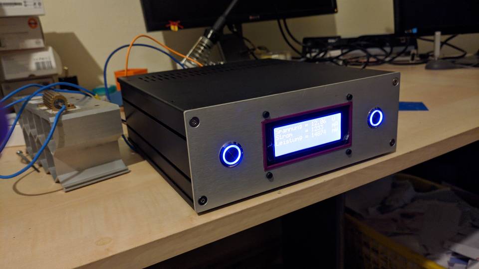

This was something to play for me... Im using an arduino nano with the INA219 voltage/current measurement System...Yes indeed
Spannung = tension
Strom = electricity (current)
Leistung = power
This I Think I have to change... Ina needs a common ground for the measurement...
