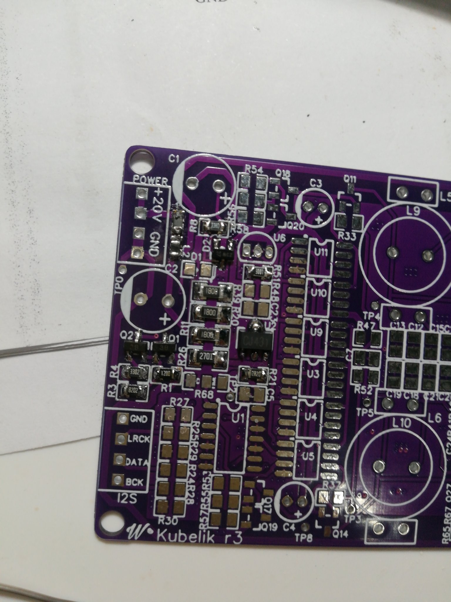

Regarding the yellow diode orientation.
the extra white marking on pcb nearer to the TL 431 correspond to the green marking of the yellow LED?

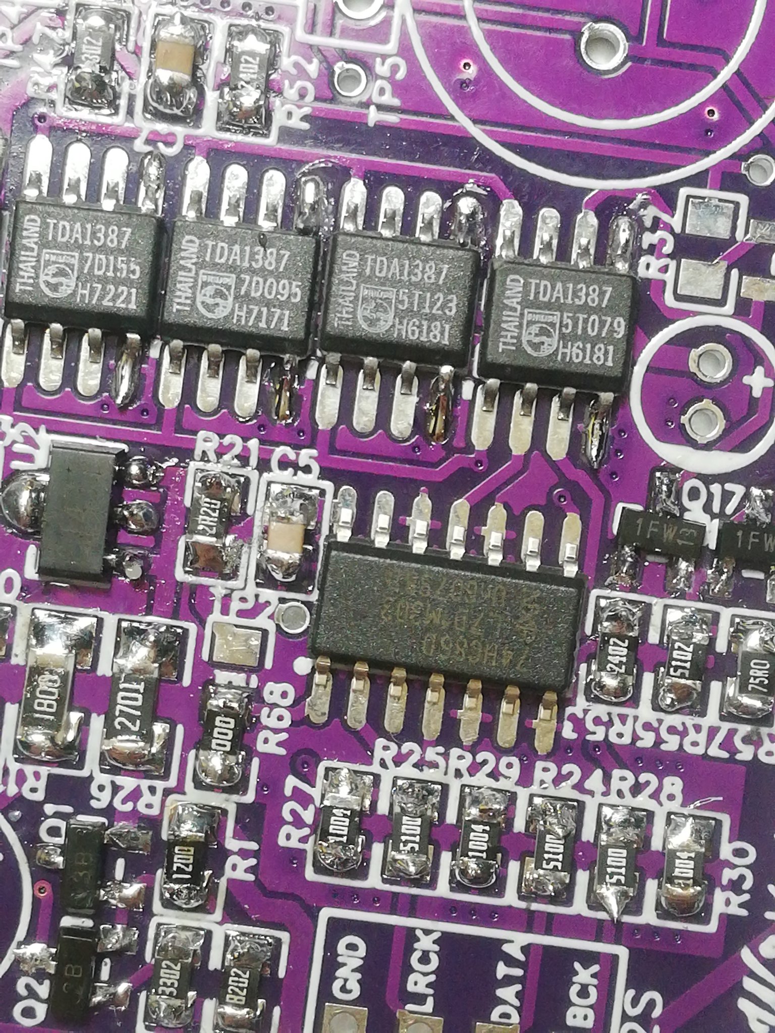

R68 is the phase selection - mount a 0R resistor to the left for non-inverting, to the right for inverting (180o phase). The LED has a small triangle underneath which points to the negative (to the right, towards TL431) and that's the green dot on the yellow LED.
After much delay, today I started assembling the Kubelik kit.
Step 1 completed, voltages measured OK, yellow LED lights 👍
