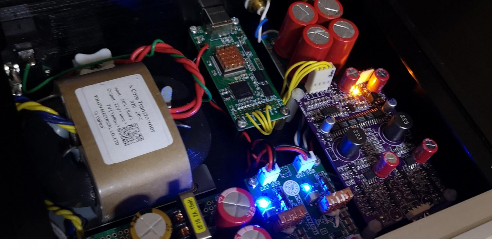

Finally completed the dac. There was a long delay due to the taobao seller sending me wrong parts of the chassis i ordered.
Interesting finding when i changed to Bourn inductors from the default one in the package. The inductors that came in the kit sounded more 'airy', the string notes has a 'hanging in the air' effect. The Bourn ones made things sound focused and warmer in the mids. I cannot decide which one i like.
The dac sounds amazingly good, does not sound nervous with complex music at all. In my opinion, sounded better than some cheap implementation of Chinese the ES9038pro dac.
Picture looks great! Fine job. I think the Bourns inductors may have a slightly different inductance which could account for some difference in the SQ. They're 5% whereas ours are normally better than 2%. But that's a bit of a longshot.
The lack of muddle in complex music is I think largely due to using a classA output stage with the opamps. In course of prototyping Kubelik I built one without those transistors and yes, the 'nervousness' appeared on orchestral music with lots going on.

Parts are perfectly organized and labeled. I started some of the soldering.. I'm checking capacitor values. Bag labelled 22ufd, capacitors measure 13ufd. Is that okay. This came up when I was about to install C2.
Good to hear they arrived eventually. Sometimes ePacket is frustratingly slow.
That capacitor is a 22uF X5R 0805 so its value is very voltage-sensitive. Meaning how you measure it will strongly affect the value indicated. The value isn't critical as its used for noise reduction from the TL431 DAC power supply.
