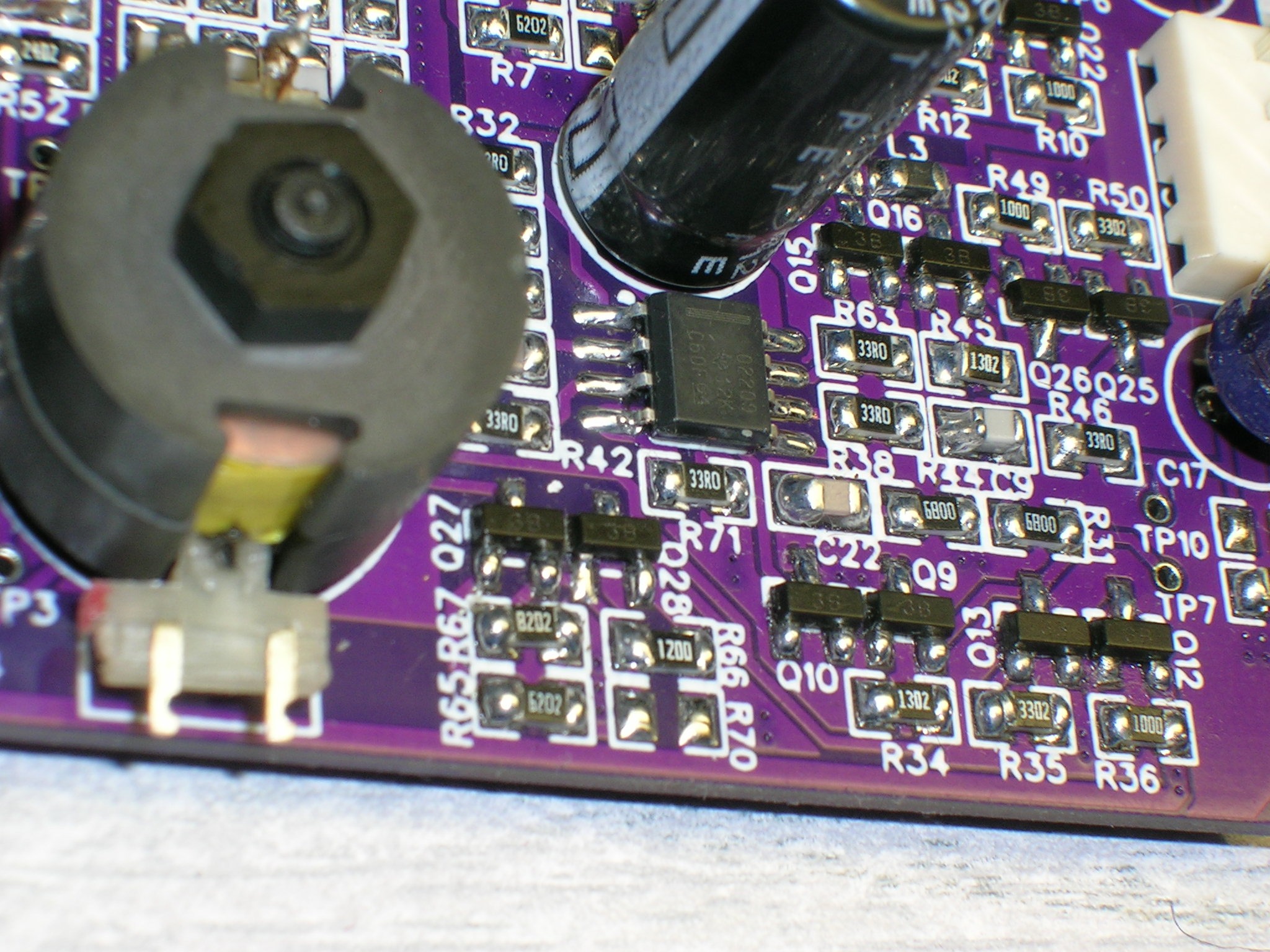

You can redo the soldering where necessary . Lightly brush the joints with soldering flux and then retouch the solder with the tip of your hot iron. Clean the tip after each touch.
George
George,
when l lift up the soldering iron, there is always a trail of pointed solder that l cannot eliminate.
How do you get a smooth surface ?

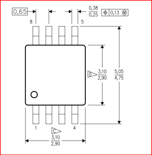

Orientation of OPA 2209.
I seek confirmation that the pin assignment follows the similar logic as 74 A HC 86D.
The line on the OPA2209 is near to the white marking of the pcb .

Quote: when l lift up the soldering iron, there is always a trail of pointed solder that l cannot eliminate.
Hmm, that sounds like to few flux to me, basicaly either what you use...or "too long on it" with the soldering iron so flux evaporates. Too long could mean either not hot enough and insisting, or fine temp but too long on it. All IMHO... SMD soldering, I just have a reasonable temp but that is hot enough that a small touch with the iron is suffisant to solder. I mean a few tenth of a sec or so 'never measured it though...
I was lucky not to experiment a lot with failures so possibly more experienced people here will advice best on your prob
Keep the good faith, the more you train, the better you will get, no reason not to... to get started again after many years I used a chinese 2$ smd training board, in fact two of them, just to get the touch and they had smalller and smaller resistors I would never have thought I could solder myself... and SMD is in fact more straightforward then it seems
The package you're showing above isn't the one used on Kubelik, its a smaller one maybe MSOP8 or similar.
SOIC8 OPA2209 has a bevel just like the other chips you've already soldered. The white line on the markings goes to the top and the text reads in the same direction as the 74HC86 and TDA1387.
On soldering, I reckon 250oC is probably too cool. My iron manufacturer recommends 345oC.
Re OPA 2209 orientation, pls see attached photo. Bevel and white line on the IC to face the white dot on the PCB.

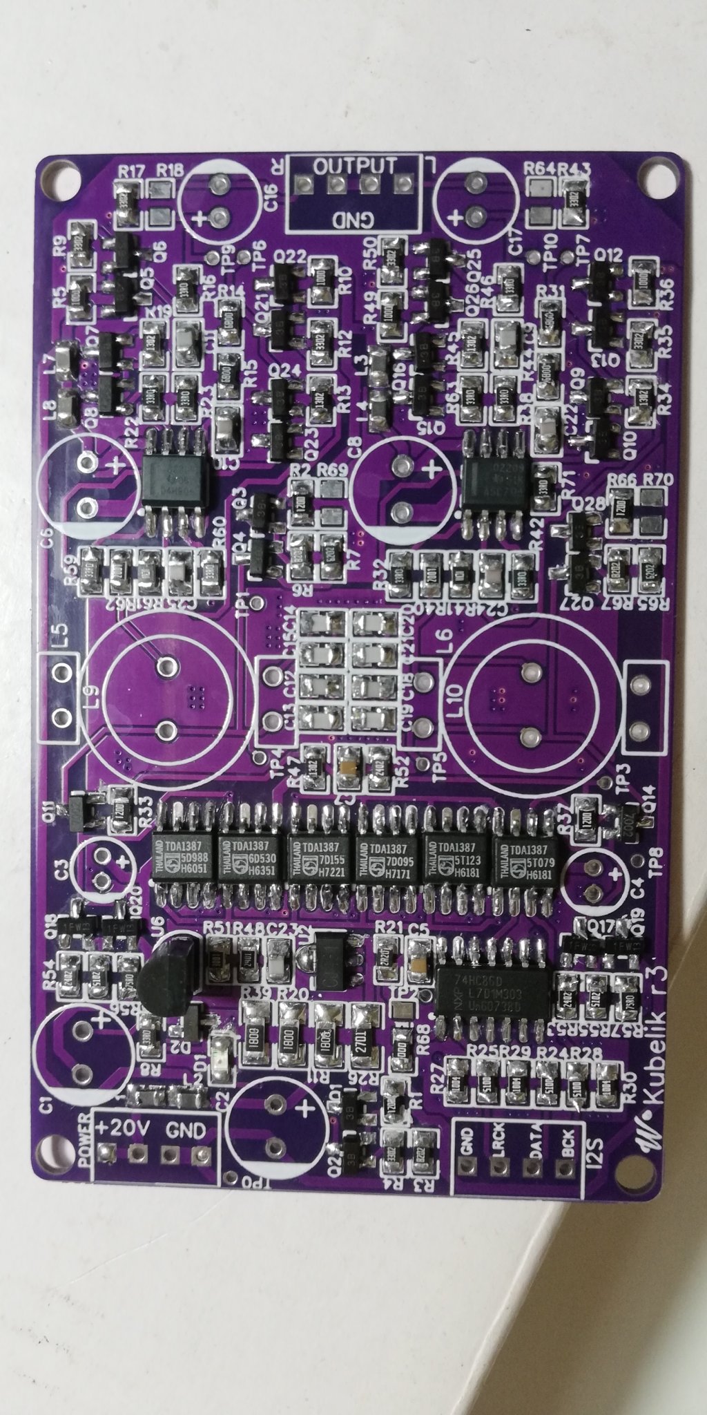

This are the TP measurements
TP 1 10.07v
TP2 2.499v
TP3. 2.904v
TP4.
TP5
TP6 10.08v
TP7. 10.08v
TP8. 4.479v
TP 9. 10.08v
TP10. 10.08v
Are these values acceptable?

At least on some places it could possibly benefit from a light touch up with the iron, to make it more even... at higher temp.
Not saying it won't work as it is...

They look fine to me, TP8 target voltage is 4.5V so your measured voltage is 0.5% low which is within the spec of the resistors used to set it (1%).
