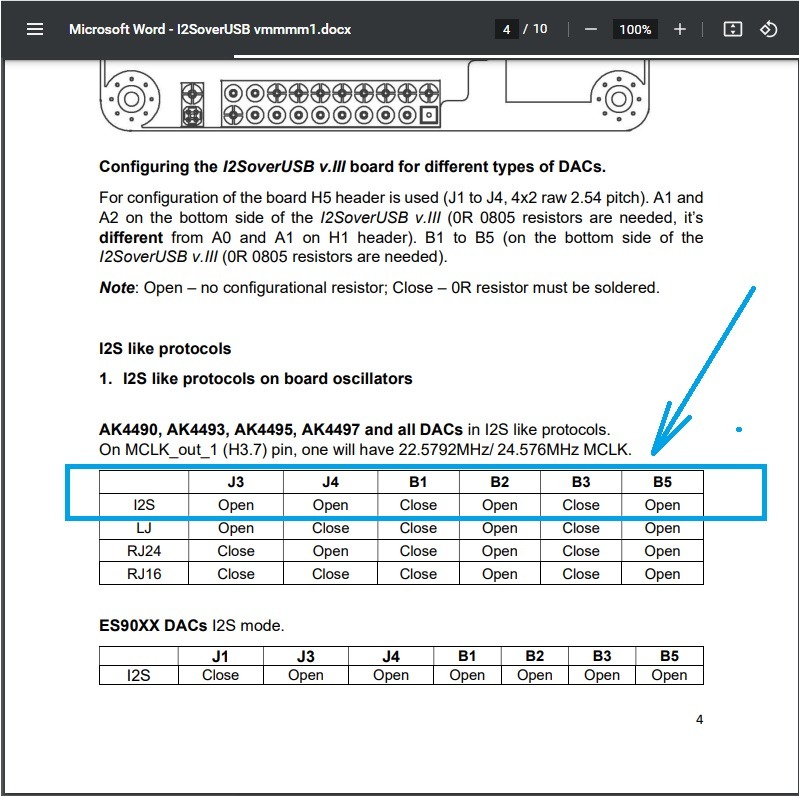

I took a look at the document and I see in the first group two settings for I2S that might be appropriate ('all DACs' and 'TDA1541'). The ES90XX setting is different. Without waveforms being shown I couldn't give confident guidance about which to choose.

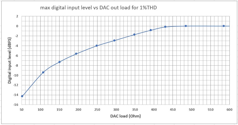

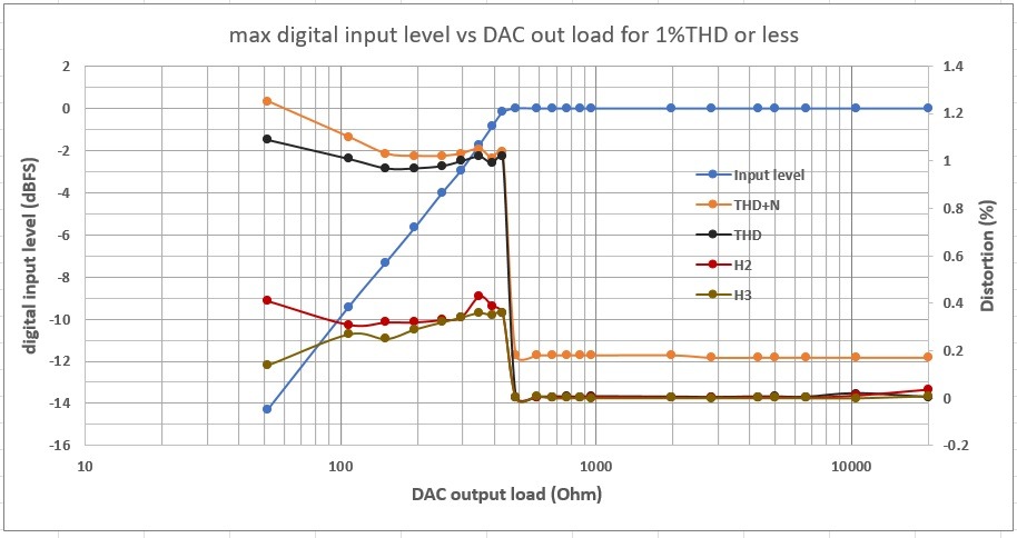

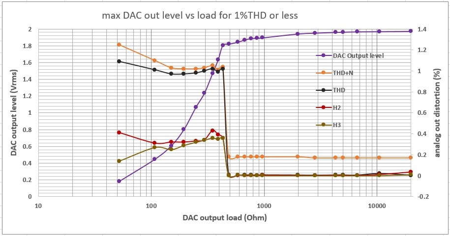

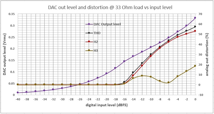

This DAC can drive loads above 500 Ohm without clipping, when fully driven (digital input level of 0dBFS). What is the impedance of your headphones?4. I cheated a bit when i said it sounds great. It sounds great at really low volume (on headphones), in reality it begins to clip hard at around 0.1v (so says the DMM). At 0.15v its already making just fart noises, like someone recording a rock performance in the first row from their phone.
Edit: Attached plots are for a 1kHz test signal
Please see last attachment and my post below:Now since nobody else mentioned this i am assuming i just messed up somewhere. I thought maybe its the JLsounds board, but works great in any other dac. In the configuration sheet, i just used the standard I2S protocol (as for example an ES90xx dac).

Yup, will try these other settings. You're right though, without a scope trace it is guesswork, but i appreciate it, in any case one of these should work (assuming it is just I2S error, probably it is).I took a look at the document and I see in the first group two settings for I2S that might be appropriate ('all DACs' and 'TDA1541'). The ES90XX setting is different. Without waveforms being shown I couldn't give confident guidance about which to choose.

Thanks for the info George, B1 and B3 it is (makes sense that it would be this really). Graphs are a nice bonus 🙂
Ah makes sense that you only got 0.1V into such a low impedance load. The output stage is current limited, you can get about 6mA in the positive direction. Which is nearly 200mV into 32R. I estimate you'll need to keep the digital attenuation above 23dB to avoid clipping. So the DAC effectively becomes about 12bit.You're right should have specified. Some 32 ohm (nominal) headphones. Worked fine with any other DAC or thing i plugged them in so i didn't think about it much.

Yeah, makes sense then. Will have to listen to it with something else 🙂Ah makes sense that you only got 0.1V into such a low impedance load. The output stage is current limited, you can get about 6mA in the positive direction. Which is nearly 200mV into 32R. I estimate you'll need to keep the digital attenuation above 23dB to avoid clipping. So the DAC effectively becomes about 12bit.
